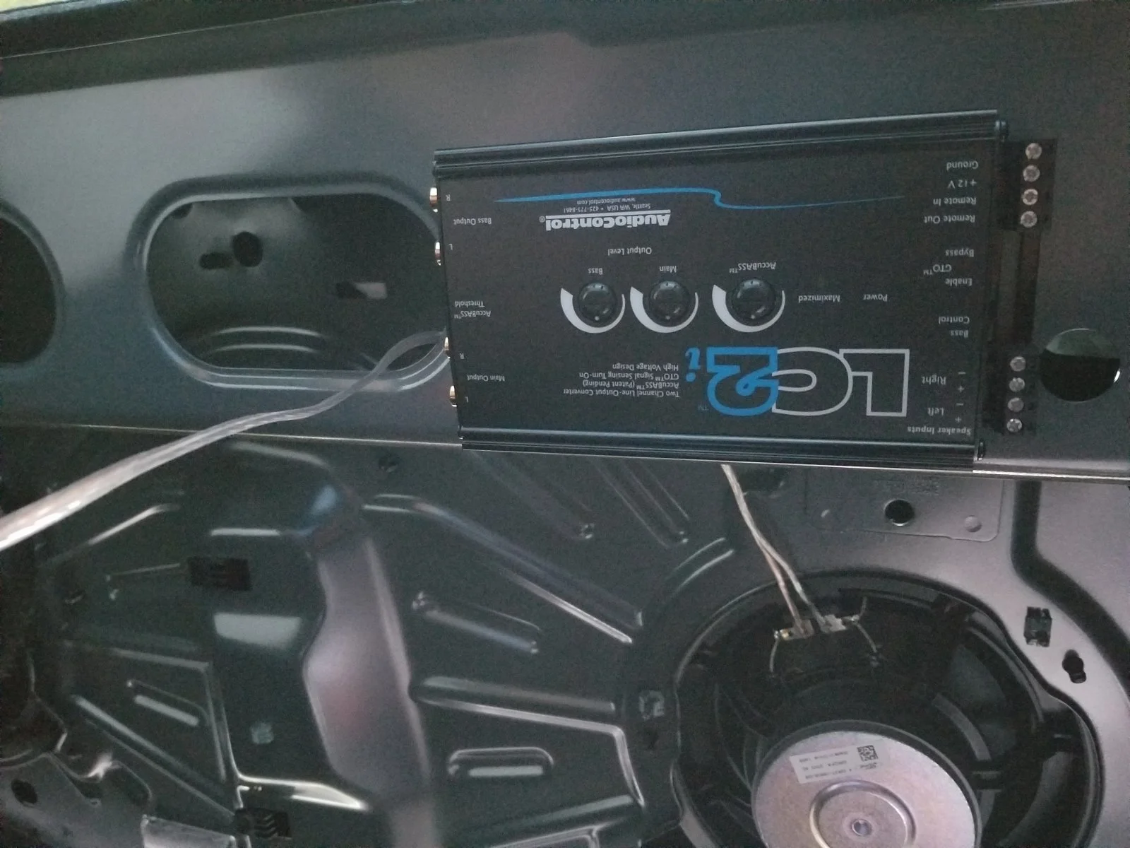

I've been doing some searching and I may have found the solution. A 5 post relay alternates power switching on the center pins. The amplifier for subs needs a signal power from the line level converter to cut the amp on. All i have to do is find a way using relays to get the mics to cut off when the amp power signal is supplied and back on when no signal. Then i could wire a switch for the amp ( remote ) power signal. When switch is off everything reverts to normal operation.
The mics may be 5v and the remote wire is 12v...gotta check the schematics. Lol

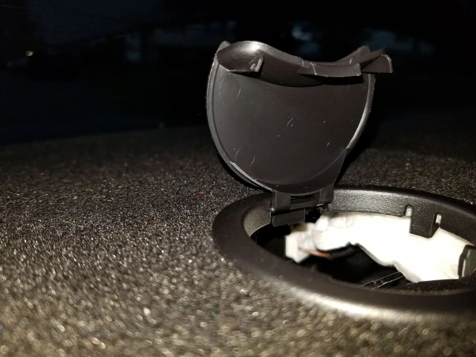

The speaker connectors are under the rear deck cover. Didn't want to disturb that stuff. The speakers have metal tangs that go into the connector that are exposed by the bottom of the speakers. Armed with a wiring schematic i peaked through the child seat tie down holes and found the correct + and - posts.

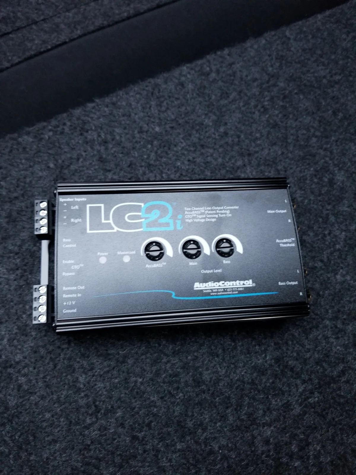

This is the inverter I'm using....
Determined not to drill holes I stuck two strips of 1/2 inch 3m two sided tape to the bottom and stuck it to the frame under the rear shelf.
The speaker wires will get little eyelets and screws or solder ( haven't figured out how I'll solder them on my back yet ). A grommet is goin in that 1/2 inch hole on the right side....all the wires on that side will run through there.

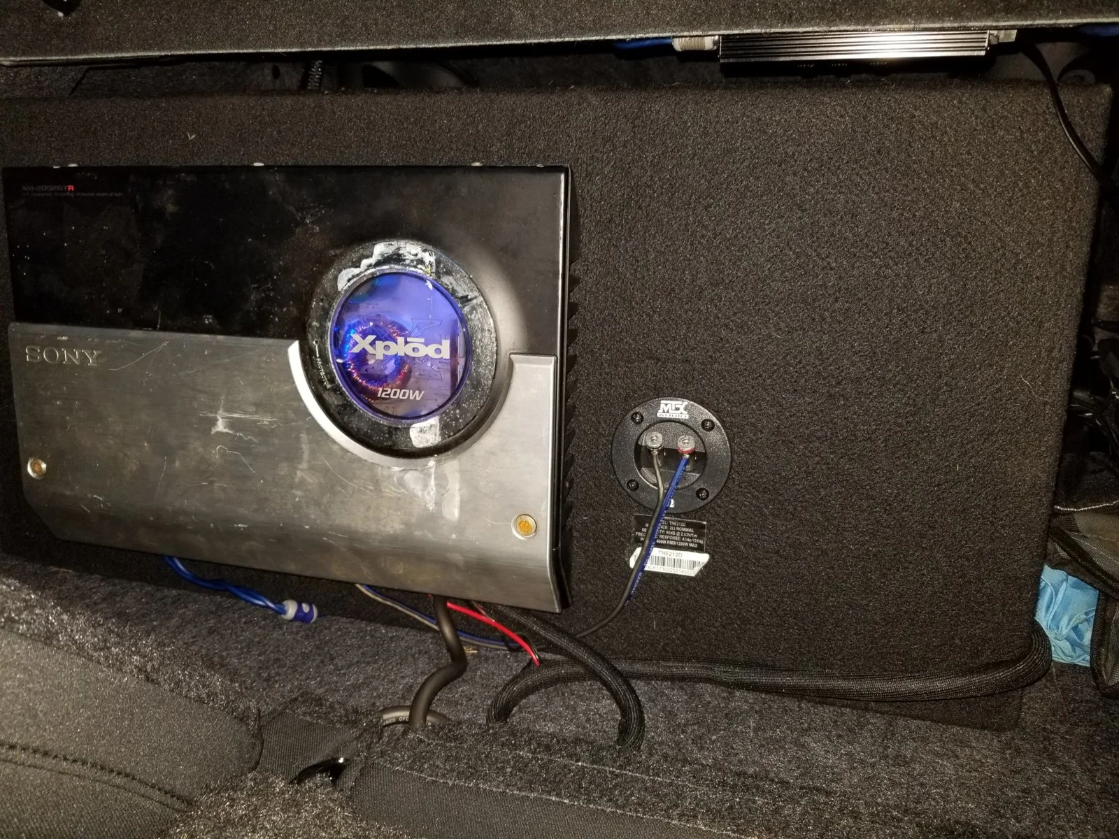

I got some more done on my lunch break. The amp is wired in. Its an old big Sony 1200 watt amp so the only sensible place was to mount it was on the box. I'd usually never do that because old amps can be affected by the added vibrations. Also, it makes it a pain if the box has to be removed. I do plan on getting a good class D amp but it aint in the budget. This install is really homage to my van....and the fact that i like bass. Lol.

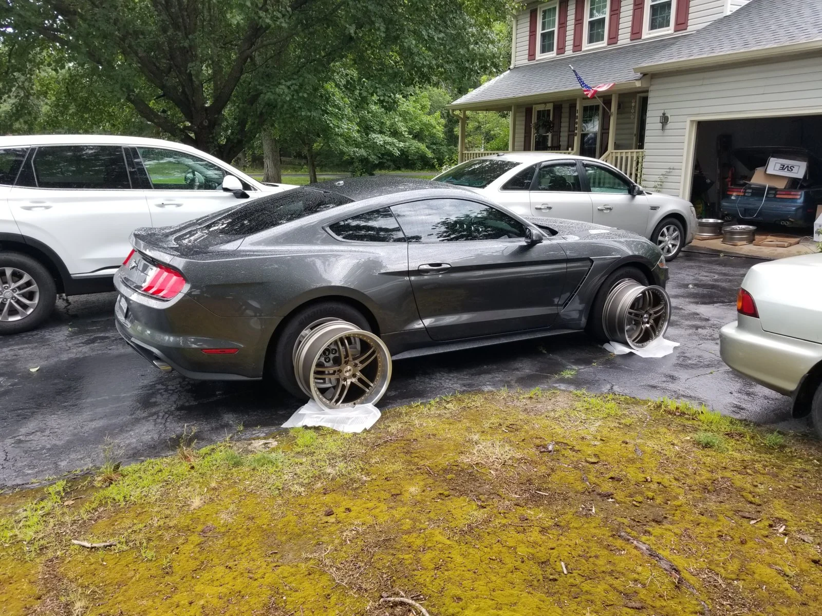

A guy that I do a bunch of performance work for is letting me get his 18 inch wheels and tires off of his 16 ecoboost. They are accented with gun metal gray so should look good on my car. They'll have to do until the end of summer.... maybe... unless I hit the lottery.

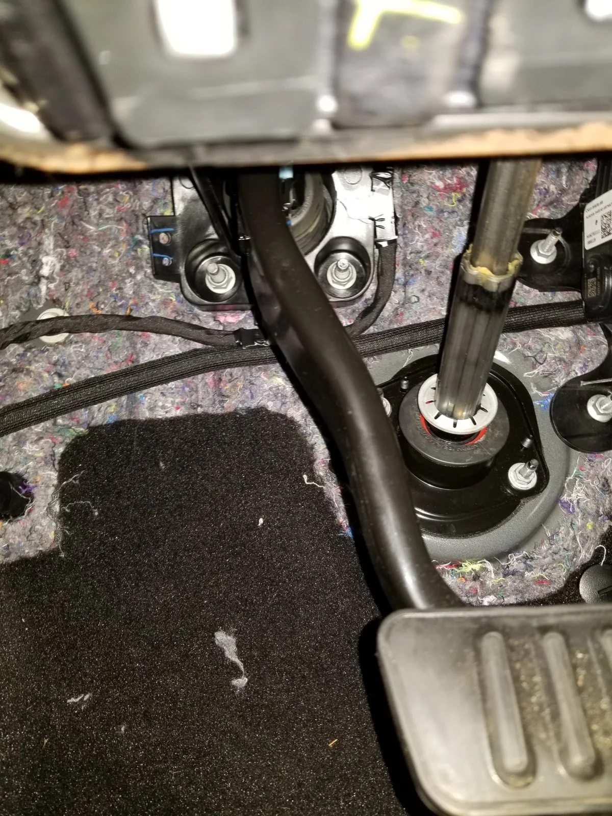

Here are some pics of the finished install. The main power wire by the pedals turned out well.

Here's the box and old amp.

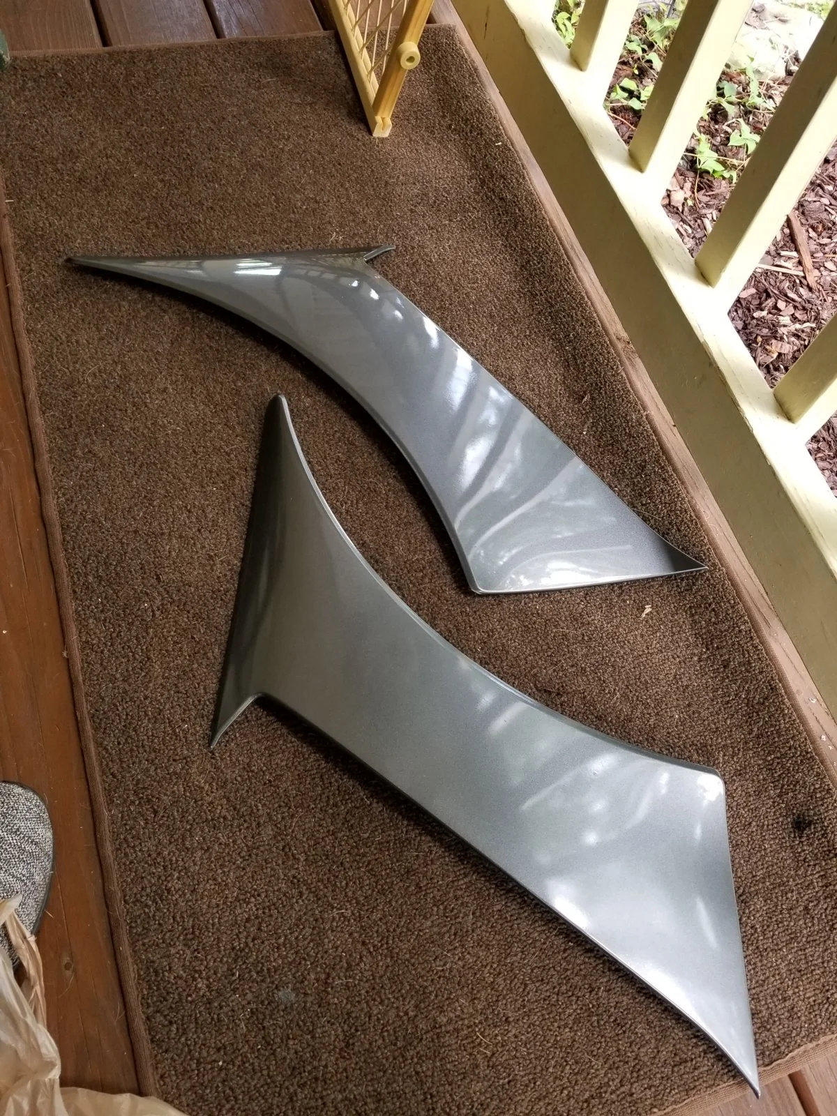

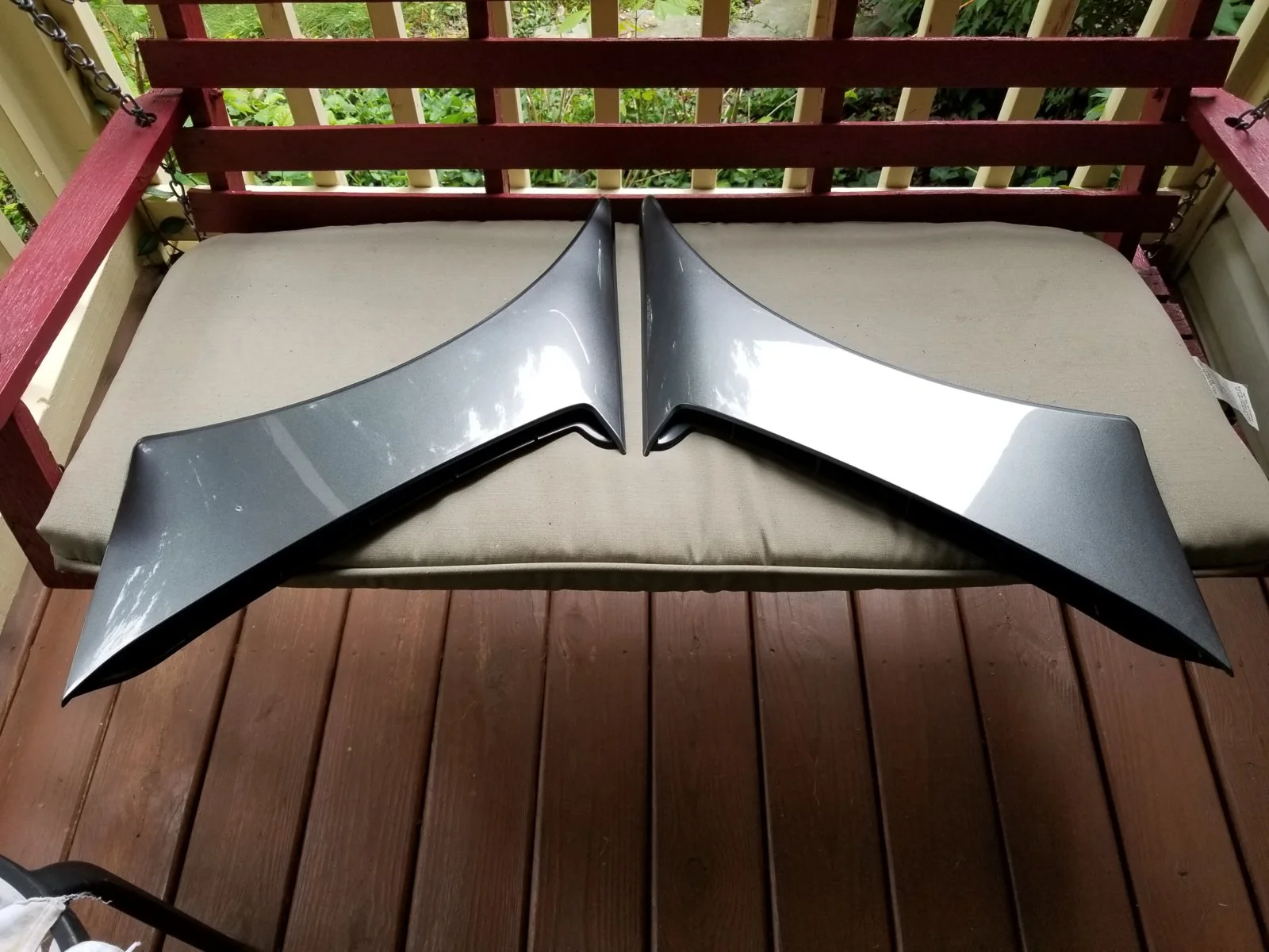

Anyway, got these in the mail. Don't know how much I'll like them but they are at the painters now. Even came with instructions to mount a wing.... ( wrong instructions )

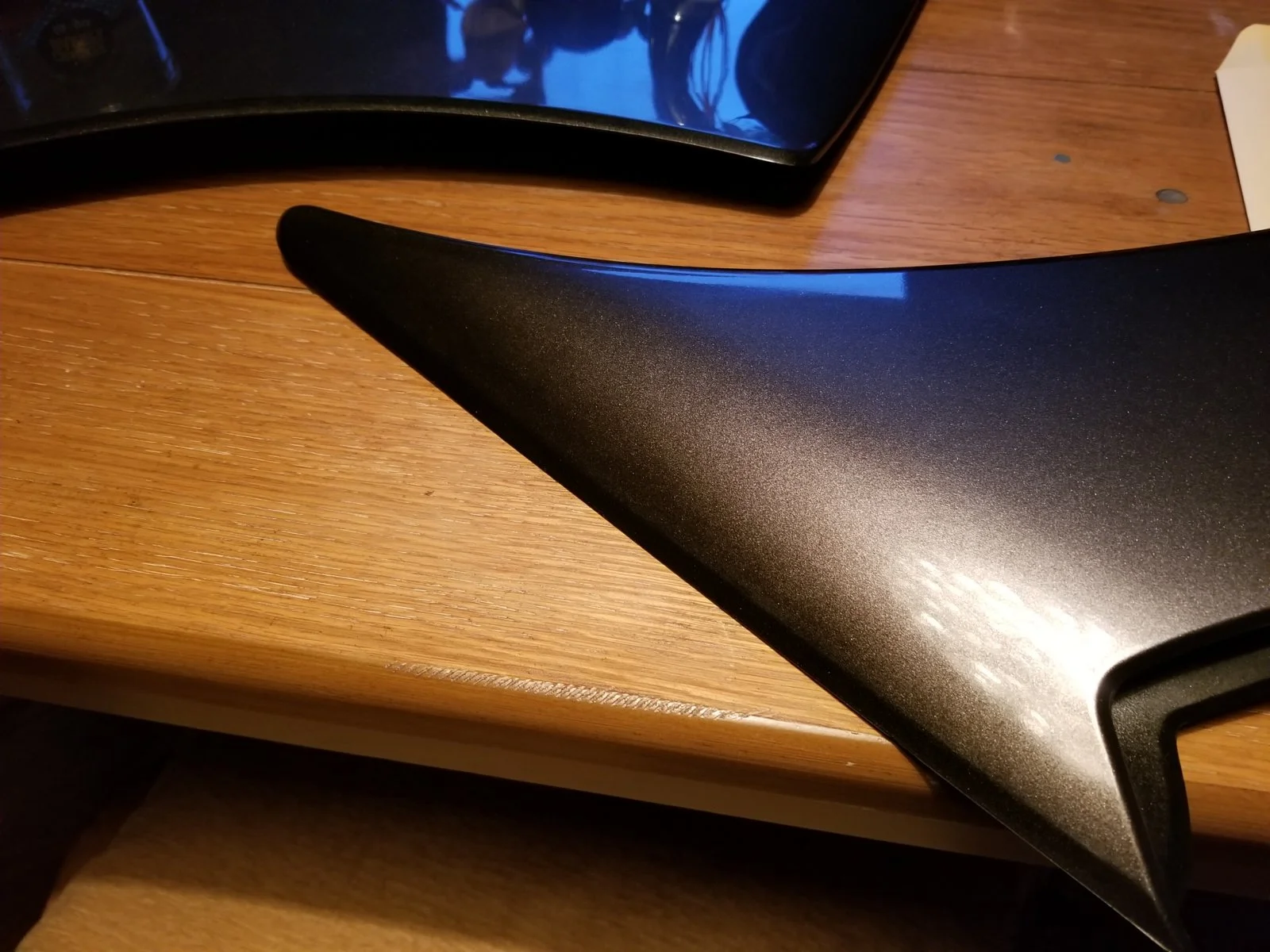

Got the scoops back from the painter. There were nibs and trash everywhere. The edge by the wheel opening has wrinkles. Tried to wet sand them out but the metal flake is standing up in the ribs so it looks ridiculous. ( trying to figure put what im going to do about that )
You can see how orange peely it is. I should've been a body man.

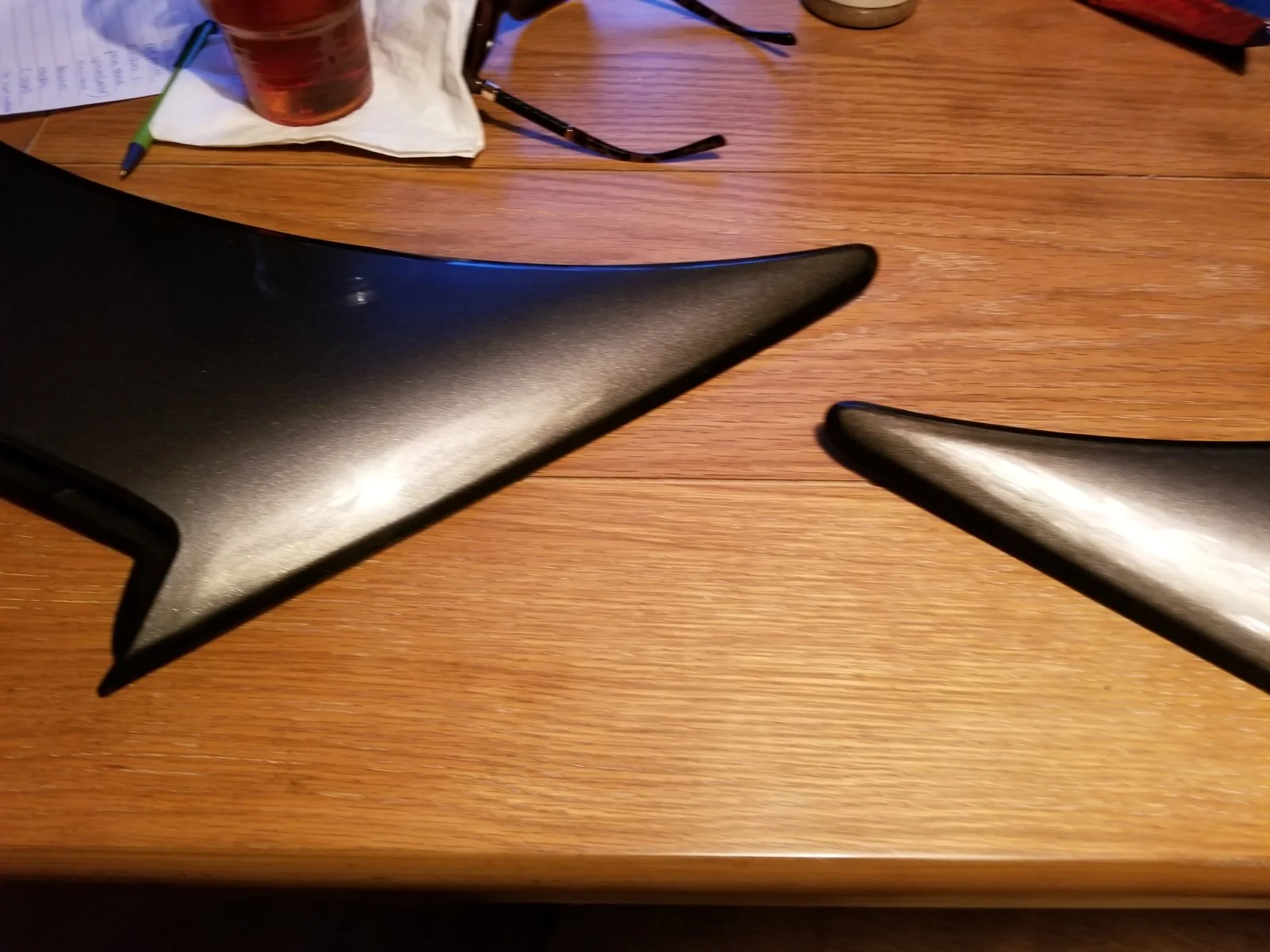

Wet sanded with 2000 grit and polished with my secret White Diamonds metal polish ( i know but it works ).

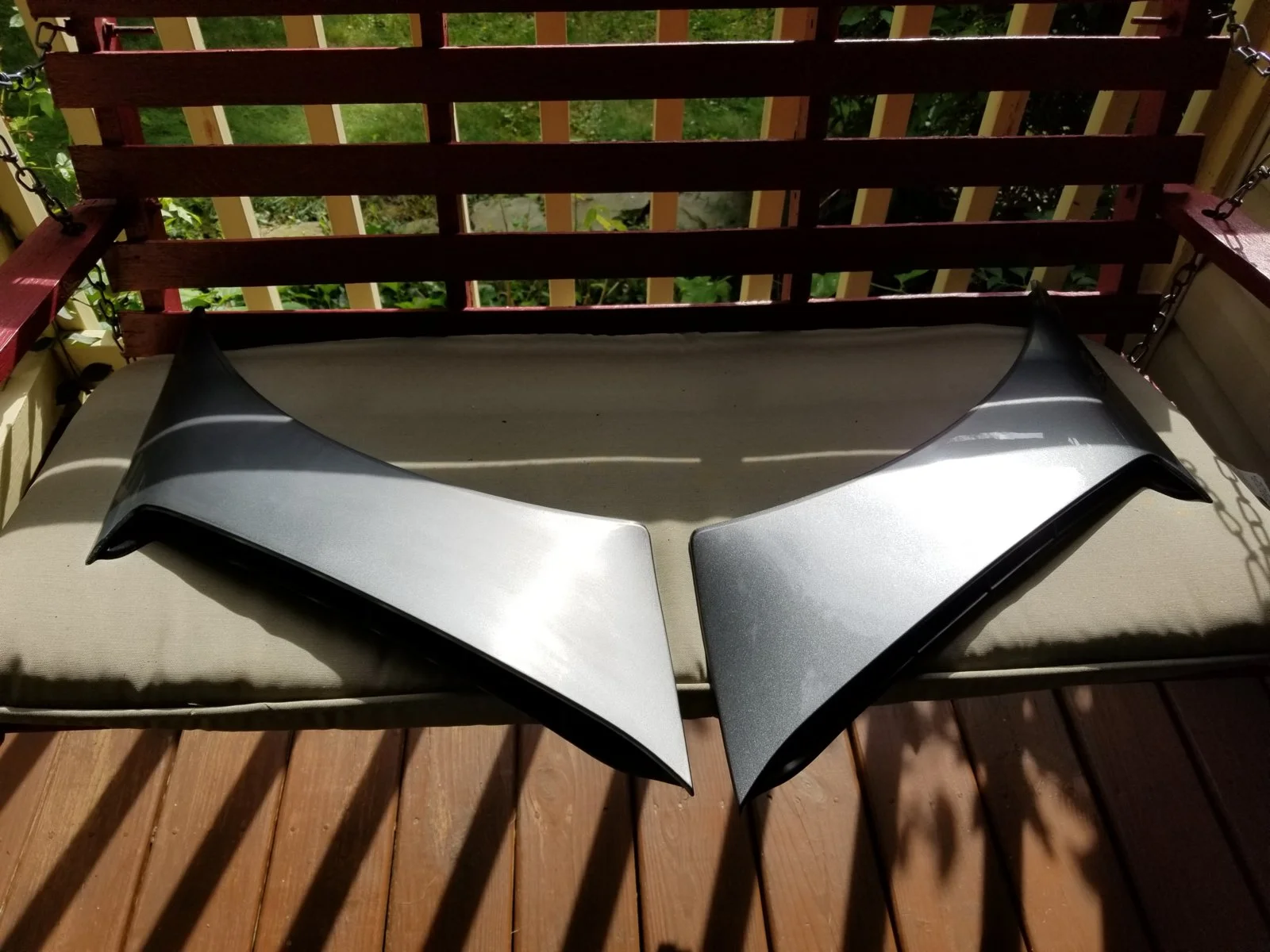

Finished products...
There's still a couple low spots left from the nibs. I can live with that though. I don't want to cut through the clear. The scoops are also a shade lighter that the car paint. If i was painting them i would've added some more clear to try and darken it up a bit....I didn't paint them so...
I think I'm going to do a light metallic black fade down from the top and paint the bad edges black on both sides. I think I can make the scoops blend in a little more that way. We'll see...

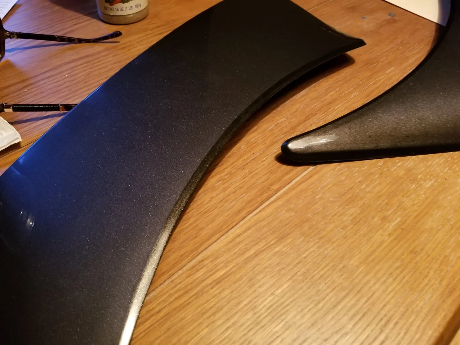

I didn't do the carbon fiber type fade I planned on. Didn't want to screw them up and didn't want the scoops to look like somebodies screw up.
They are faded with a tuxedo black with silver metallic. The fade lines up to the shadow for the body line down the fenders and doors. Also, used it on the leading edge by the wheel opening to fix the screw up the painter left me with.
I cleared over them, wet sanded, and polished with my secret stuff.

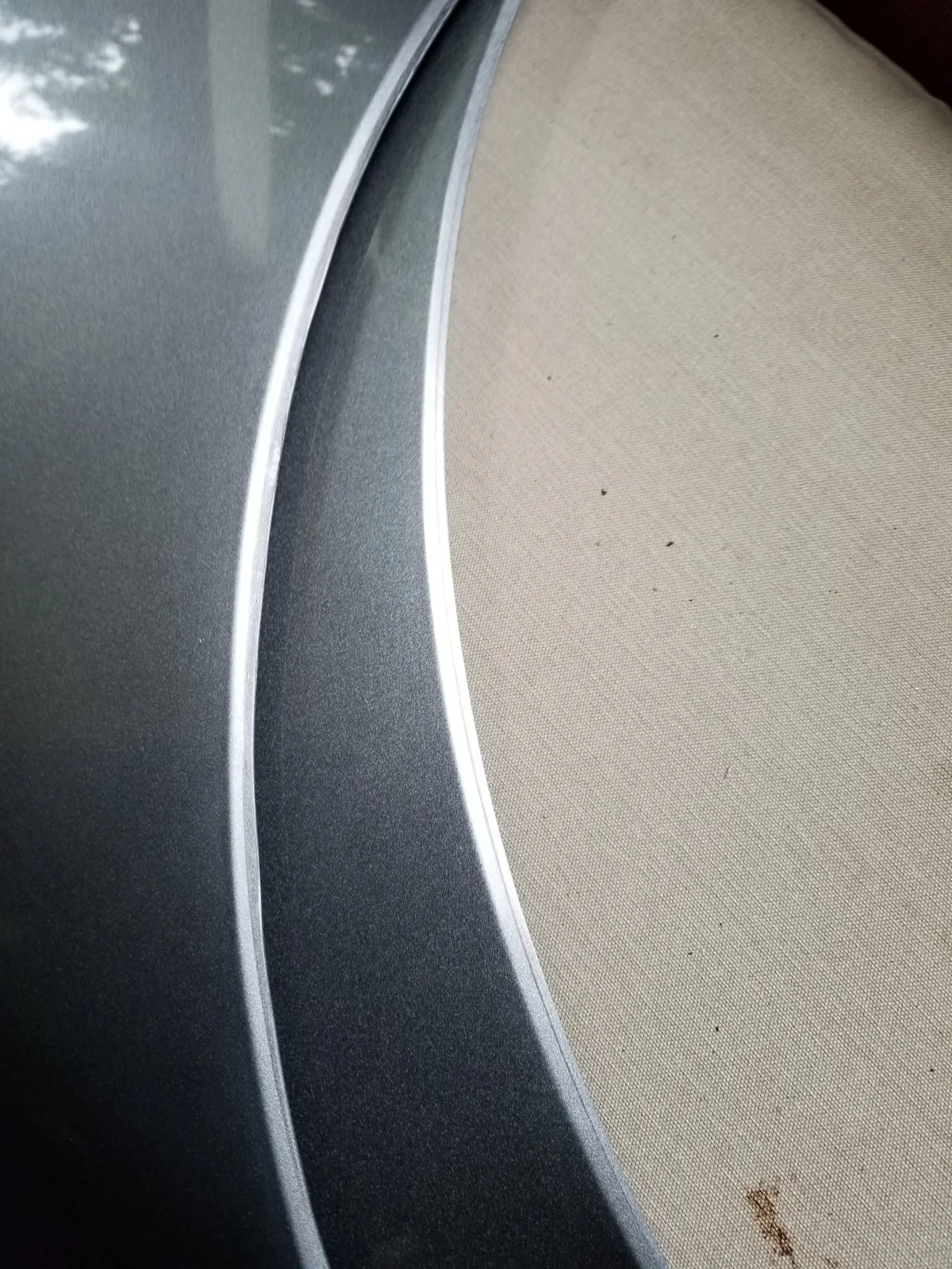

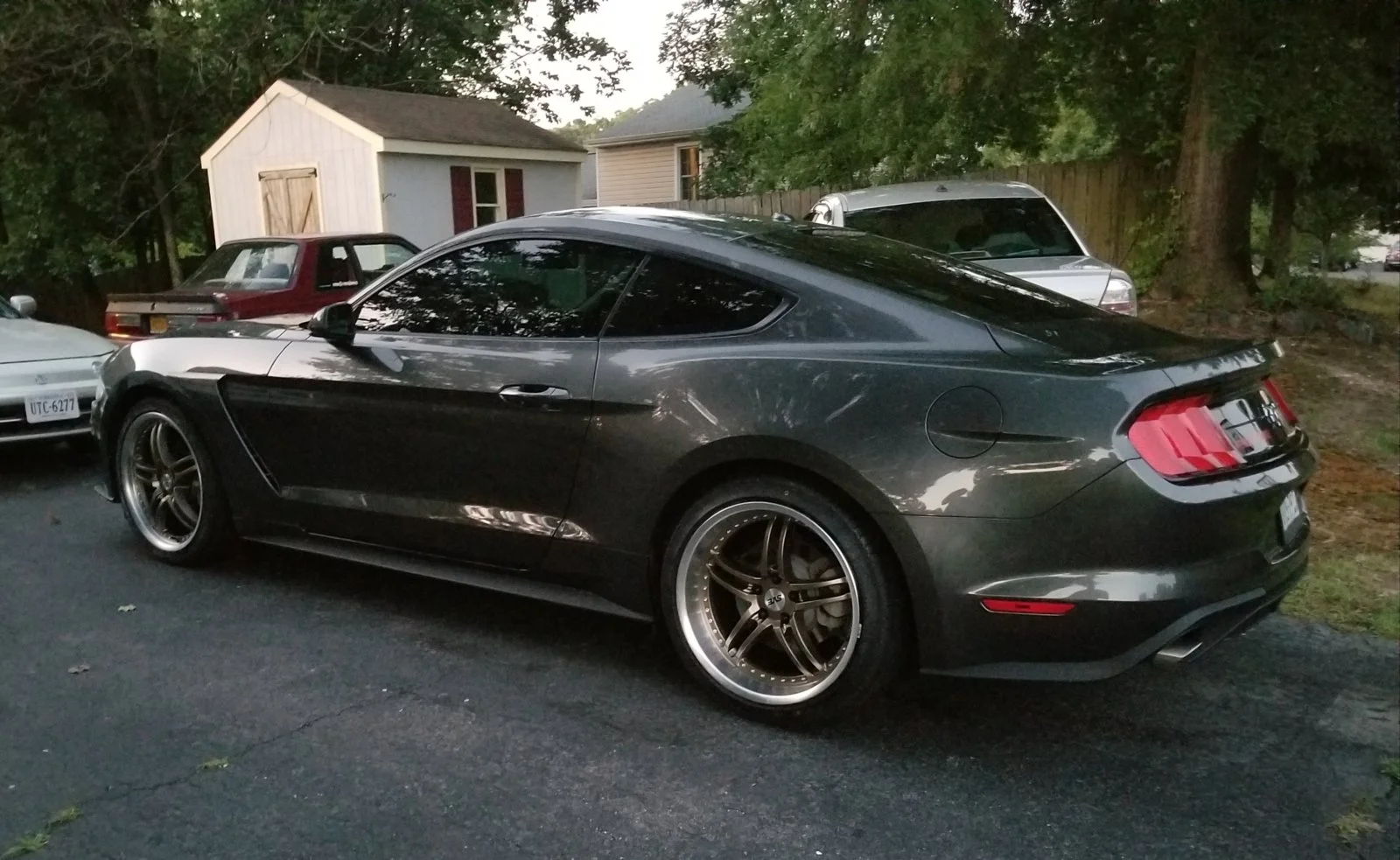

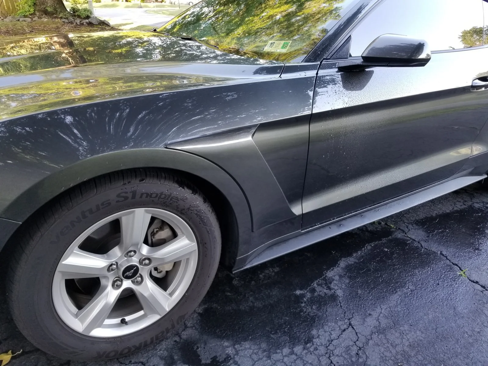

Its done...they are on...
You can barely tell that they are faded at all unless you get up close. Rained all day until right before i stuck them on. Its It's different and they're growing on me. I think with the right wheels and stance they'll look better.

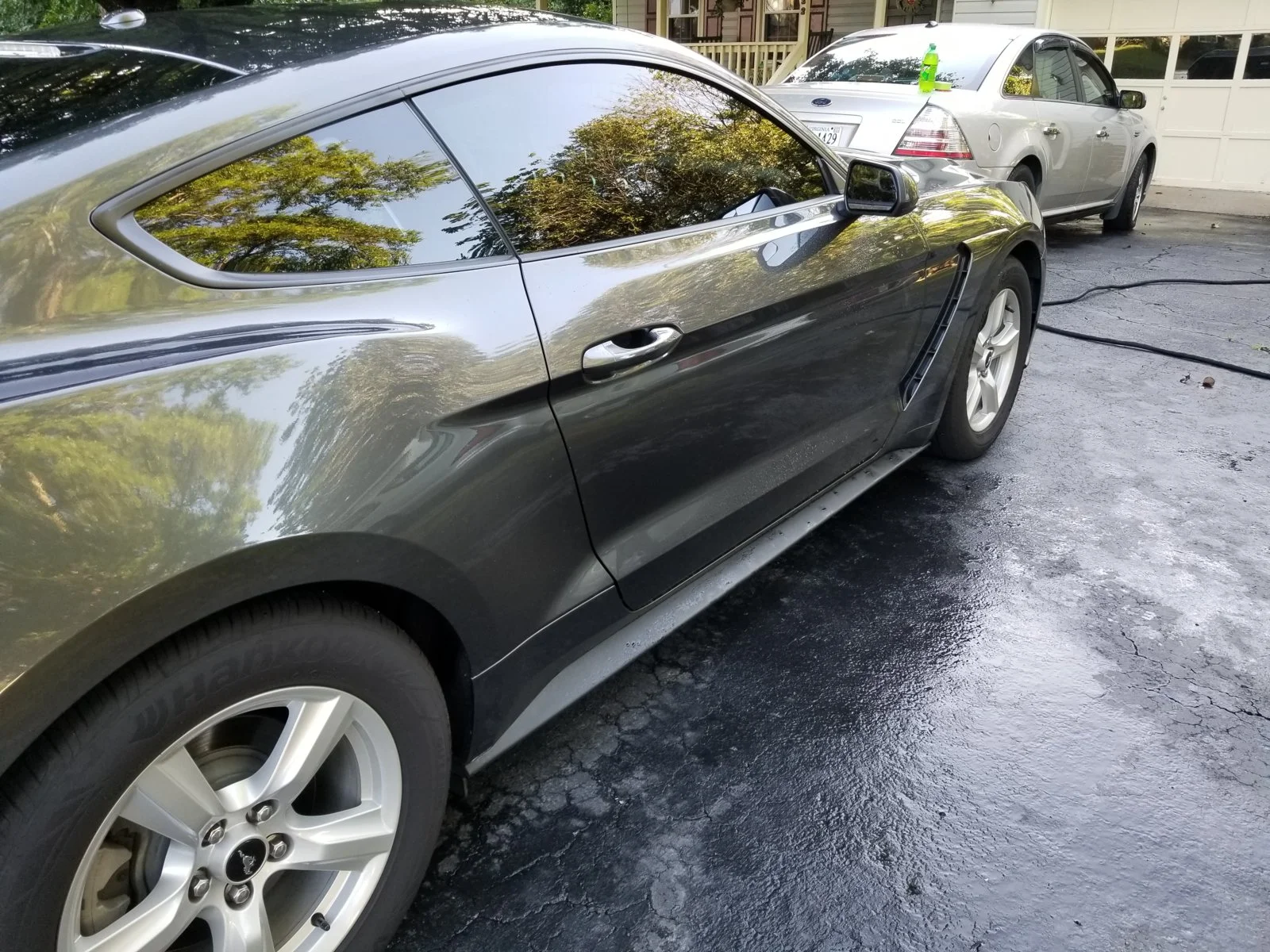

Some kid side swiped the front right corner of my car. Then....his young #$$ tried to speed off. He literally changed lanes into my car. I stood on the brakes and swerved left as far as I could go without hitting the car in the other lane. Only minor damage to the headlight and corner of bumper. Nothing broken or dented. Should buff out. Smh
I chased him down and scared the heck outta him. Lol
We've all been young and stupid. Didn't get insurance involved.

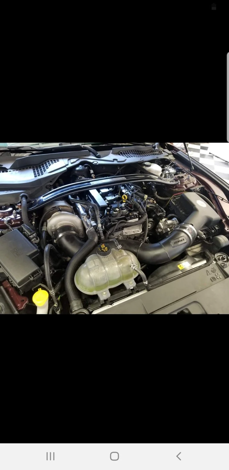

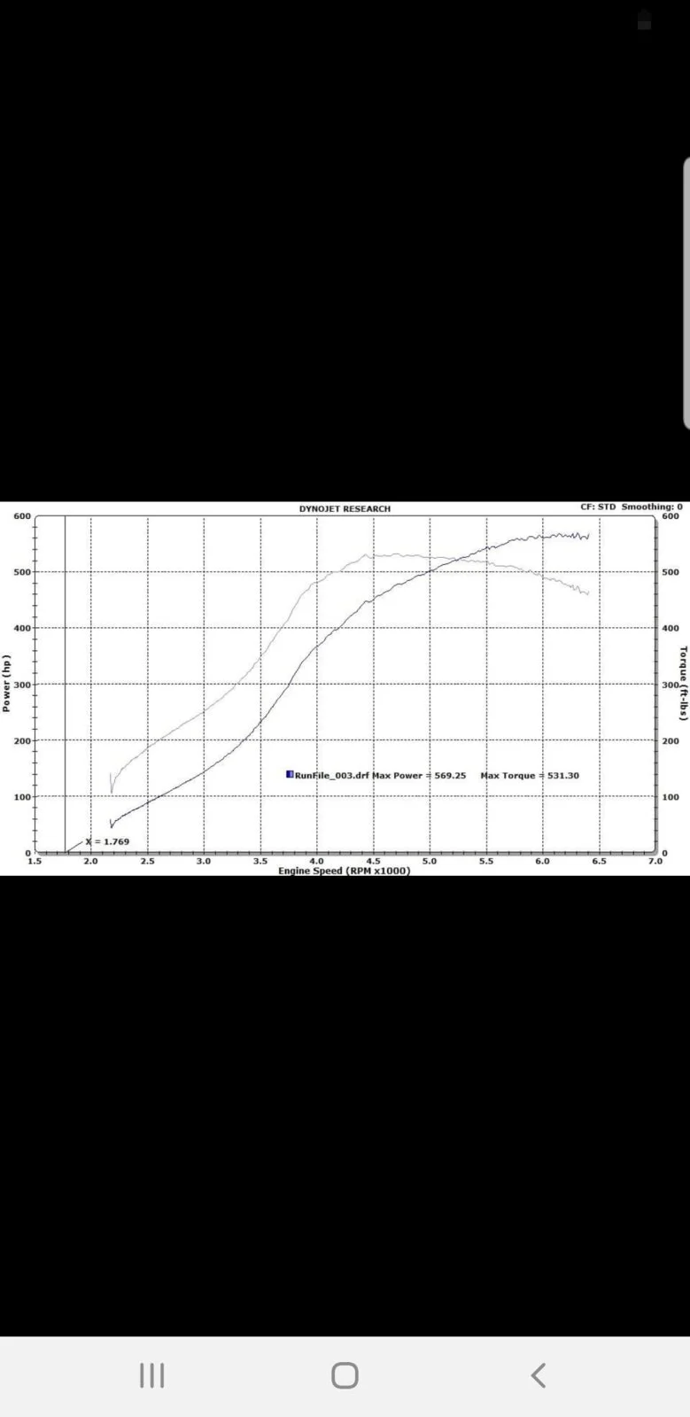

Thought I'd put this here for the nay sayers....that's 569.25 rwhp. Stock heads....pistons....rods.....cams....upgraded turbo. Way cheaper and easier than building a coyote.
Pick is from the great interwebs...not my car.

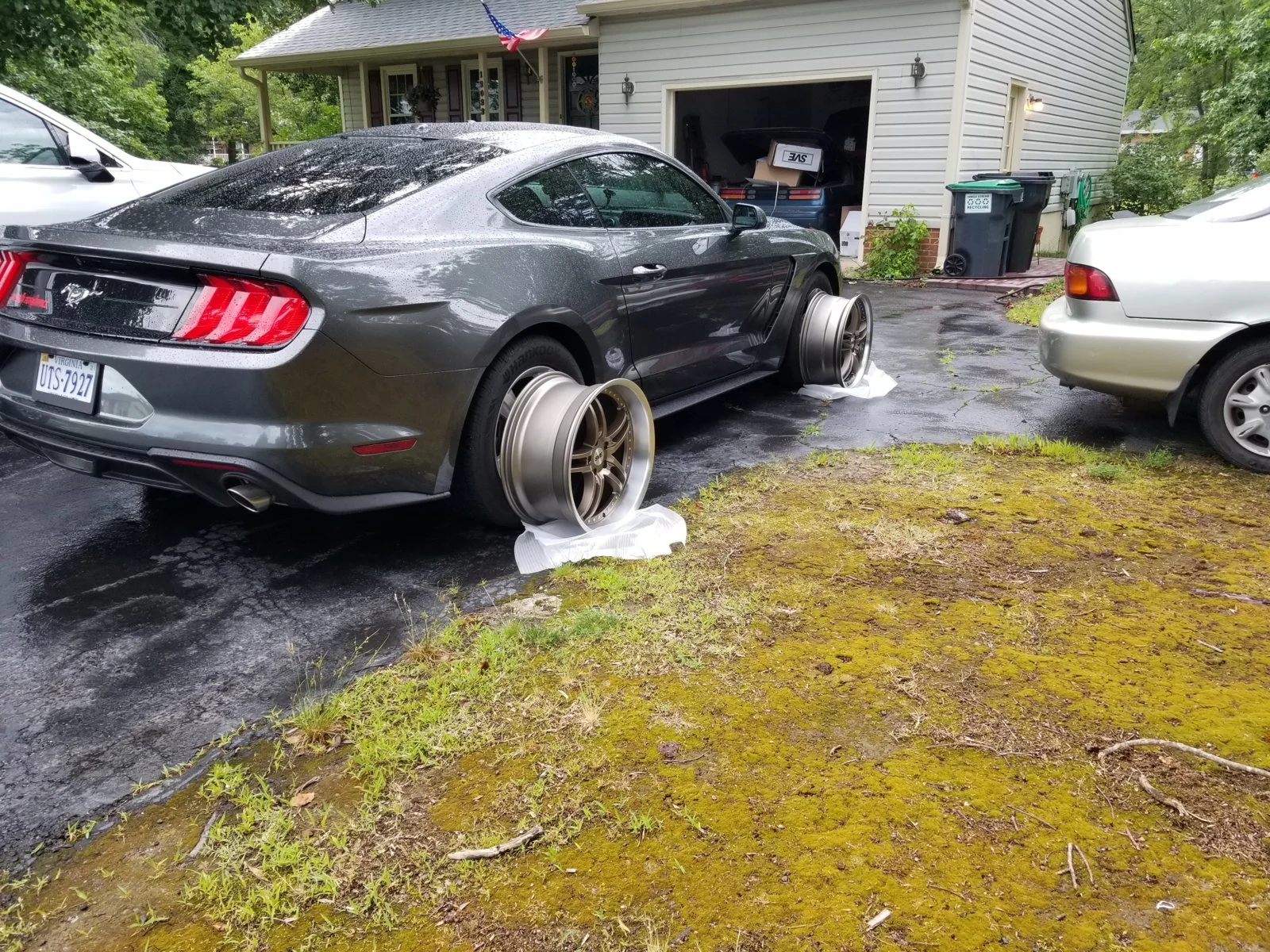

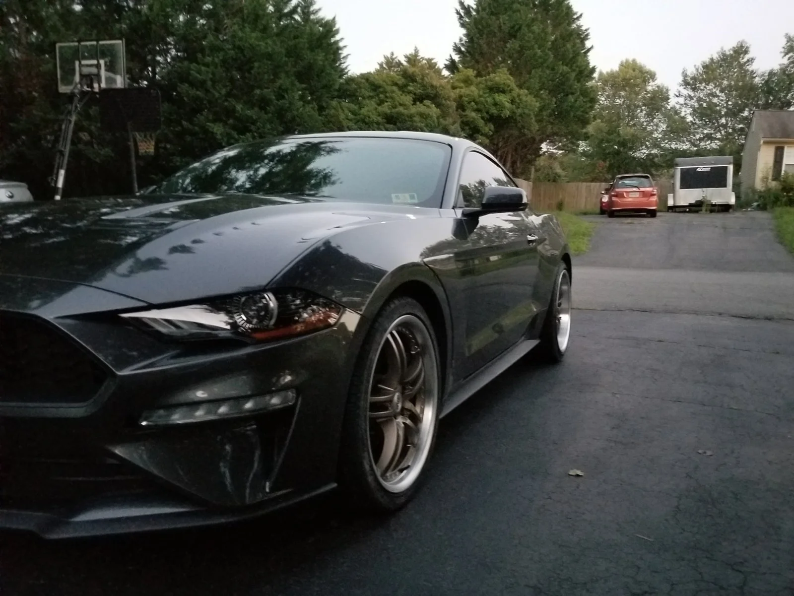

Hey guys....the tires will be on order in a couple weeks. Been eyeballing the RTR upper and lower grille. I think the color of the lights when off will match my car color well. The lower part gives me the ability to see what i can do for fog lights.
My fox turbo is still getting worked on....but i cant help myself from modifying this one. Smh
