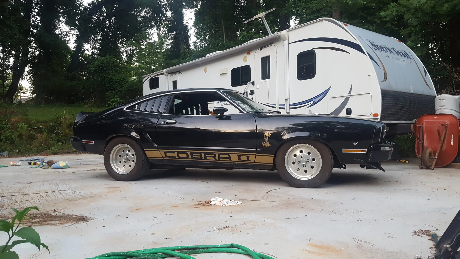

I am not using any spacers. My setup starts on page 9, post 177:
Alright-I FINALLY broke down and bought the new wheels and tires, well rear tires as of right now. I don't have the fronts yet, no one has the size in stock (165/80-15's on 15x4's), so they will have to wait until next weekend. But, I have the rears- 15x8 with 265/50-15's. I have to say I love it!! Anyways, since there are only a few pics with this size, I thought I would post the few I took of mine earlier today. Sorry for the relatively crappy quality-I took them with my phone. If anyone is interested, I can take a few more with my actual camera.
:rock: :D
They are 4.5 backspacing.

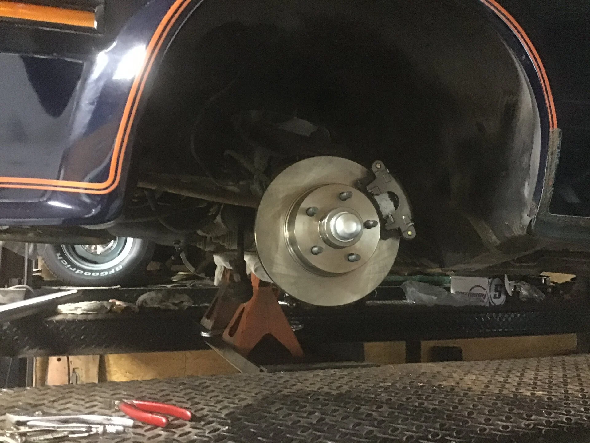

After really not finding a 4 lug wheel I wanted. I decided to do a 5 lug conversion. I have my heart set on the magnum 500s as the 4 lug magnum 400s were not doing it for me. I used the speedway Granada style rotors with the GM calipers, a nice complete kit from speedway. The rear I am replacing the axles to a five lug. Having a hard time finding the axle bearing retainer gaskets and I believe I am going to use 1987 Ford Ranger 2wd rear drums. Once I have completed the conversion, I will see what tire/ wheel combo I can go with. I’m still thinking 15in chrome magnum 500s with the cobra center cap. Hopefully it will be completed soon and I will share pics. If anyone knows where I can find the bearing retainer gaskets, please let me know! Thanks

scooterstangs
Aug 18, 2020
57
Rhode Island

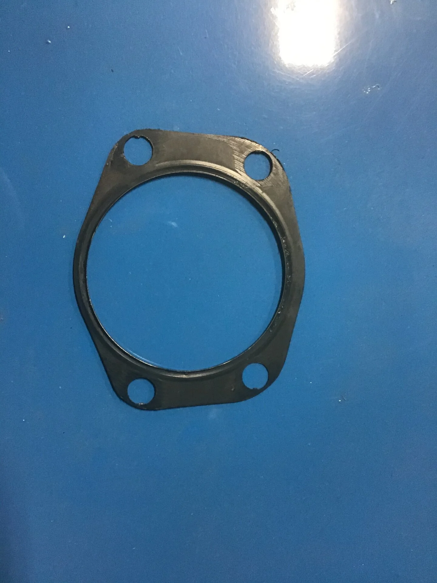

Here it is. Sorry for the picture orientation. I have, what I believe is the fel-pro part number, but it is no longer a good number. I will post that number later.

LILCBRA
Dec 6, 2005
3,274
2,478
174
49
Marietta, Ga
Rock Auto was wrong?! Shocking. (That's sarcasm in case anyone was wondering...) That was the best I could come up with in a quick search and thought it looked right. I have an old 8" out of my old wrecked coupe sitting in my shed that I've had the axles out of, that piece looked familiar enough. Then again, it's been a million years since I've taken it apart. Past that, I'm not sure where to look. If you have a Napa near you, maybe they can help you more so than an Oreilly's or an Autozone. Seems I've always had better luck finding II specific parts with Napa than anyone else. Then again that was a small town Napa in Amish country in Iowa where they were used to looking up obscure, hard to find parts. :shrug:

This piece?
The pic says it all. It's a Fel-Pro 55035 according to them. $1.86 a piece.
When I get to take mine apart I'll find the replacement for sure. It looks like there are several out there that are similar. Thanks once again.

MustangIIMatt
Easy there, this ain't a dating site.
Mar 7, 2002
8,679
4,162
224
RTV silicone is your best friend, if you don't get such a gasket...
Amazon productView: https://www.amazon.com/Permatex-81182-Gear-Gasket-Maker/dp/B0023GM2KK/ref=asc_df_B0023GM2KK/?tag=hyprod-20&linkCode=df0&hvadid=198091122898&hvpos=&hvnetw=g&hvrand=10026223513508739951&hvpone=&hvptwo=&hvqmt=&hvdev=c&hvdvcmdl=&hvlocint=&hvlocphy=9027400&hvtargid=pla-406710904314&psc=1
Those two RTVs in particular are "friendly".
The ONLY thing Chrysler got right when I worked for them (besides the marketing and styling on the LX-platform cars and the Ram pickups) was their specialized RTV formulations that resisted certain fluids. Permatex either made them for Mopar or they copied the idea. The ATF and gear-oil resistant formula RTVs are spectacular from both brands.
