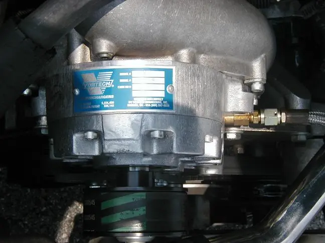

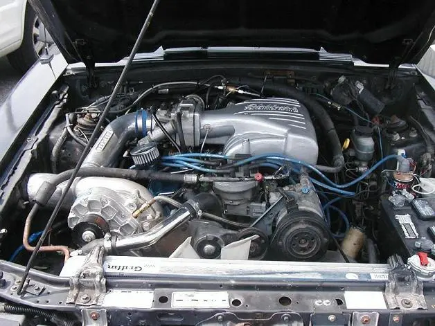

i don't know... i'm getting so frustrated... i don't know what to do, i don't know where to start... i dont wanna pull that engine out again, or the tranny... like i've said i changed the PCV valve with a supra... today i got up on boost and chacked it afterwards and it's still there, so it's holding up..i don't know why it's still leaking... i got couple of pics of my engine maybe somebody can tell me if there's anything wrong...
