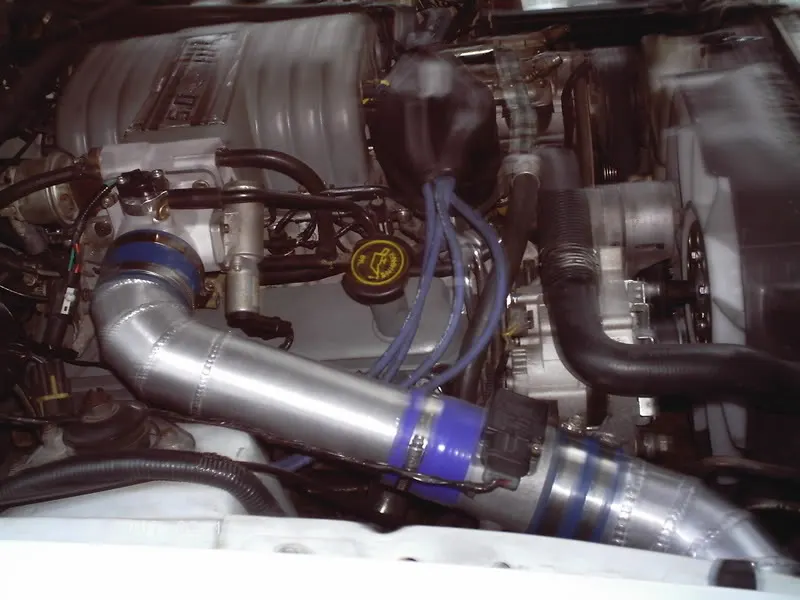

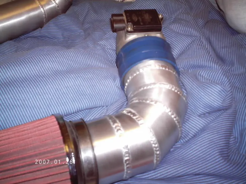

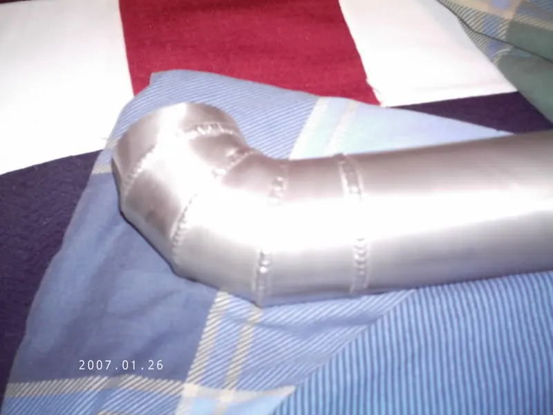

i made my own
i had a cheap ebay CAI before, i got bored and made this one, i went off the Ebay one to make this, it may hurt performance with all the jagged turns but i like the fabricated look with all the welds and i doubt you could tell a HP difference on a dyno at all.
i bought the material online, i sized it to the MAF inlet and outlet so its a smooth transaction all the way through the tube. and then i layed it all out, figured out the angles and cut them up and welded them together.
i got alot of complitments on it, they ask where i got it and i tell them i made it myself they freak out.
i work at a shop that makes oil pans and valve covers so thats where i welded it up at. i am planning to make some nice looking VCs for my car sometime.
That's some nice welding there Foxfan. I like that intake. It would be interesting to dyno that thing on an otherwise stock 5.0 to see what kind of gains it could make.
Very nice welds FoxFan, maybe I'l just tack my kit up and ship it to you with a $20 in it to finish it? :D
On a serious note, what size is the tubing? what kind of tubing, like is it just exhaust tubing? Why didn't you just buy some mandrel bent tubing and cut it up to avoid all the welding? Nice work man, very nice work indeed.

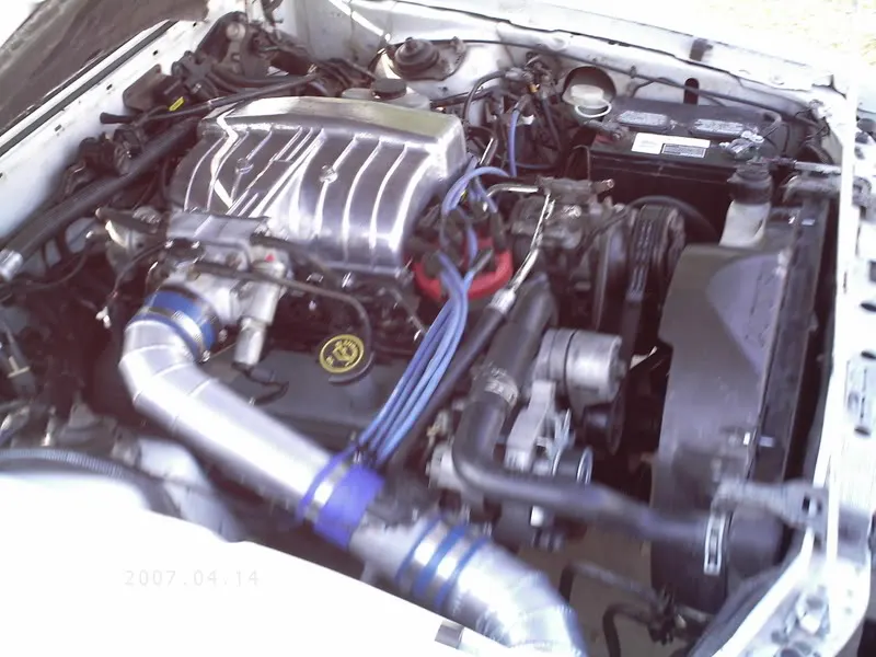

i made my own
Looks really good man. I like the fab look also. P.M me with the price you want for one. peace
