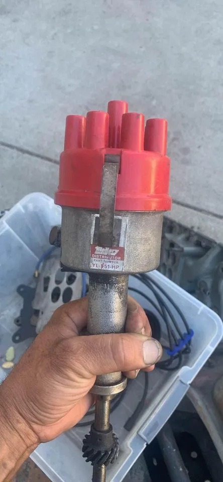

Mine is a 1966 289 C. It has a stock distributor and today I checked the points and they were a bit fried. I surfaced them and that made an improvement. I picked up a Mallory
YL-551-HP today so I will give it a try. What are your thoughts about this Mallory?

The distributor will run well, but it does not have vacuum advance, so that will hurt your mileage.
