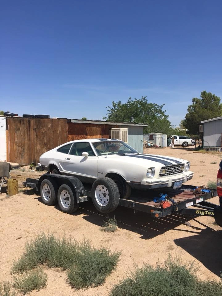

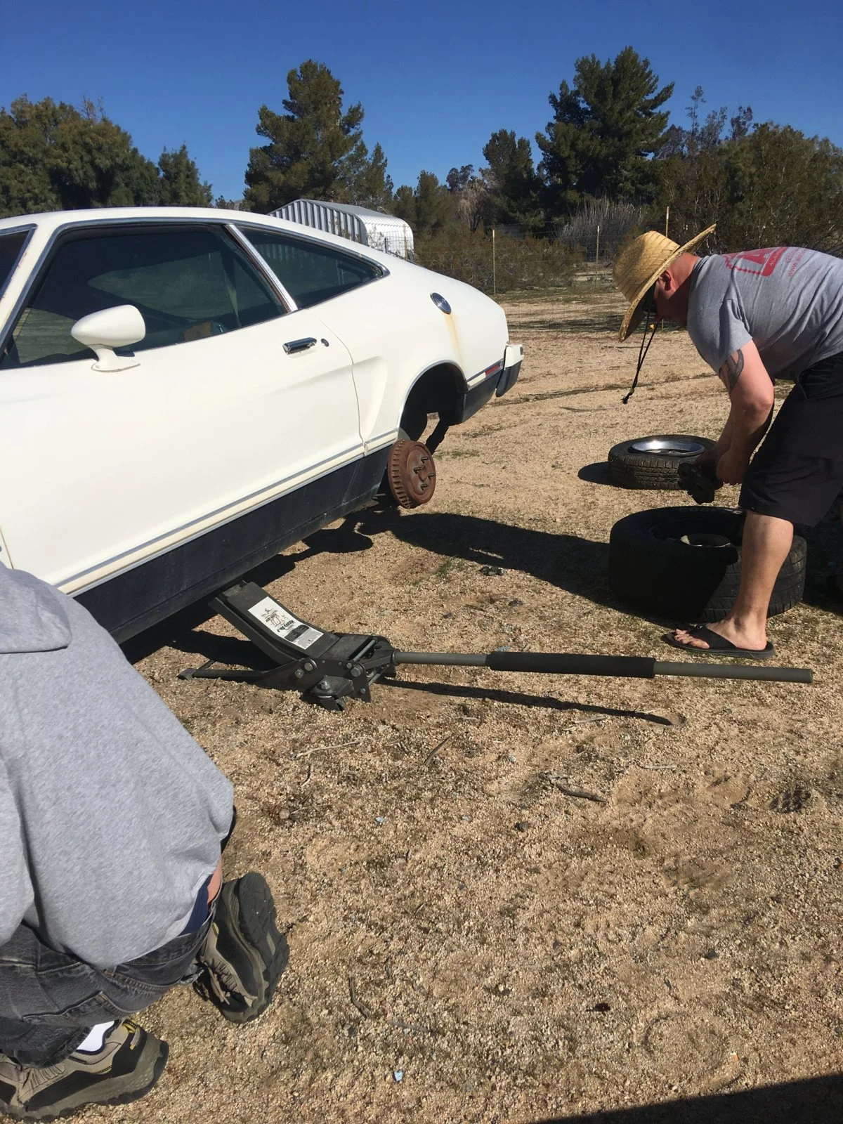

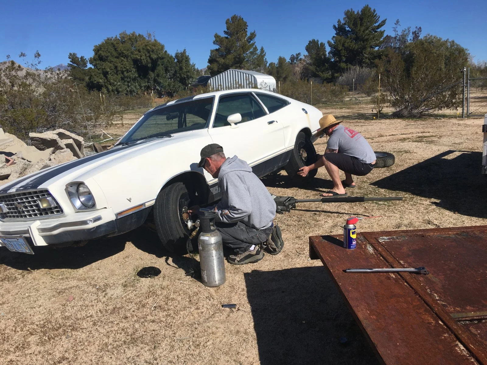

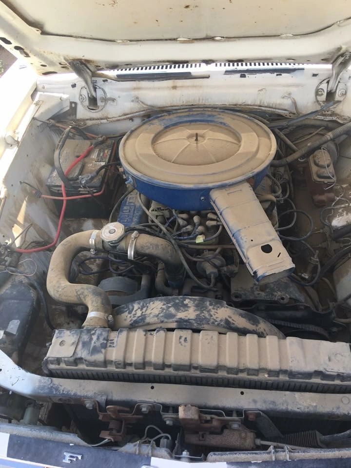

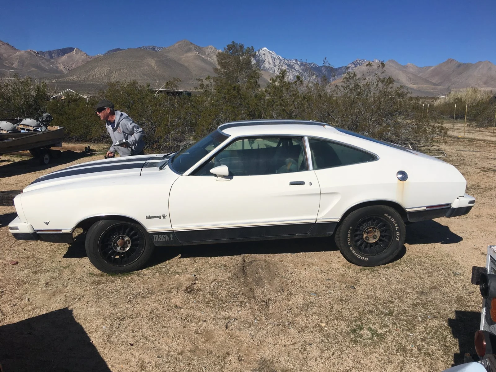

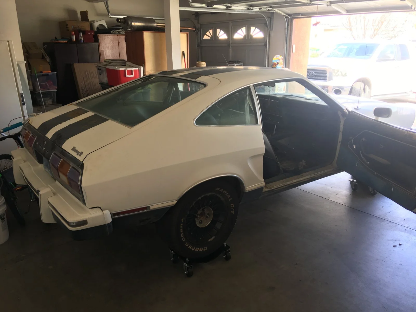

So I’ve been on here almost a year now, long story short, my best friend and I used to cruise this car back in high school. Last year he gave it to me, and I only just recently managed to get it to my house here in Murrieta California. I’ve never done this before, so I’m just going to dive right in. There’s nothing special about this car, so I feel like I can go nuts and do whatever I want (it will NOT be stock).
Reactions: 2Blue2

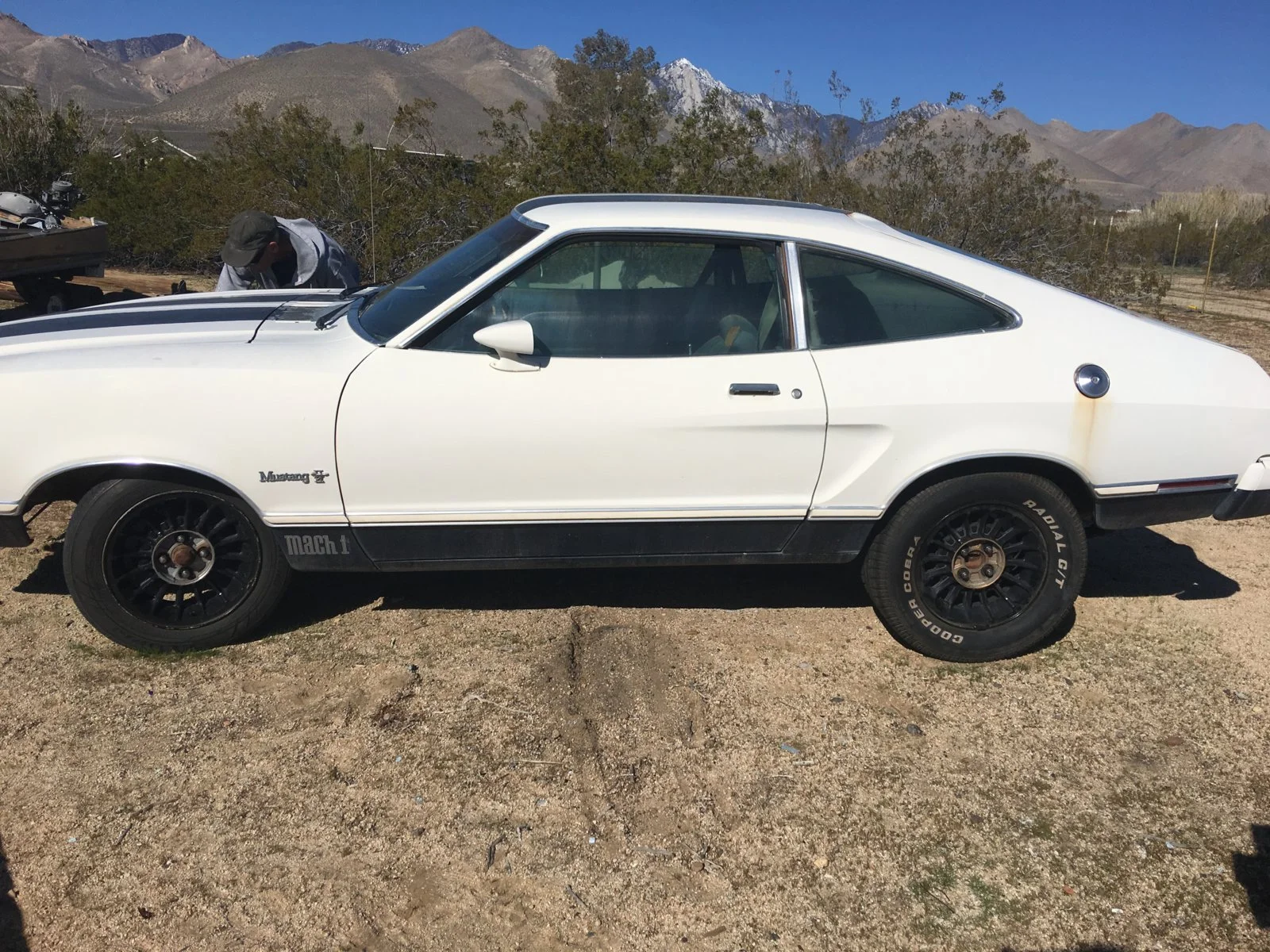

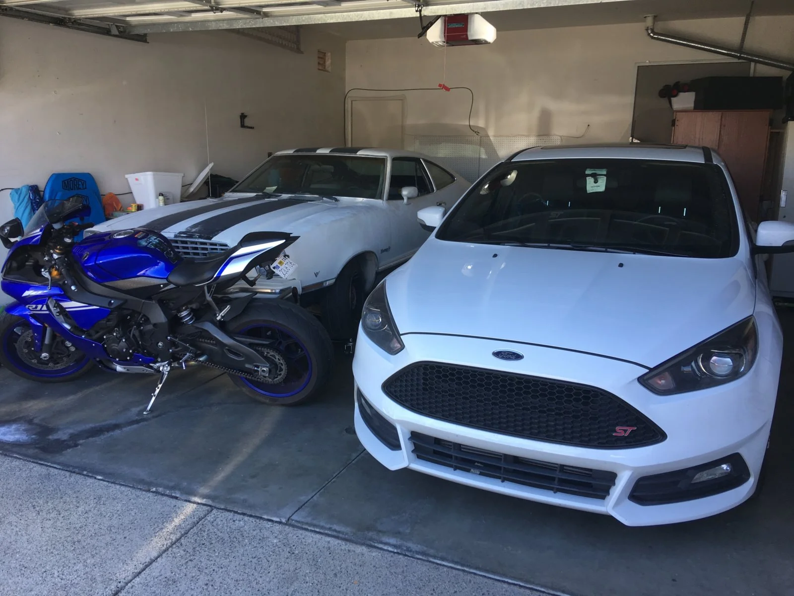

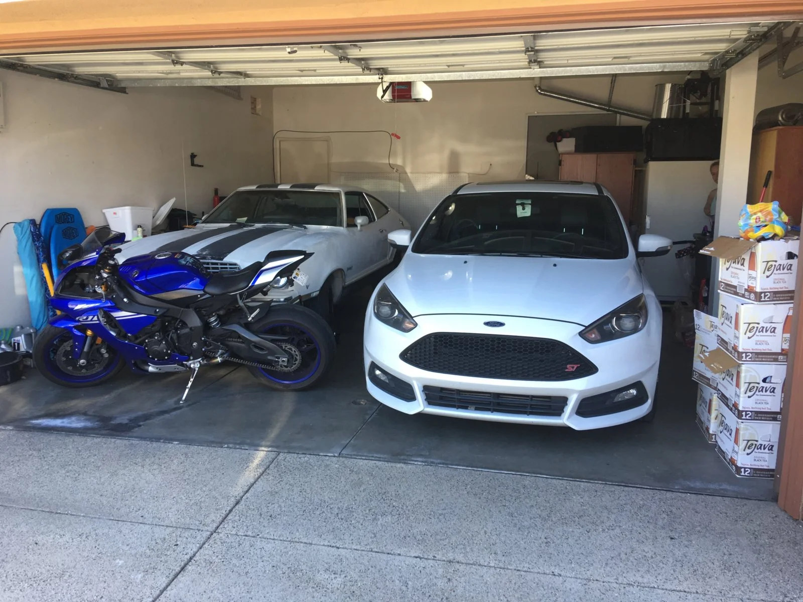

thought I could fit all my toys, minus the truck. Wife didn’t like it.

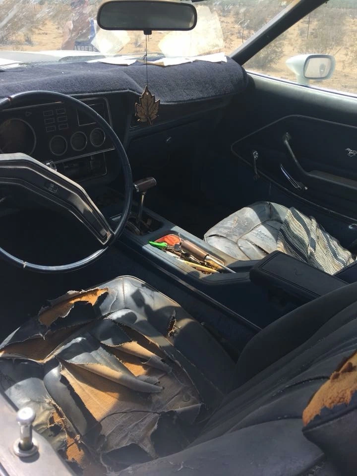

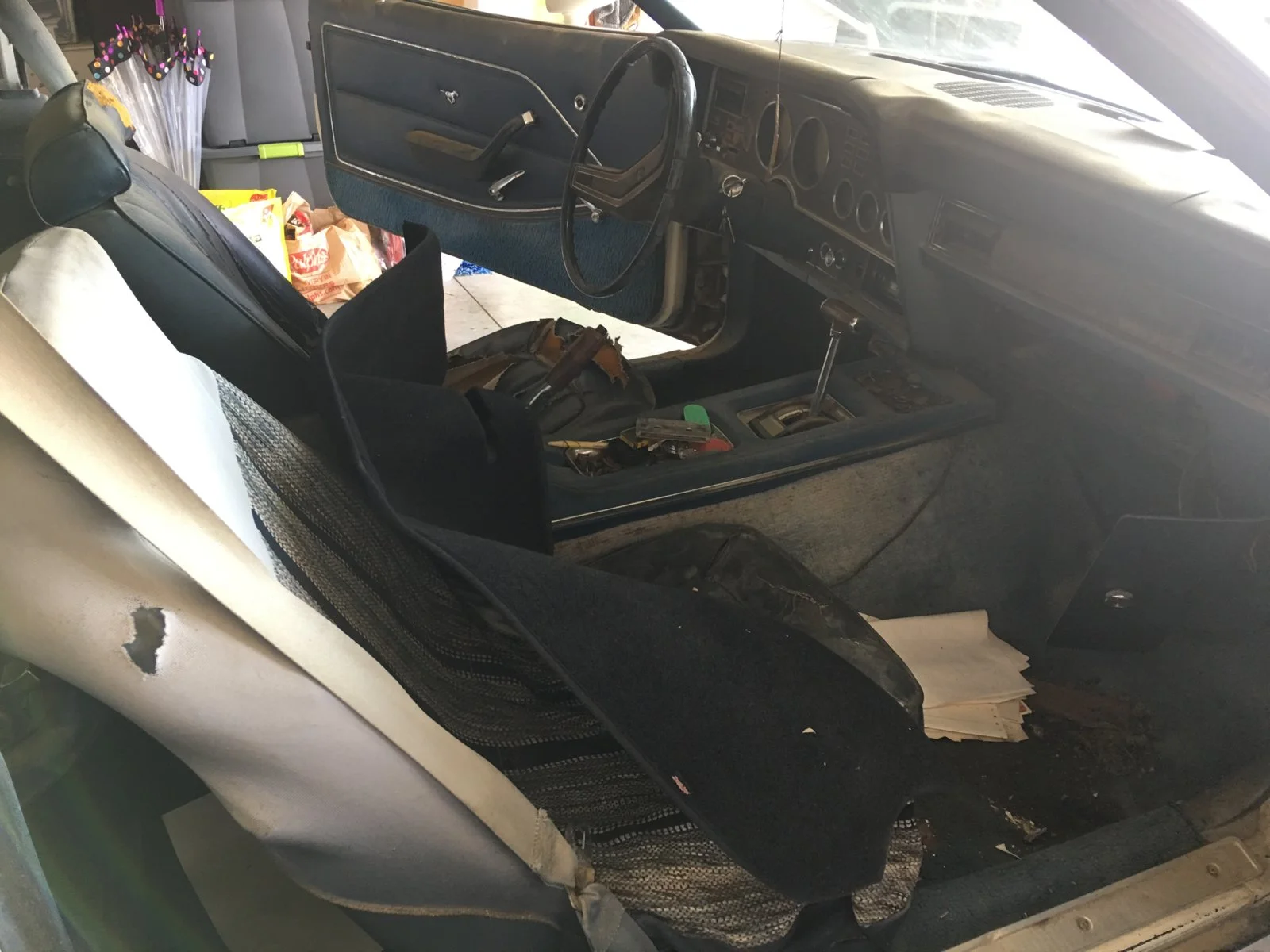

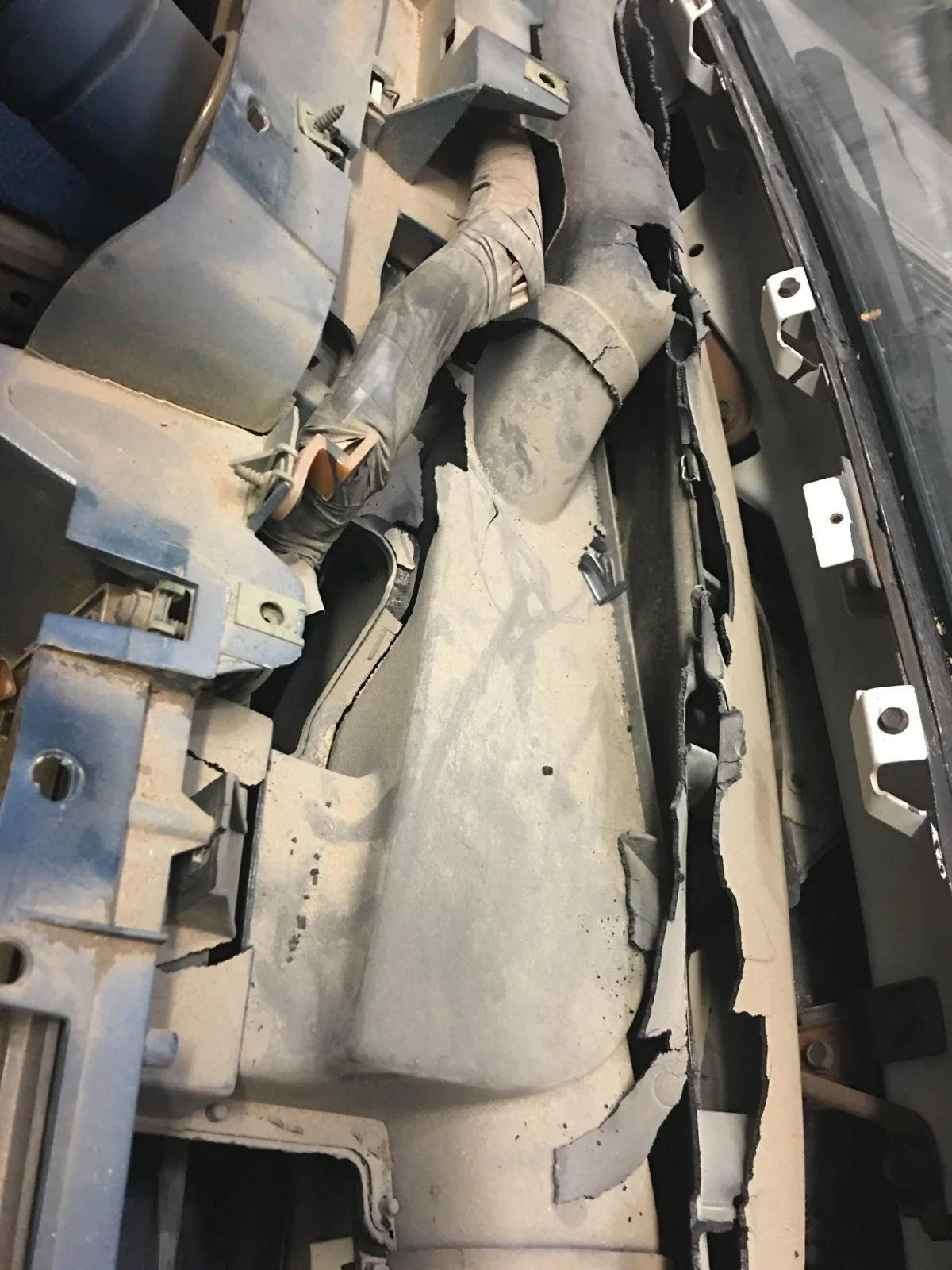

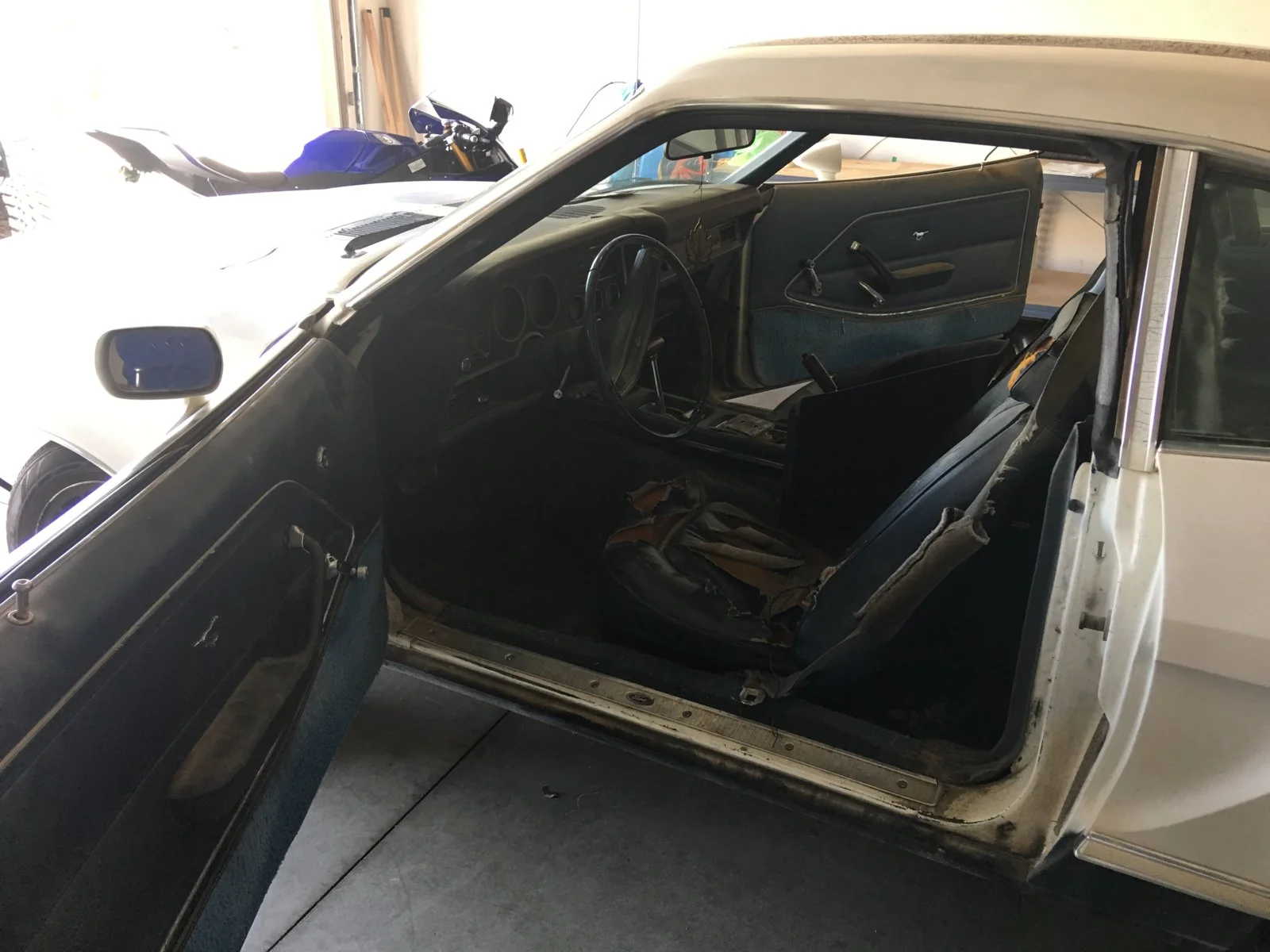

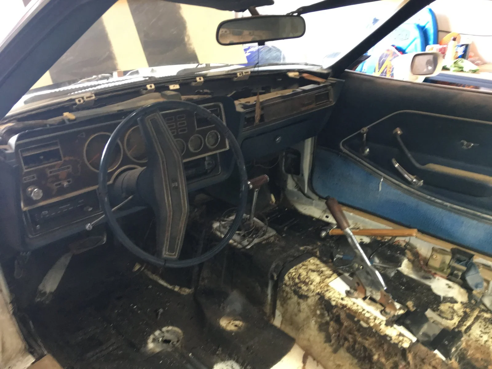

Everything under the dash is crumbling. The car has been sitting in the desert for the last 15 years.

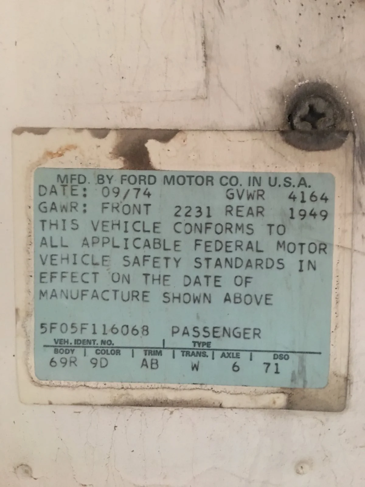

I can say with 90% certainty that it’s not a real MACH 1. Where would I look it up at?
It'll have body code 69f I think? I'll have to look it up when I get home from work. But it definitely has all the Mach associated goodies from what I can see....

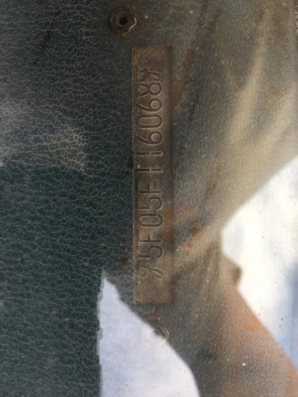

My VIN is 5f05f116068, but it’s got these funny symbols at the beginning and end, not sure what they are.

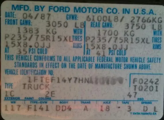

Those symbols are basically copyright symbols to the best of my knowledge. They would help prevent someone from creating a new VIN tag and attaching it to the dash.
I can't find my book, but a quick Google search yields a body code of 69R, not F. It looks like 69F is your run of the mill hatchback, including Cobras and King Cobras. There may be an identifier on the buck tag, but since I can't find my book I couldn't tell you without a search. 2blue is correct though, if you still have the door sticker on the inside of the driver's door, it will be located there. It'll look similar to this one.

I think
I think your right. My book has;
60F - 2 dr. 4 seater Notch back Base
60H - 2 dr. 4 seater Notch back Ghia
69D - 3 dr. 2 seater hatch back Base
69F - 3 dr. 4 seater hatch back Base
69R - 3 dr. 4 seater hatch back Mach 1

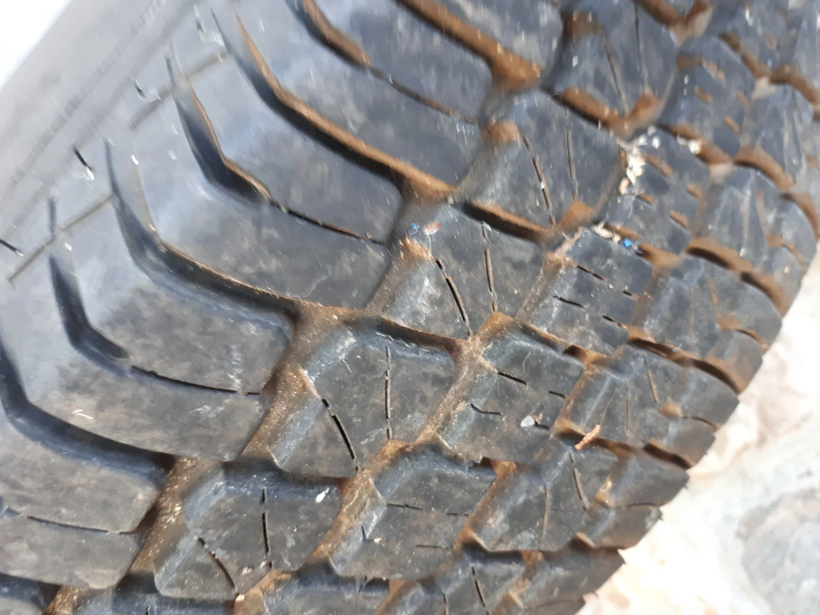

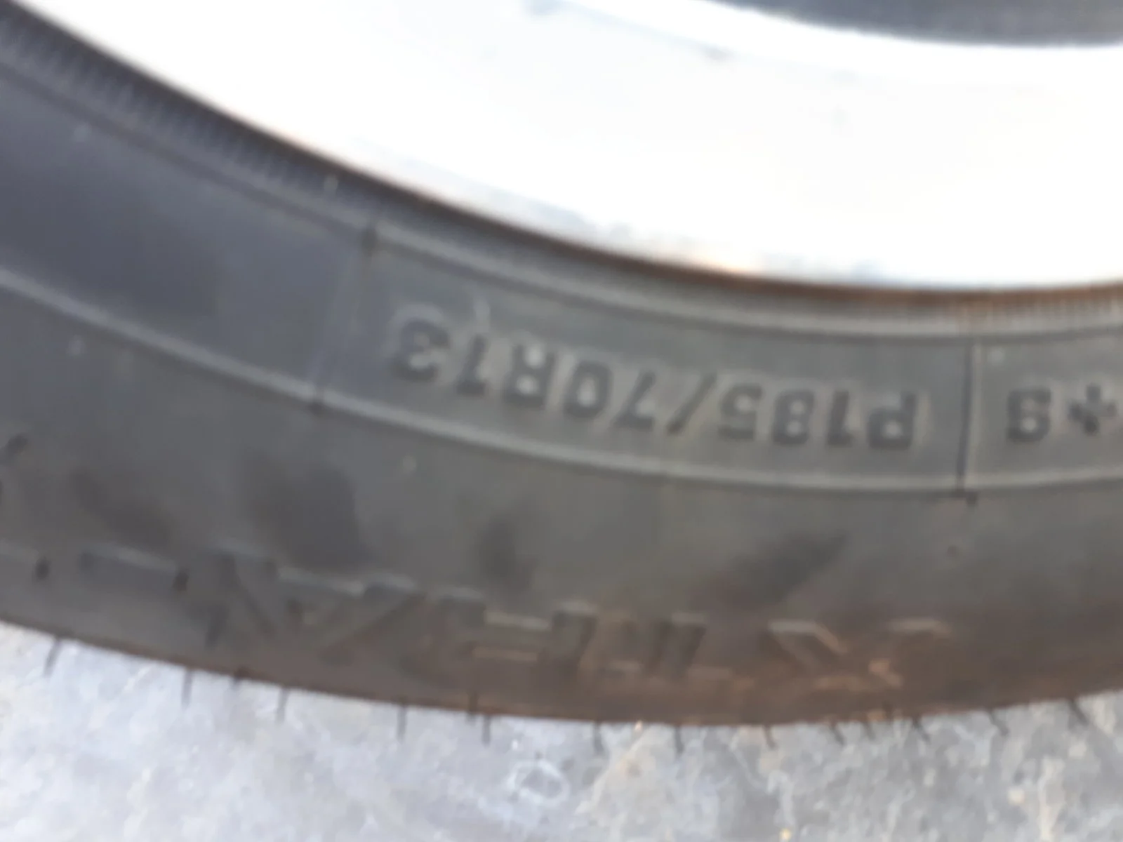

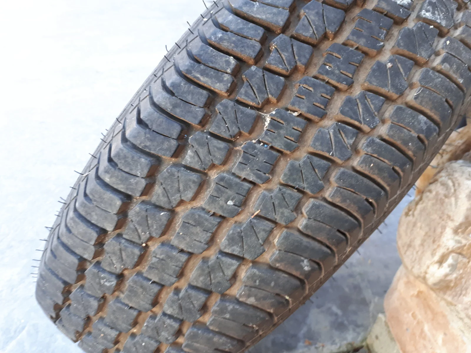

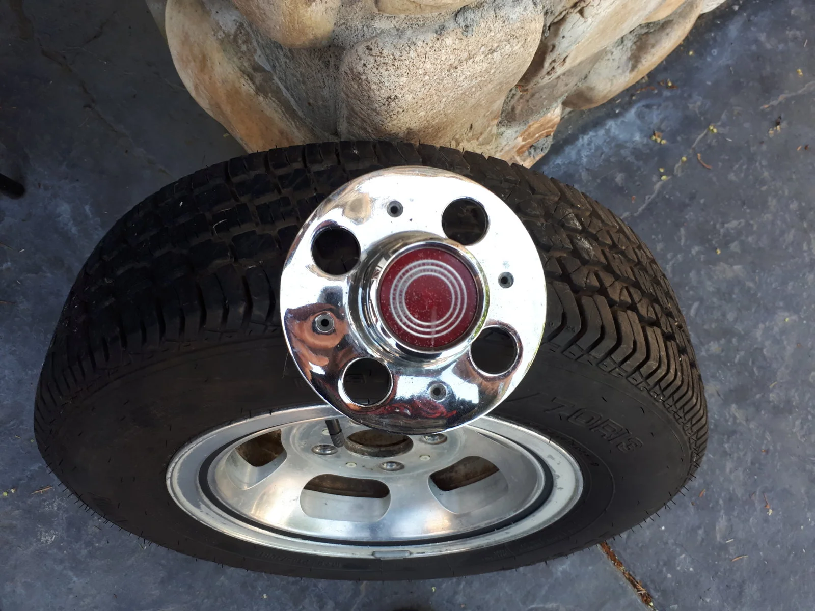

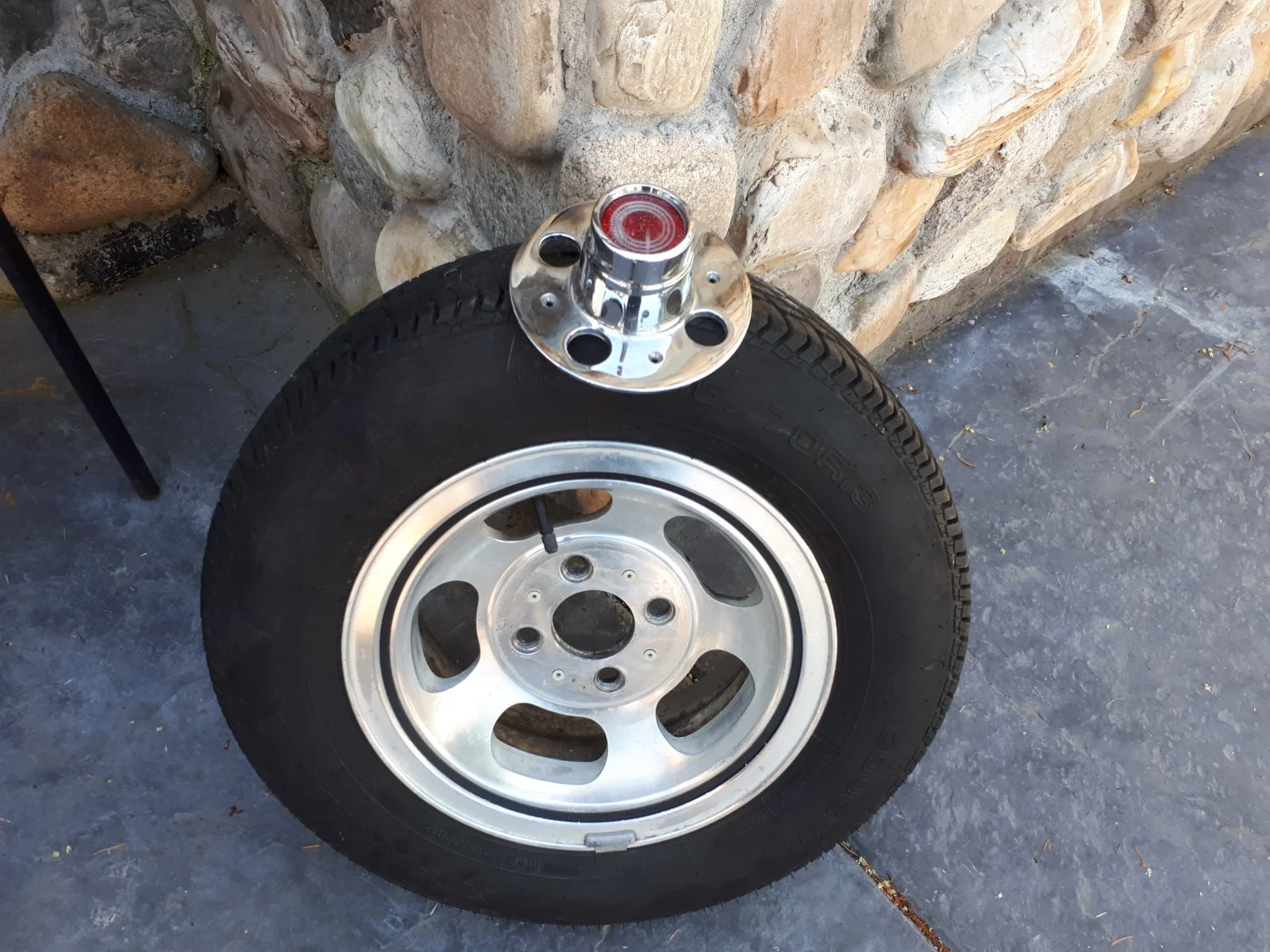

Too bad you weren't closer to me I have a full set of cobra wheels tires and caps in great shape. 13"
Reactions: 2Blue2 and Manoah
