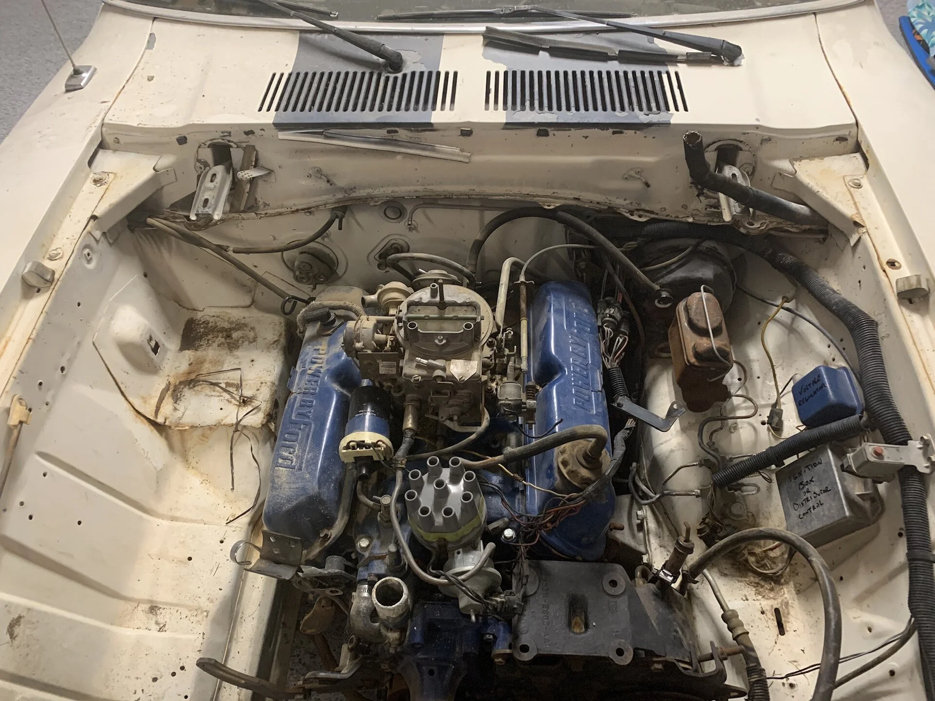

Prepping the motor for extraction.
Looking at all the options, I’m either going to build the 302 (have it built by a pro) or try for a coyote swap from PBH performance. If I stick with the 302, I’d like to switch my C4 out for a manual. My question is, what manual fits the best with the least mods, and is there a place that will sell a complete kit with everything I need to do the swap?

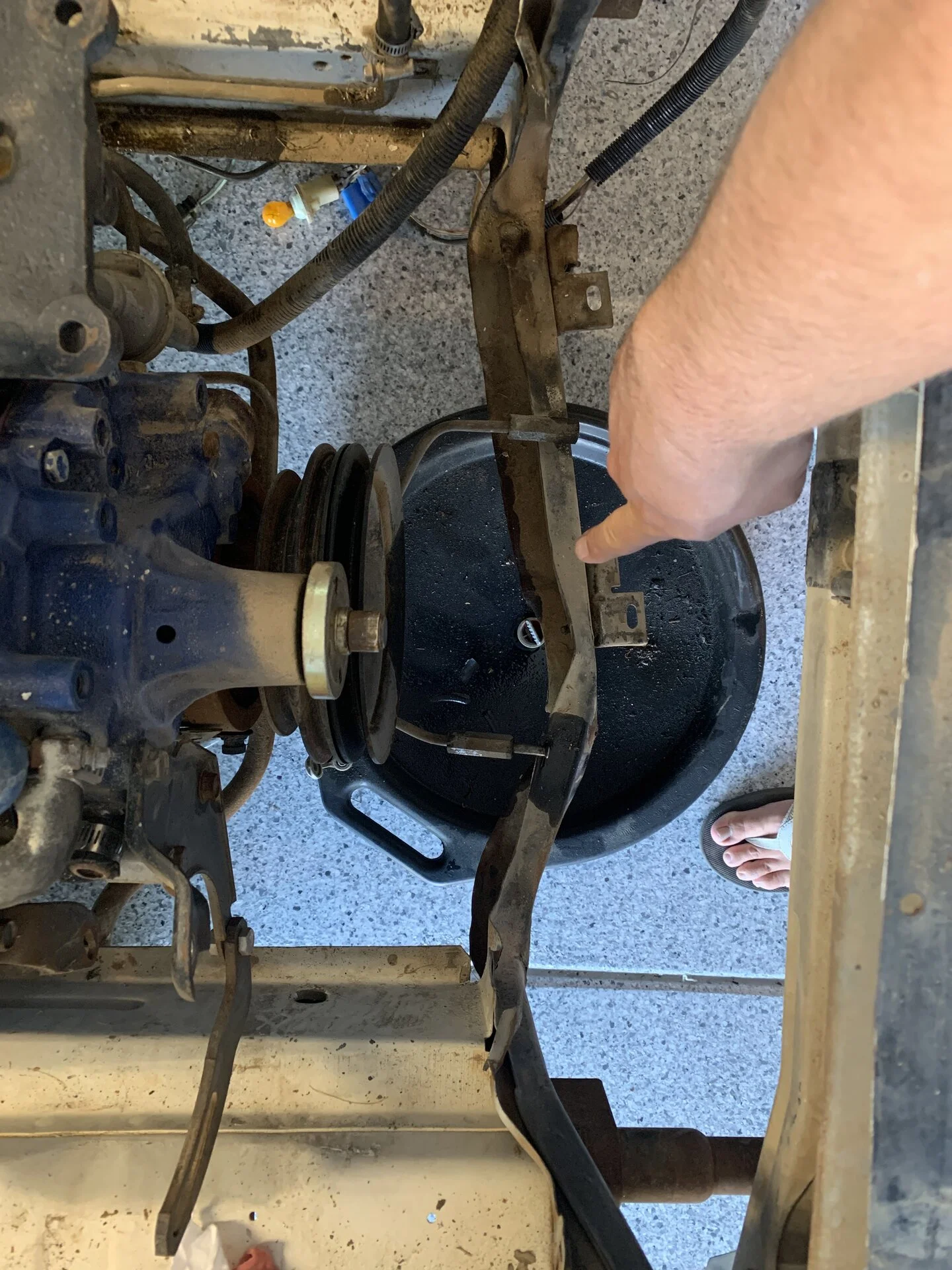

the bottom radiator support is trashed, and I don’t see an easy way to unbolt and replace. I assume the best option is to cut it out and re weld in a replacement? Or maybe just bang it back into place? What have you guys done with it? Nothing was bolted to it, can I just cut it out and not replace?

Looks like someone strapped a tow chain to it. :shrug:
I'd look into keeping it one way or another. Cutting/welding a new piece would probably be best, but I doubt you'll find one that's not screwed up in it's own way.
Depending on your skill set, you could cut the bent piece out, straighten it as best you can on the bench, and section it back in. You could probably use something to span the distance from one end to the other to clamp to and act as a straight line. If it were me, I'd look at cutting at the center center bracket (the one below your hand) and cut at the passenger side radius. The driver side looks pretty good from what I see.
Reactions: Enzio and Manoah
Cool car and interesting thread. I just read through it. You mentioned a couple of times that you are not a fabricator, so I'm gonna guess welding isn't your best skill. I know it isn't mine! You also mentioned that your wife has given you a healthy budget for this build. Maybe you let the body shop fix that support when you take it to get it painted?
Are you going to pull the engine and transmission out, strip the car and have the whole thing painted?
Def cannot fabricate anything, and I’ve never welded before in my life. Letting the body shop deal with that damage is probably the best plan of action.
