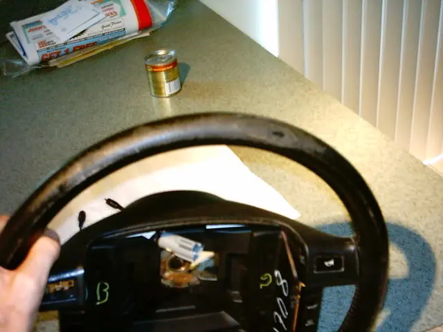

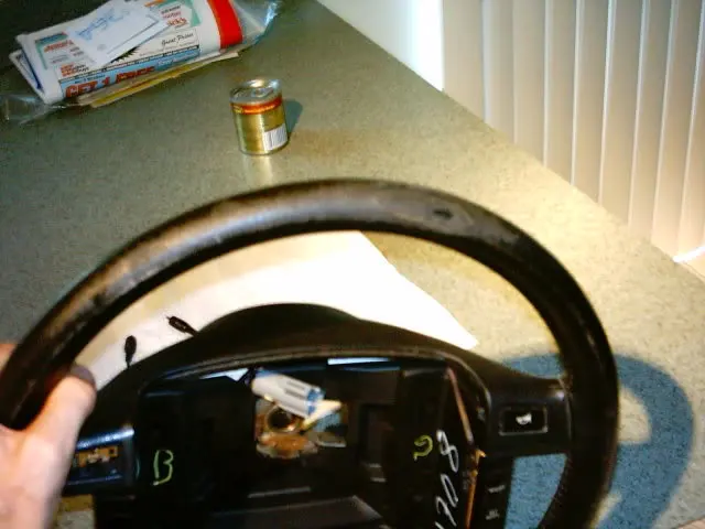

thats what happens after you do too many one handed turns. Its a bitch and im soo happy i converted it back to power, I would never have a stick shift manual steering car ever again i personally hated it
