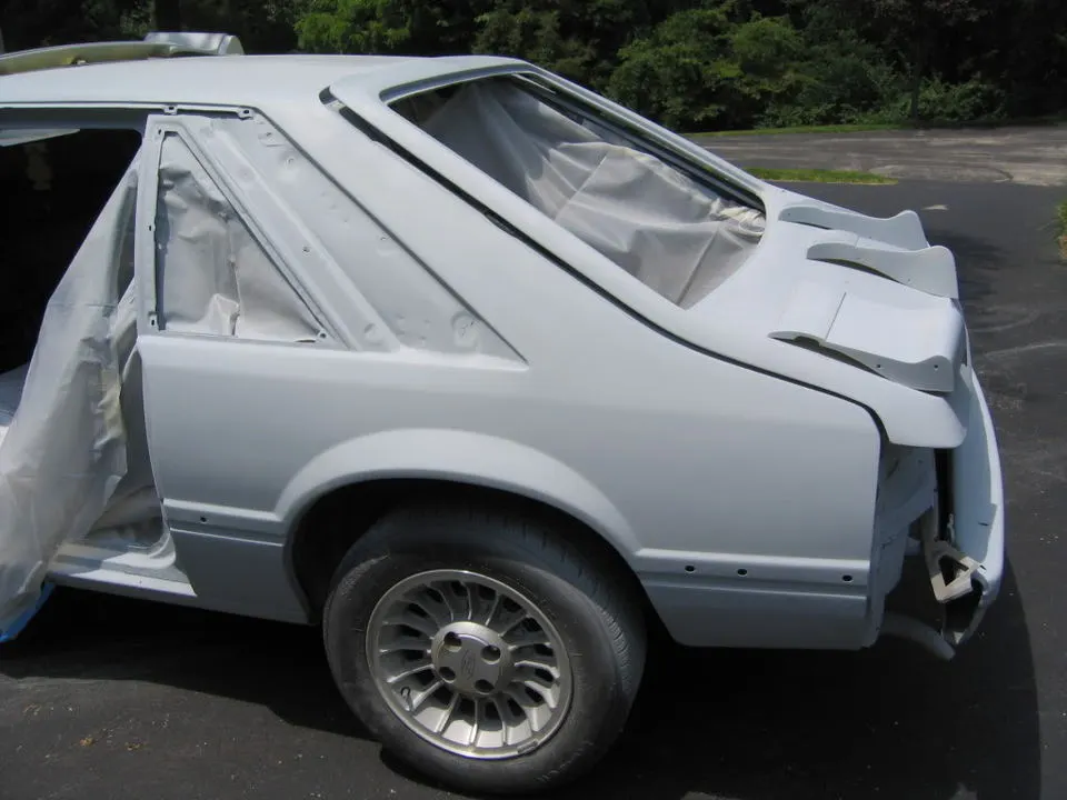

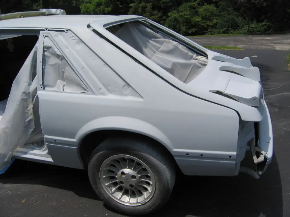

I don't see how you would ever do this based on the design of the rear glass. The actual view available through those quarter windows is like a 5X7 Triangle :)
I always wondered why the windows are so large compared to the visibility they offer, is there a place that sells aftermarket glass for this type of Mustang that is entirely transparent?
(Probably more logical to replace the window than mess with rolling it down)
Earlier fox bodies had styling trim installed aft of the window with a window that was set into the body. To keep the same quarter panels but make the 1987 aero windows work, the trim area and the window area were covered by the aero glass, and areas that were not appealing were blacked out. Transparent glass would not look good.
There isn't, and you wouldn't want to if they did :)
The quarter panel intrudes into the visible area. A clear glass would show the ugly panel underneath.
As you can see, the glass covers that rough looking area.
