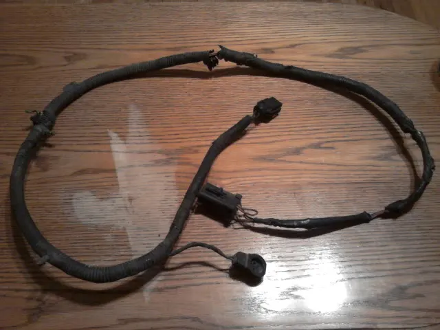

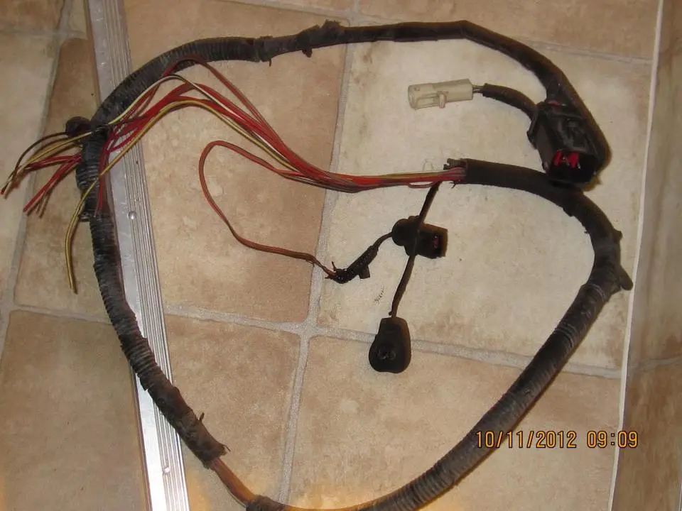

Well my Aod-e is taking a nose dive for the worst. Searching through the yards I found a 94 GT manual ECU, Pedal assembly, trans harness. My question? is if this harness is usable?
My confussion, is when I compare to the ebay pics, I haven't stripped all of the black plastic shield off. But, is that white connection necessary? can I use the stock AOD-e white connection +along+
with the harness above?

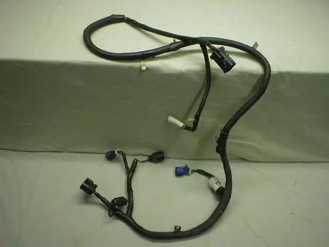

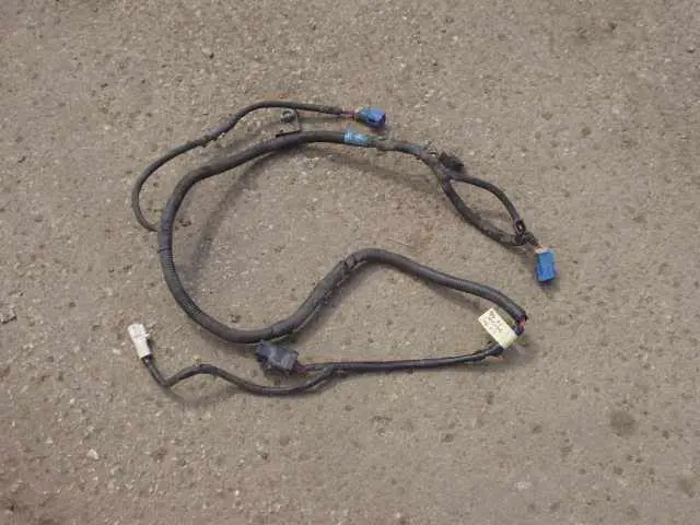

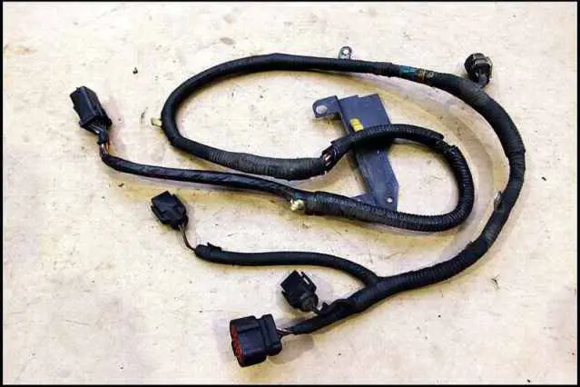

94-95 (and later years, i think) 6 Cylinder AODE and T5 transmission wiring harnesses have integrated O2 wiring.
94-95 5.0 have a separate O2 harness.
My picture, 94-95 5.0 T5 harness.
Found online, 94-95 5.0 AODE harness.
Found online, 6 cylinder T5 harness.
Found online, 6 cylinder AODE harness.

I found those posts (using aode harness rewiring, etc) a couple days ago. What also troubles me is that besides having the Mustang gt imprint on the back bumper (the car I pulled the harness out of), and also having an original cut on the shifter opening (it was neatlly cut, with all for bolt holes), the harness when pulled out was attached with those plastic push pins to a bracket and other wires.

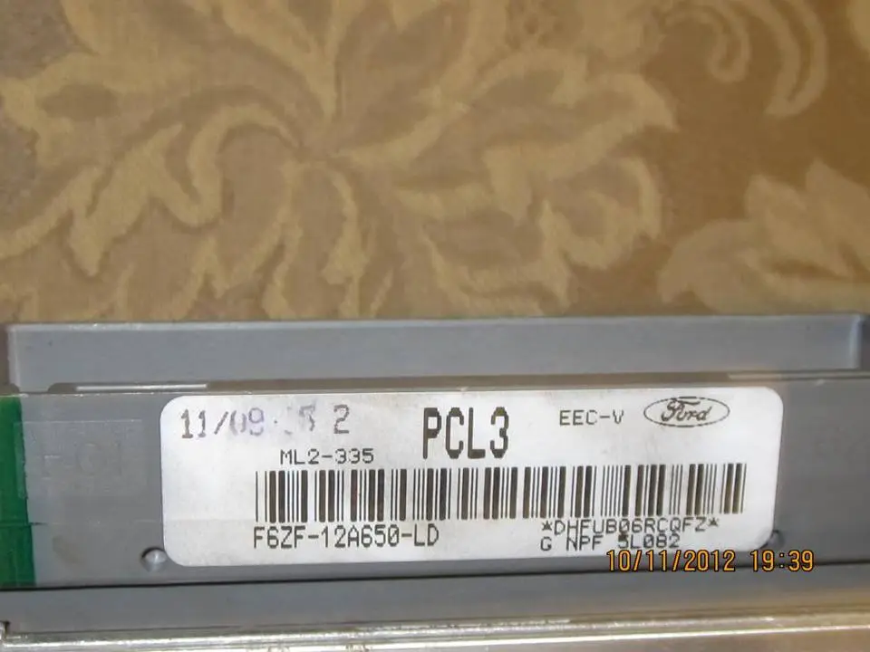

heres the pic of the ecm. I guess the harness is a lost cause.
In a pinch, you can re-purpose the AODE harness to function with the T5. You need to bridge the starter wiring and rig up a back-up light switch connector (looks like it might be ok in that first pic - can't really see the condition of the wires where they meet the shell).
The cruise control switches are different IIRC. Other stuff might be off as well, but the CC thing is what I remember.
