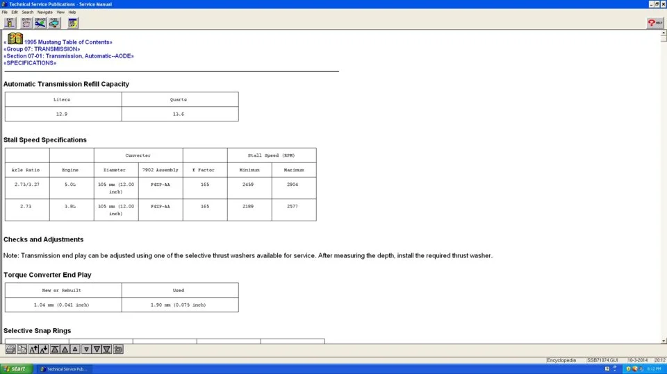

Ok one of my buddies told me a cheap easy upgrade is to put Mercury Marauder/ Mach1 converter behind my 302 for a higher stall, as they are like 2400 stall, which would be on point for my engine combo (306 with GT40 heads, explorer intake and a TrickFlow stage 1 cam which has a powerband of 2000-5500 rpm). Has anyone else done this? I found a used one with 30k miles on it too damn cheap to pass up! someone let me know so i can make my decision... Mine is a 1995 BTW.
You might want to reconsider your thinking. The Mustang AODE converter spec is between 2459 - 2906.
