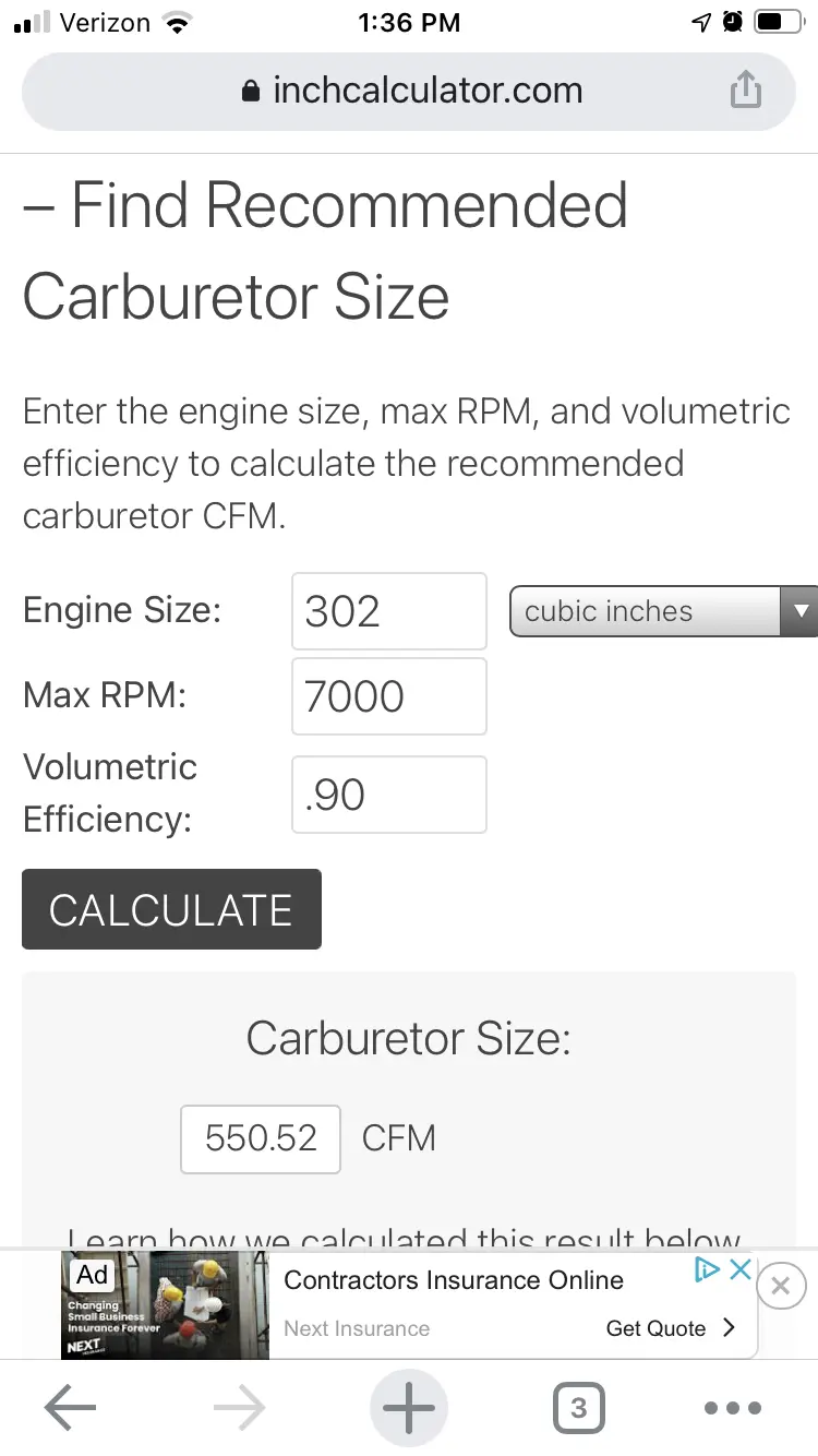

A 750 carb will not help power or driveability. Even at 7000 RPM, a NA 302 will not be choked by a 650 carb. Nitrous, a turbo or blower will change the VE, but with awesome heads and a carb, it will not go over 100%. 90% is not a bad figure for a streetable, prepped engine. Have fun playing with the calculator.

My old motor that's in it right now was from another guy, which had the Proform 750 carb on it, at one point was running a 100-150 shot nitrous on it from what I'm told, and I figured it would be too much for a given street driven 302., probably wash the rings if anything, took that off and put the holley 650 on it, just saying I have it as spare just in case, but highly doubt I'll need for this setup.
