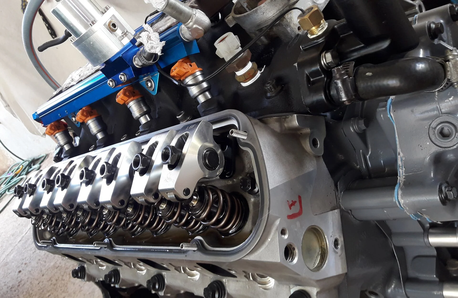

I bought cheap ..flotek 185cc with 58cc chamber,....ported them and upgraded the Valve springs with a Set from Alex parts.... i run these heads on my 331 with F Cam,...and sometimes with a 75 shot of nitrous ..AOD trans and 373 gear... not the best for shure .. but they work pretty good .. with Stock GT 40 Intake the Ports on the lower Intake are too small and Engine starts to loose power about 5600 rpm ....my Mustang is a 100% street Car but runs 12flat at the Street with Nittos.. ** Dragy Time** at the Track with better traction, it will go for 11s for shure...

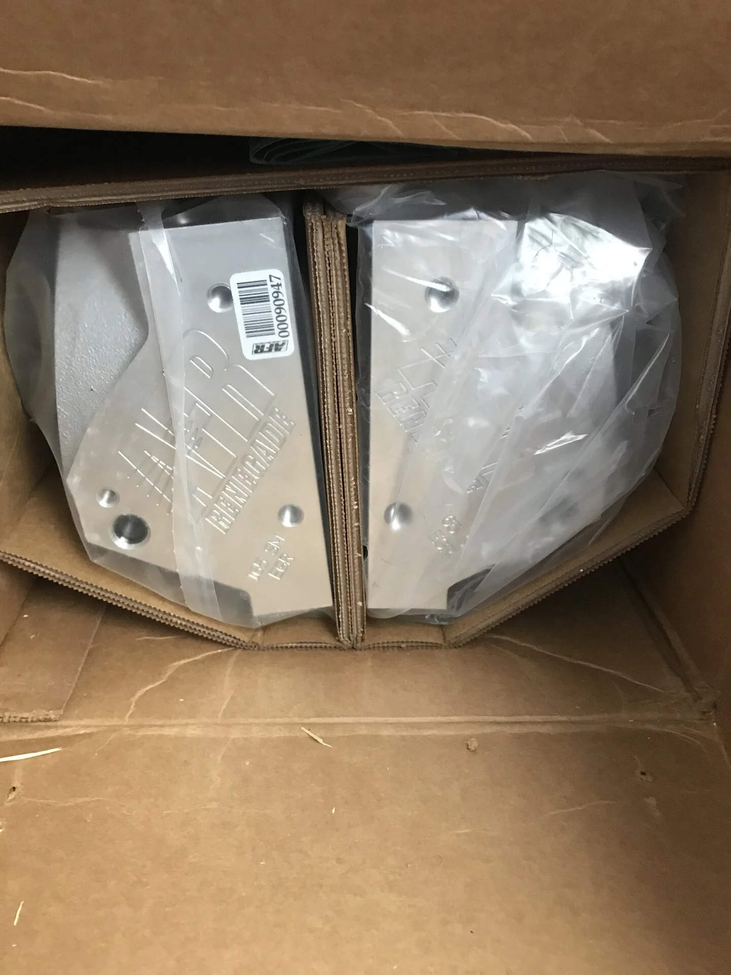

Well guys, I finally bit the bullet and bought the AFR Renegade 165 #1402 from a AFR warehouse distributor that had a decent portion in stock instead of the 2-4 week delay and finally came in the mail this afternoon.
hopefully, this will give the stang a nice bump in power from its old E6 head/ cammed setup, I appreciate all the input and recommendations guys, really, thank you.

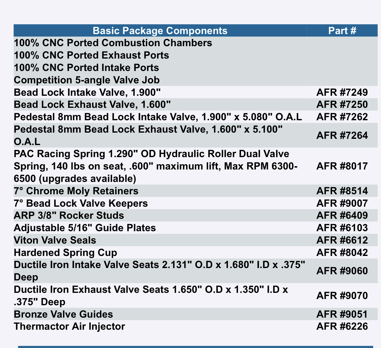

side note, would you think I should upgrade the 1807 springs and switch up to 7/16 studs as well or should I be okay with what it came with, I have the specs of it in the pic below.
