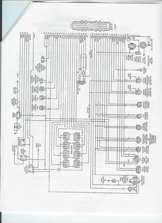

I scanned some stuff for you guys. These will prollably help if you havent finished converting.
