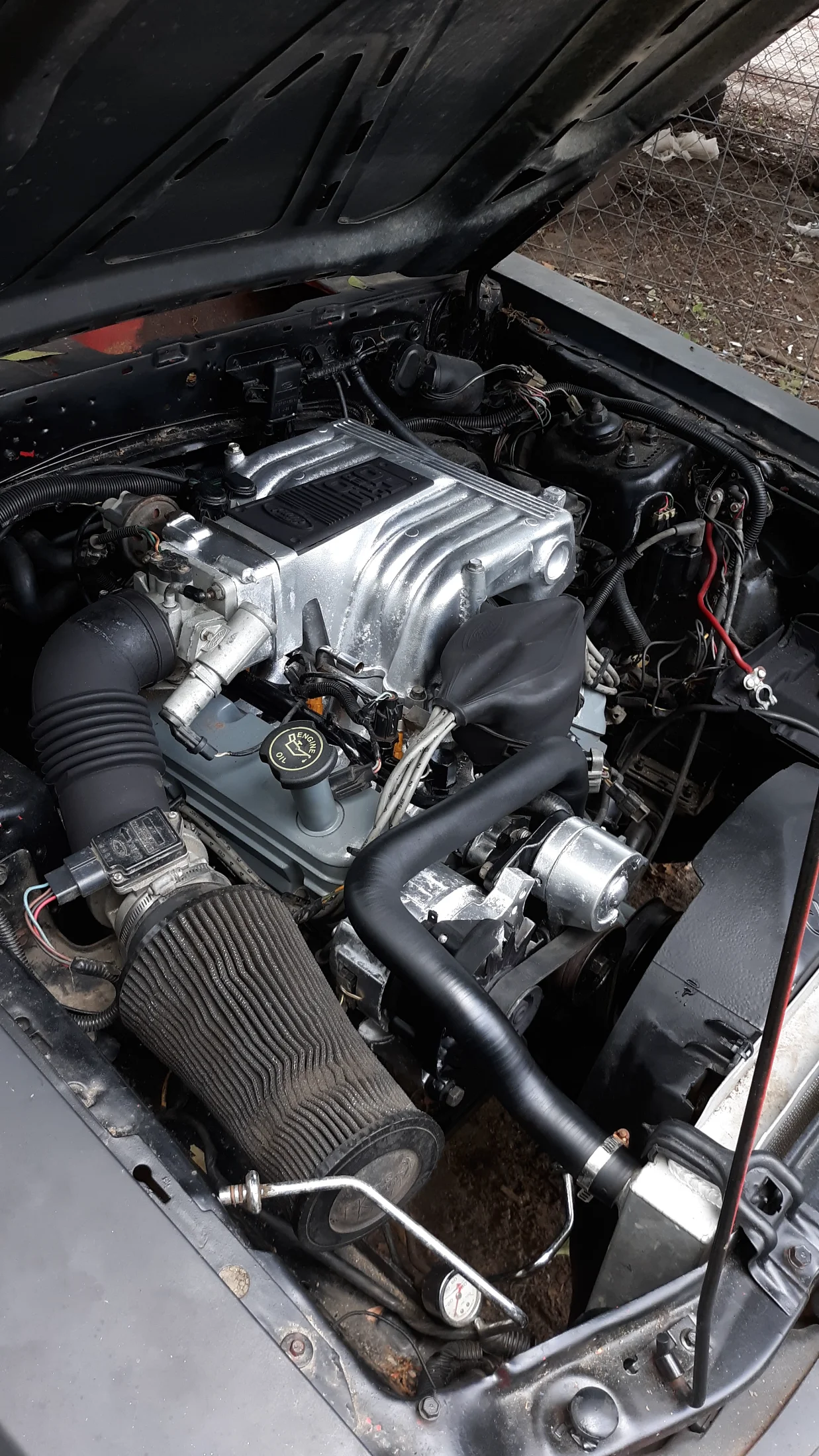

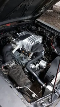

I know this is a ancient old thread but I wanted to make a post saying that 2yrs ago I accidentally put together a stock shortblock 302 with the stock HO camshaft and it makes over 330rwhp with only 2 major parts changed on the engine.
A set of 11r205's that were decked to 50cc chambers and a Explorer intake with the lower intake hand ported by me. What's more surprising to me is how much power the stock 55mm mass air meter, 19lb injectors and 60mm TB supported the airflow to make this much power.

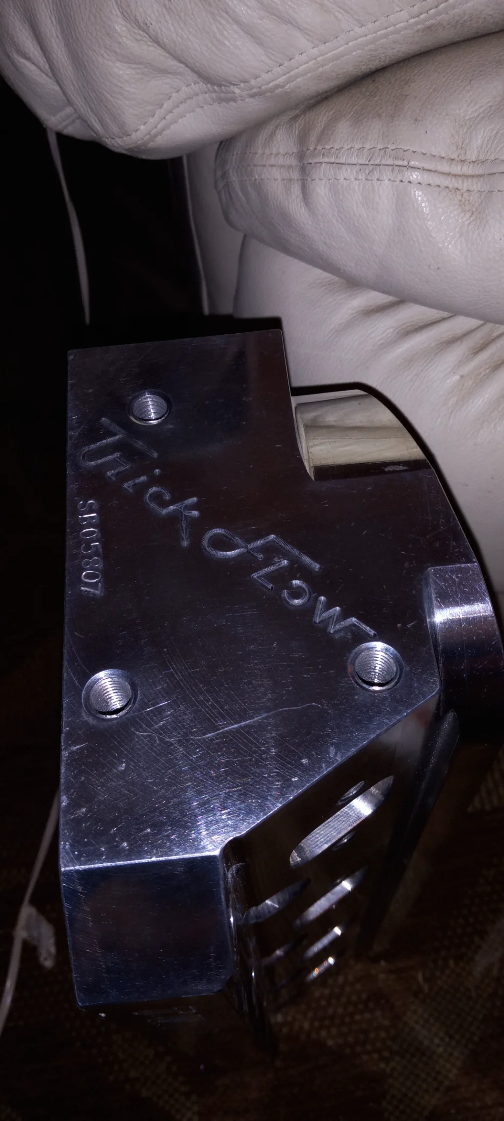

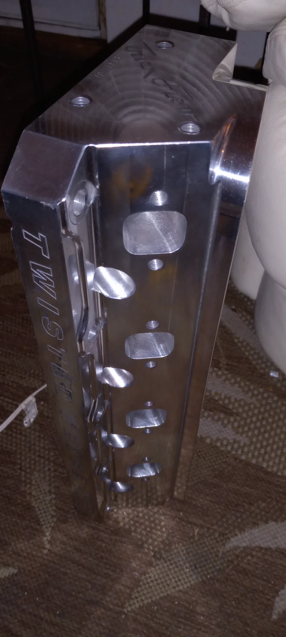

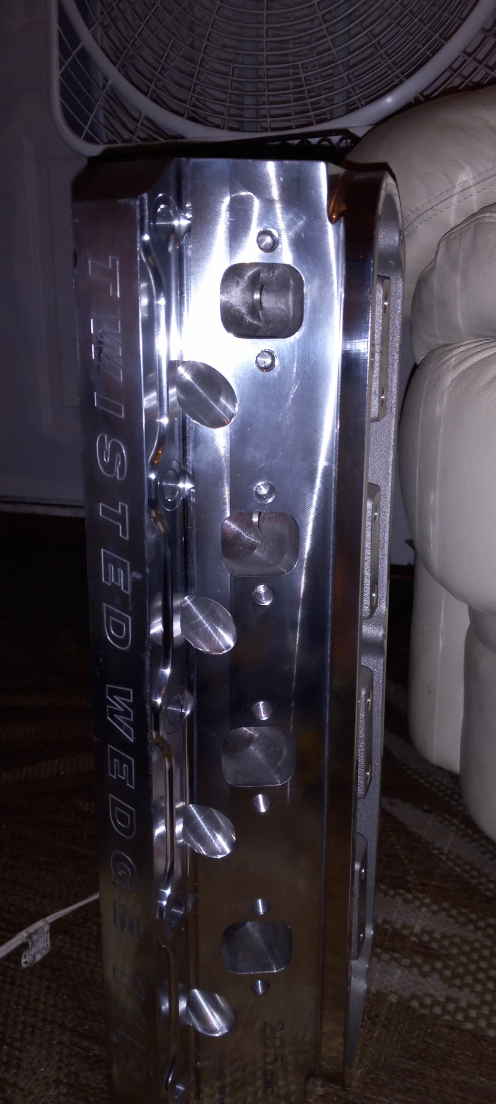

Well.....i kinda did...lol. It all started with the heads. Found them on Ebay bare like you see them as they arrived to me. They were labeled USED by the seller and was a bid action for them. The really funny part is there was ZERO bidders! The starting bid was $900 so with 10 seconds left on the auction to end i bid $925 and won the auction.
Now I had i set of heads that I REALLY had no intention of buying so I had to put them to use and the Explorer intake was the only other aftermarket parts at had at the time.
I was damn sure it would be weak as hell with the stock 55mm mass air meter and 60mm TB but I was wrong! I was totally SHOCKED at how much power it was making ESPECIALLY the torque! Everyone that has rode it swears it has 3.73 gears as easily it boils the tires in 1-2nd and it has 3.08's. Drives TOTALLY like a stock cam 5.0 mustang except with 150 more HP and 50-75ftlbs of torque.
