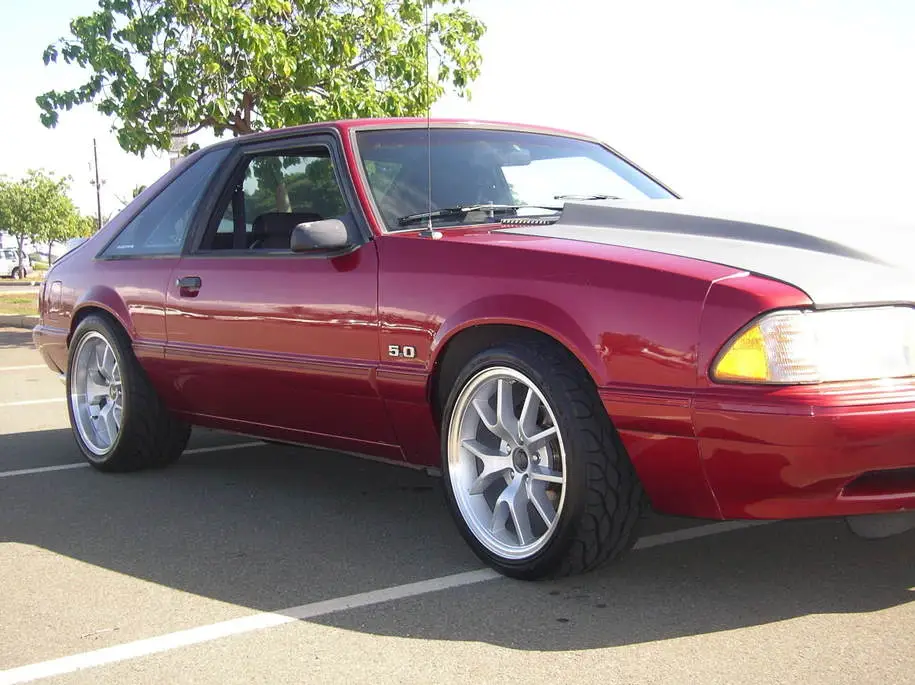

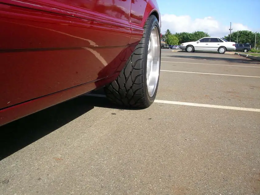

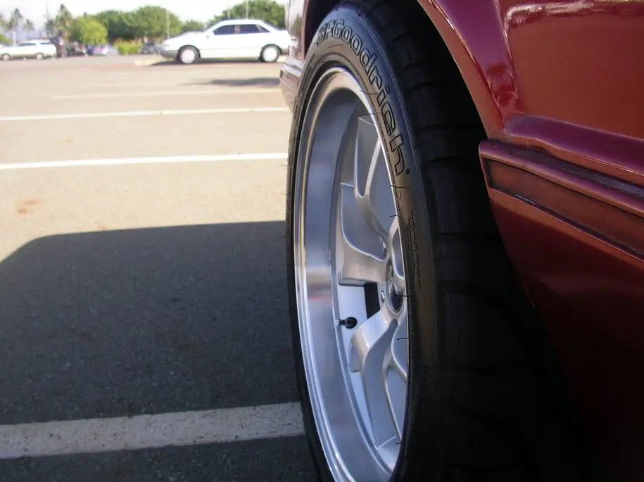

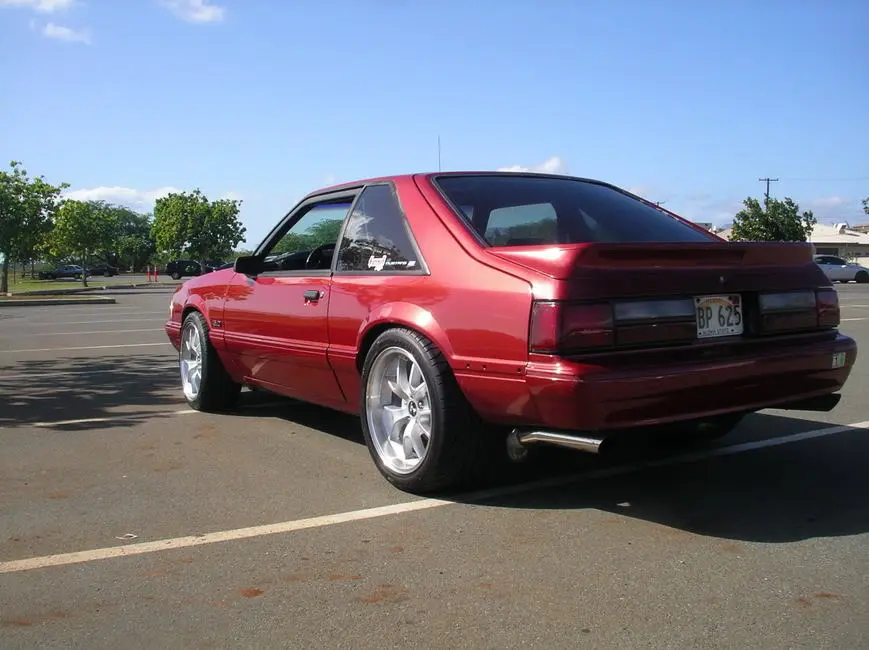

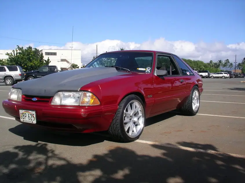

This was posted on Corral.net a little while back. thought it was funny cuz its very similar to your car. Wheels look amazing, probably my favourite affordable rims for a fox-body.

hemi_fan, that car looks great! Just think Black FR500's would be more to my liking. Thanks so much for those pictures, do you know what the owners name is on corral Id like to ask afew questions.
Shakerhood- they have been off as long as i have had the car and there is NO wheel hop at all.
Mustang5L5- Thanks for the info, but after seeing those pics hemi posted there must be a way.
Owner's name is 'stangmanr'.
18x9 255/35/18
18x10 295/40/18
Brake system/5-lug conversion is completely from a 84-86 SVO, and the spindles are from a 91 explorer if im correct.
There is some small rubbing on the rear tire. so i need to put back the stock springs, because i have the BBK drop springs.
from what i know, there was no modifications done, just rolling of the fenders to the max. But the whole setup was from an 84-86 SVO mustang, brakes everything. But on mine, there is some minor rubbing, only when i hit big bumps. So i need to put back my stock springs at the rear. well if you have more question, ill try and answer them. Peace
Jason
I asked him some questions when I saw those pics cuz I really want to put those wheels on my GT. those are his answers. Nice guy. I've read a ton of threads with guys putting 10" wide wheels on their mustangs. The 10" pretty much guarantee that you will need to roll the fender lips, and depending on tire size you may need to 'modify' the inner fender with a hammer. You can get a 10.5" wheel on apparently, but it takes a lot of fender 'modification' lol, and you'll probably have to run dumps because it'll interfere with exhaust.
