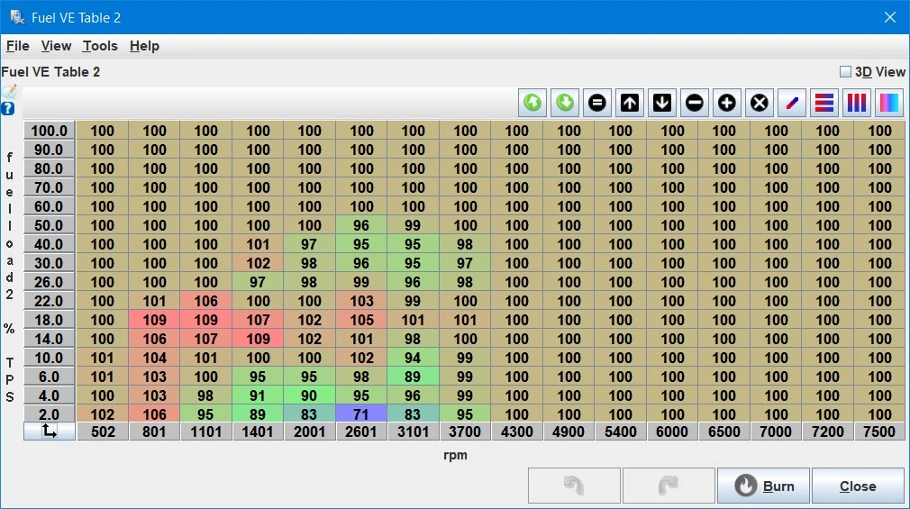

1. 2. 3. i dont use veal to tune the secondary fuel table, it is used as a trim table. that said you should be able to make it work as described above.
4. Alpha numeric = tuning based on throttle position vs rpm
5. this allows you to add fuel based on throttle positions that are outside the norm in MAF, sometimes the MAF will be in an area of the VE table at differing conditions and will give 2 different fuel feedback loops, adding the second fuel table and making it multiplicative solves this issue.
6. I had the table setup to work with your settings you essentially made the ranges in the table useless. think about the throttle potions, 90% of your driving is done below 20% TPS postion.
hybrid alpha-n is throttle position*map on the y axis giving you a larger range to tune with. if it is the only tuning algorithm you are using.

1. 2. 3. This is what you described above: "This time i left the MAF curve alone, I think the huge VE numbers wont be seen again. I am also going to create a second fuel multiplier table for you this way you can tune for throttle position as well.
I am asking, how do you tune for throttle position?
4. Got it, but nothing alpha about it; it's all numeric, i.e. voltage and/or counts.
5. I see now; I wasn't thinking.
6. My bad, glad I asked.

The second fuel table is something you will use to adjust for odd throttle angles. I will show you how to build a histogram using a datalog for manual trimming.

I understand what VE2 is used for, just not how to use it.
I've never built a histogram using a datalog for manual trimming.
Then how does the histogram get back to VE2?
I tried loading a datalog, removing optional Z-axis removes all; guess it's not optional?
Maybe load Z-axis with VE2 or VE Trim 1 or 2 or...?

I let AutoTune correct the VE2 Trim Table.
