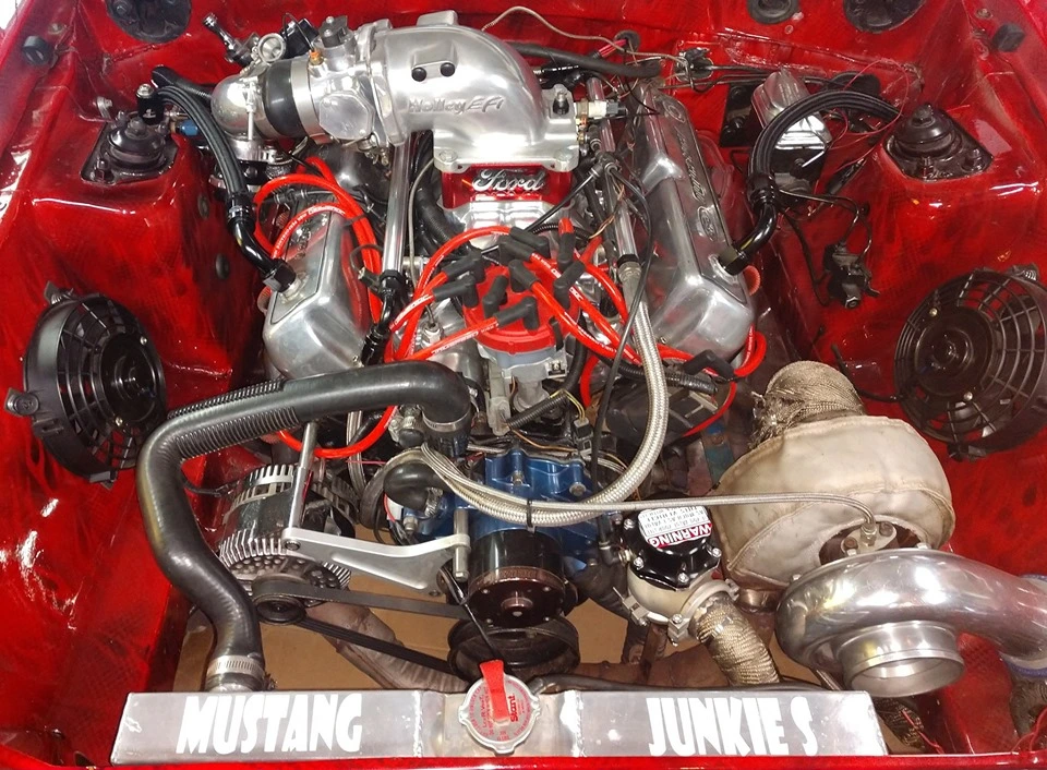

also heres a picture of what medusas running i know its not a description of parts... but you can get a pretty idea from the pic that Shes a beast
