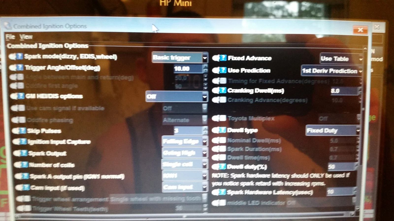

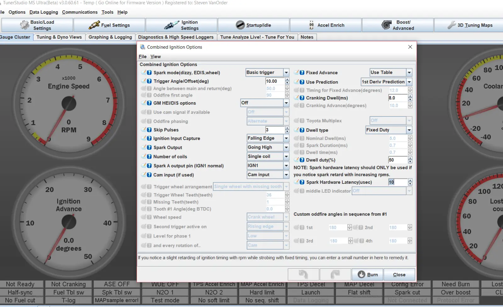

ok so the timing is retarding with load, have you set the latency? this is one of the first steps that must be done so you do not have timing retard with increasing RPM. Its one of the things covered in the big ass tuning manual most people dont read, but its an easy fix.
The entry that says Spark Hardware Latency... start with a value of 200 and have someone strobe while you increase the RPM to see if the timing still retards. adjust the value as needed. [ I have gone as high as 1200]

Follow my instructions above, it is covered when you highlight latency. The system designers assume you would read the manual... or find an issue like you have and ask the question, now that you know what the car is doing and i have given you a solution the only thing left to do is fix it.

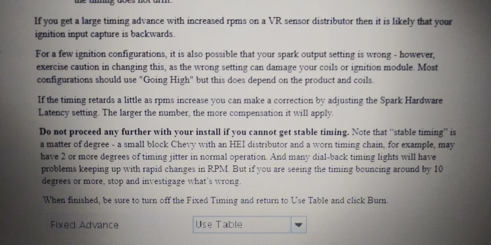

Id like to kno exactly what giant maunal that they explain spark hardware latency settings due to retarding timing.. Cause im lookin thru the tonnes of manuals and info i have on ms and i cant seem to find this information.. Also this is the first time ive heard that one of the first things you set up is spark hardware latency settings due to the megasquirt retarding timing that much.. If this info is so plentiful then how is it ive never read it or been told it.. The pic is the only info that i can find and its far from detailed..

It is in the manual, and its description is short and concise just like the info note its given in the ignitions settings menu.
If you notice the timing wander or retard with increasing rpm then you have one of two things happening, the latency needs to be increased or you have a mechanical problem.
The manuals would be 10000 pages if everything had lengthy explanations.
Bottom line is it's there to deal with the issue at hand, or the setup is mechanically to blame. To make this clear it's not a problem with the Ms, latency is the time it takes for a command given to be recieved. It's like a delay some systems have more than others.
