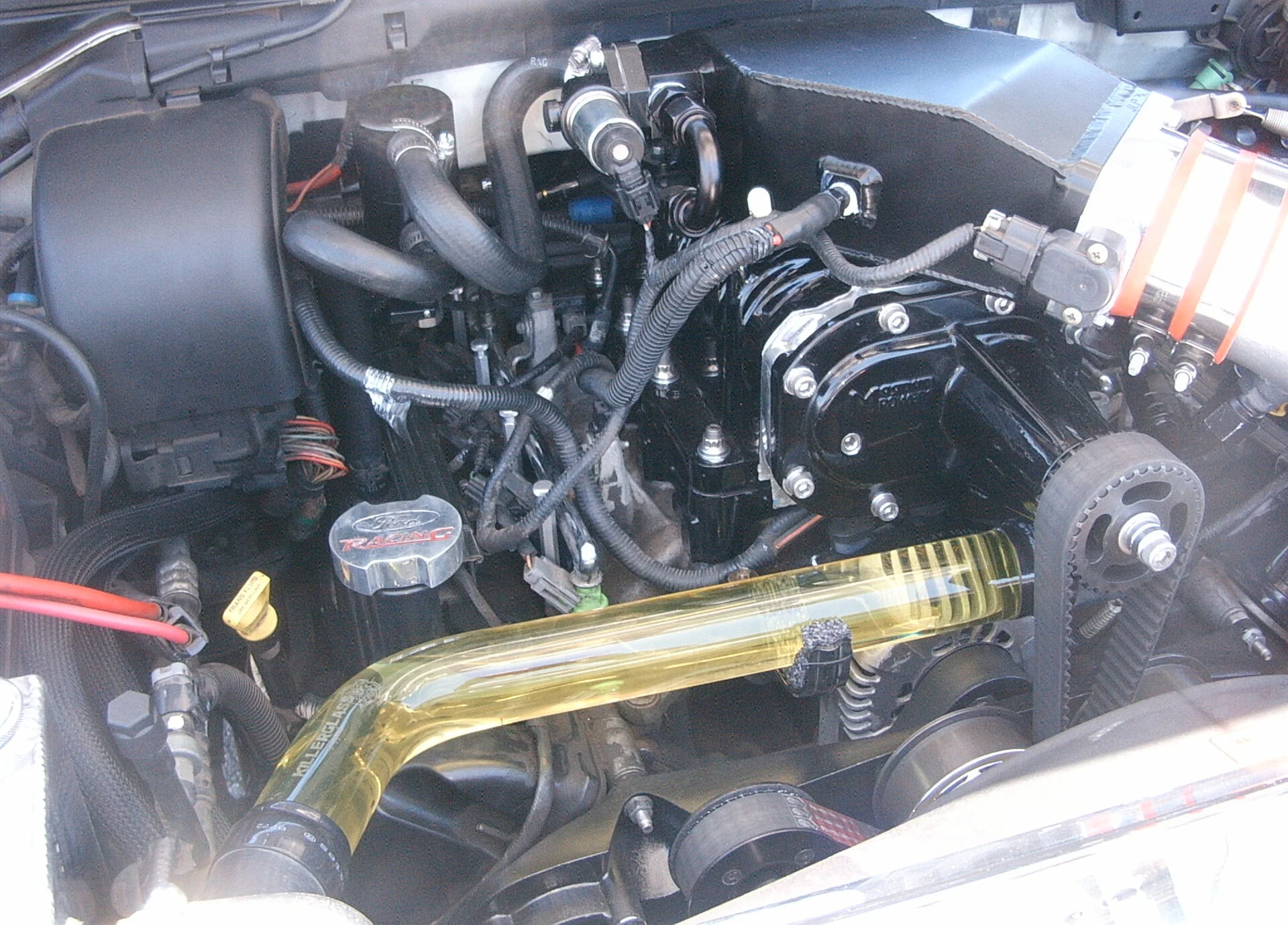

KillerGlass makes a nice upper radiator hose for the V-6 Stangs. I have on in my Lighting. May just go ahead and order one and wait for it to complete the installation. https://killerglass.com/automotive/ford/
