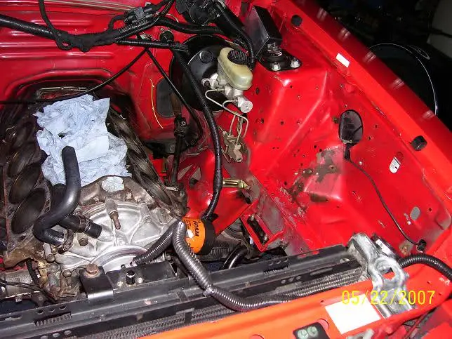

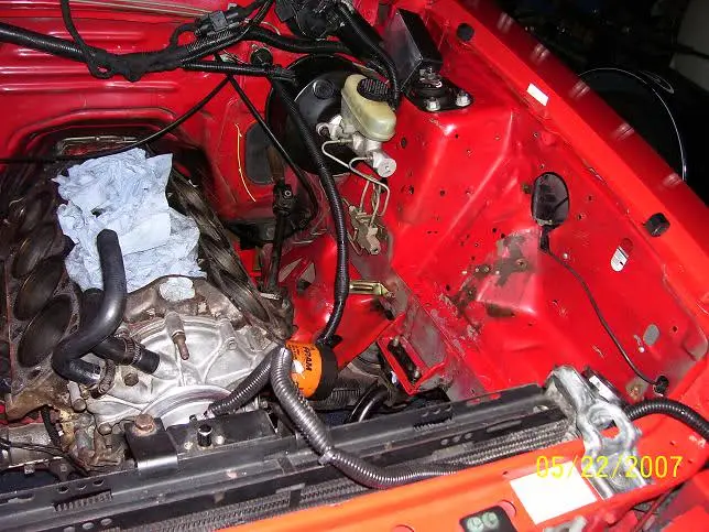

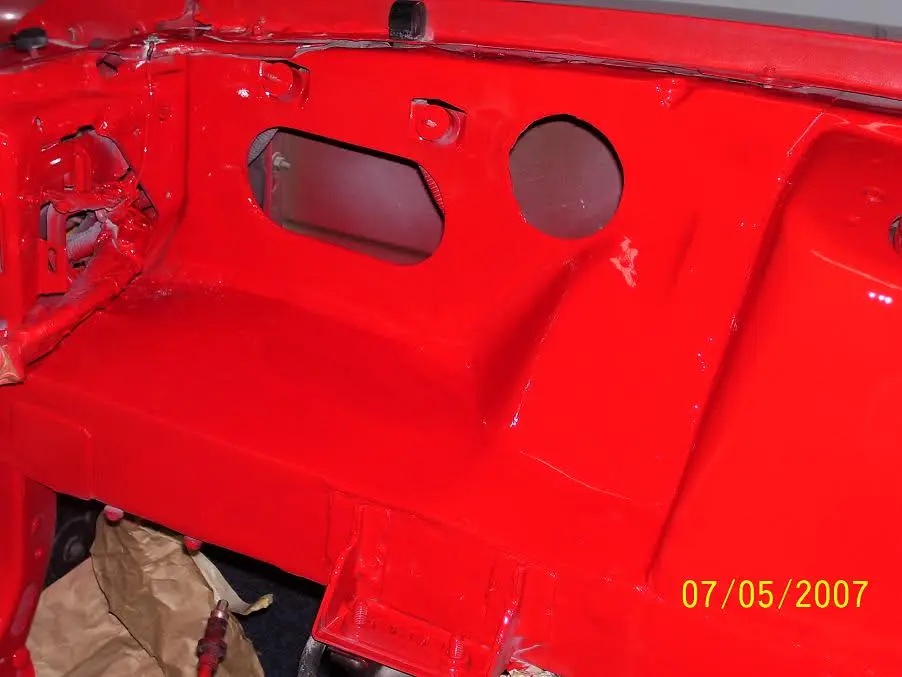

Heres a nice one:

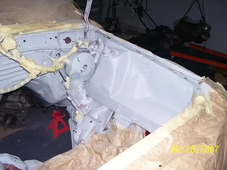

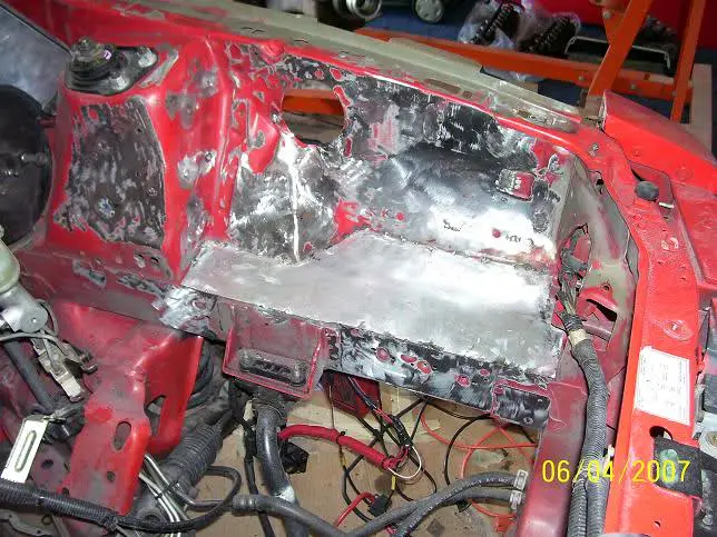

Here is a little sample of what you have in store. I do not recommend using bondo to fill the holes, just use it to smooth over your grinded welds.

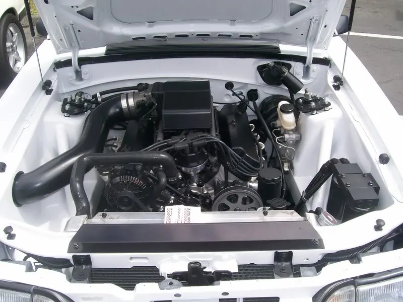

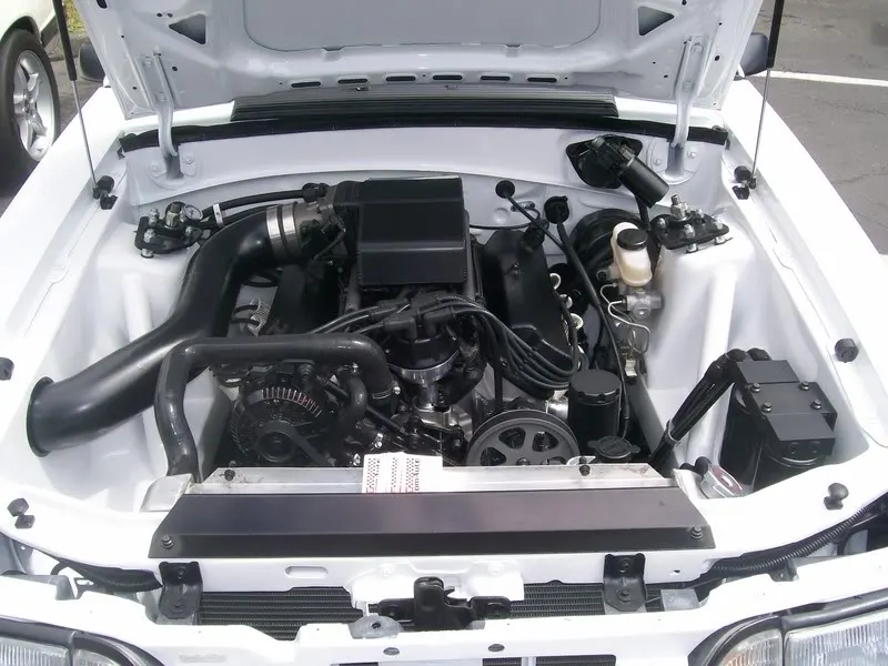

I have painted the bay, but will include a better picture of it when I get some natural light. The PPG paint and clear I used is so shiny that it glares and reflects the camera flash , And make it look like "jell-o" in the picture , as my wife says.
