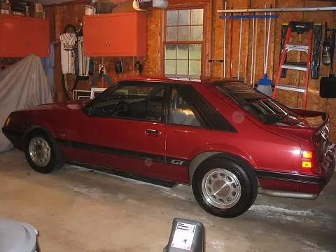

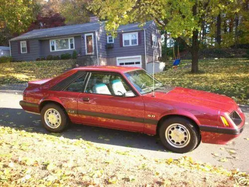

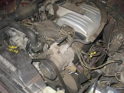

I understand however 3500 for a near mint all orignal 5.0 with 54k miles?Heres pics

our 230k 86 gt is cleaner then that under the hood...and the fan cover looks to have markings from a junkyard...id check and make sure it wasn't in an accident recently.( car fax craw under it ) exterior looks very nice as well as the interior...imo its worth that even if it was in an accident
Are you sure that the mileage isn't 154k? Look at how crumy the motor is. There is a leak everywhere as well! That could be a 154k car with a new paint job bud. I just don't want you to buy it thinking its 54k original miles. Are they documented miles? I would def check car fax. It does look nice though. If your buying a Fox for the motor buy a '89-92 5.0. '86 is not the best 5.0 motor, actually worst in my book.

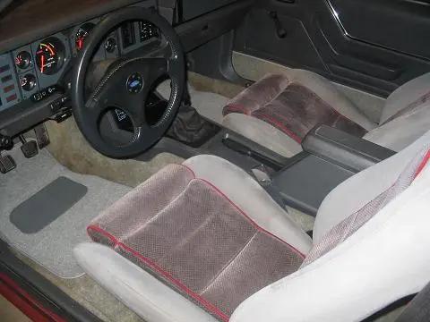

Honestly that motor looks exactly how it should for a 22 yr old car that has propbabbly never had the engine cleaned. We have cars come into the dealership where i work w/ 400 miles on them and they look like ass. We have an 05 mustang Gt w/530 miles on it and the engine is filthy. Hell my engine bay is dirty and i never even drove my car yet. Hell you can tell just from the interior alone the car has lower miles. The seats arent twisted, The door panel isnt wavy around the edges, the consel isnt ripped on the pad, The seat belt still stands straight, the carpet is really clean as are the seats.

Dont listen to Ryan about the junkyard fan shroud either, if he could read he would realize that they marked what temp the water was mixed to, and what date they did it.
