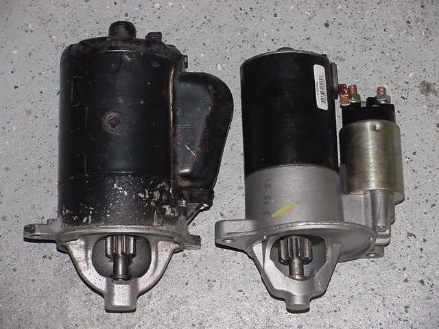

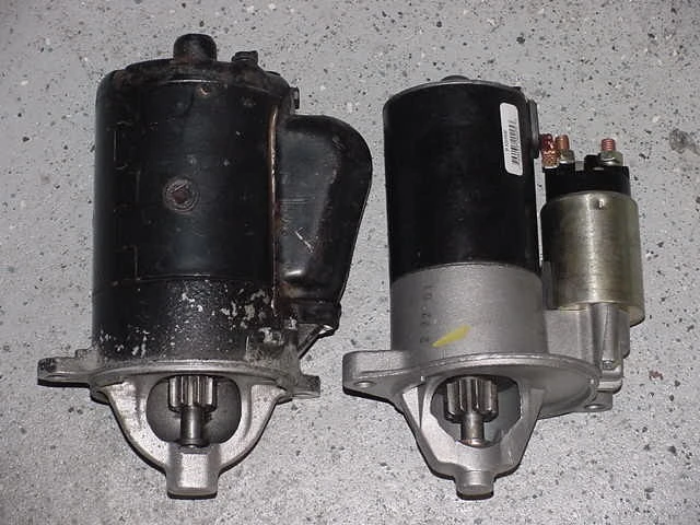

Old starter on the left. New starter on the right.
I'm not sure when, exactly, they went to the compact starter, but I do know that '89s had the old style and '93s had the new style.
