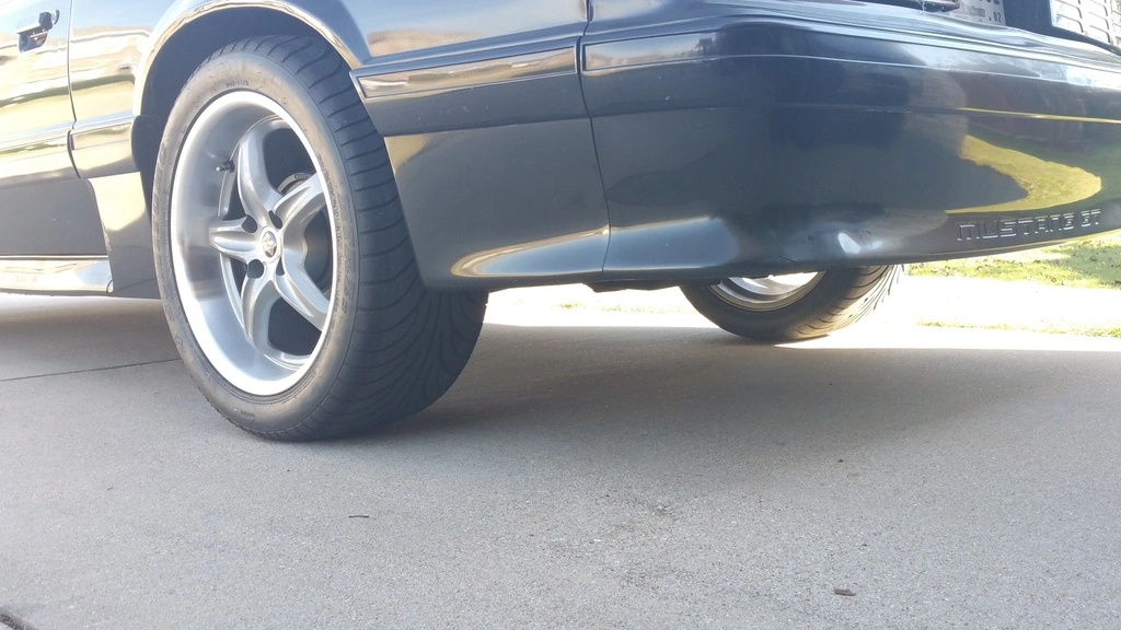

This is the only image I could find with old tires, they were 275 35 ZR18. Look at that gap! Horrible. I need drop springs, but then i might get rub with those...
I run 245 40 ZR 18's up front btw. They rub a hair on big bumps and sharp turns in reverse.

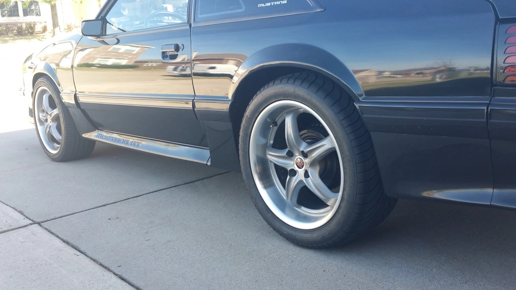

You can run a 275 tire. I do and it's a really wide fitting drag radial. So if you run a standard radial it will be more narrow. I purchased a panhard bar because it rubbed on the stock tubs during hard cornering.

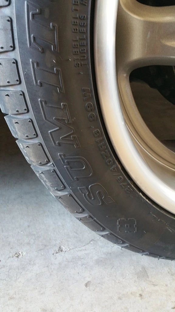

Your tire size should probably be 275 35 18. This size is really close in height to the original 225 55 16 tires.
275 40 18 is about an inch taller.
