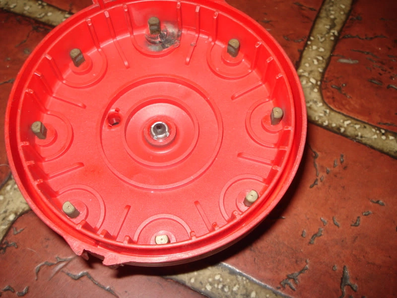

I checked the cap... found a burnt spot on a different plug.
So i changed the cap and rotor out and took it for a spin... More backfires.....

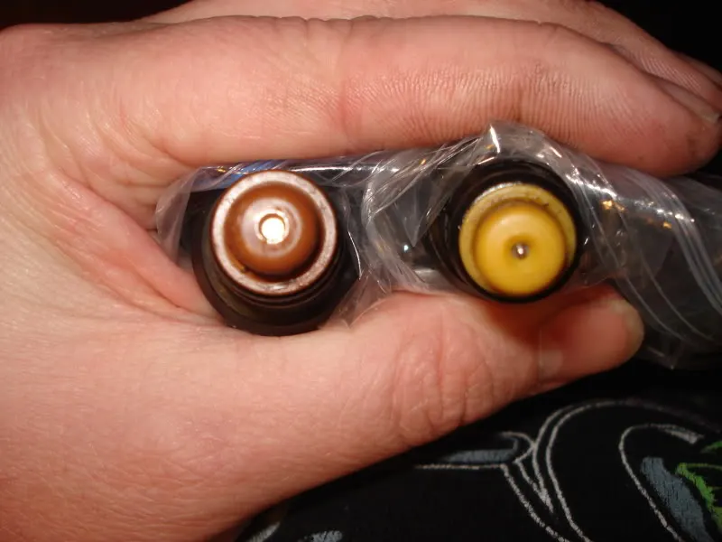

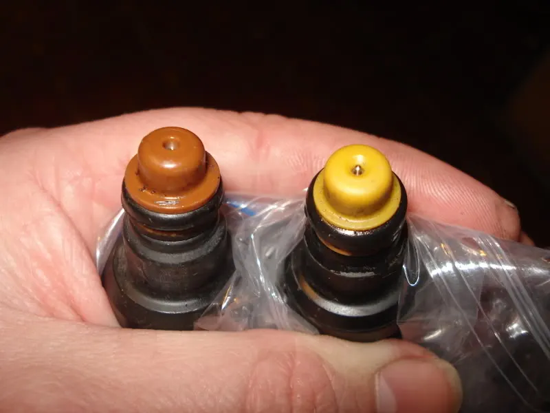

I pull the manifold and take the injectors out of port 8.... Then out of 5,6, and 7.
Oh no... one of these things is not like the others!
All the ones on the car matched the left 4 port spray pattern while the lonely injector on port 8 had the single style ford pintle (which im assuming was leading to a rich condition and lower temps)...
So a ford style injector was mistakenly sent to the previous owner to replace a 4 port spray patten...
Well good new is i may have found my problem. I swapped the injectors over to chris' cobra (ford) single pintle injectors ill have the manifold back on in the am. Lets hope this fixes the issue. The IR thermometer is possibly my new favorite tool.
