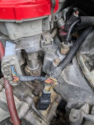

Had a real hard time setting the timing (had to rotate the dist 70* to remove the TFI). SO cleaned the balancer and put a big yellow mark on 0. Set my timing light to 12 degrees advanced and tried to have the car stay ~900RPM, it idles poorly and very rich. I noticed the plug that advanced timing removed from the dist. and there was a block off plate on the dist where it should go (pic attached). work around for bad tuning?
As far as I know there is no plug for advancing timing on the distributor, the timing advance is all performed by the ECU via the TFI module.
However, the other plug shown in the picture, the one hanging out on top of the timing cover, contains the spout connector which will lock the timing when removed. It is important to do this when setting the timing. Otherwise you cannot accurately set base timing because the computer will move it around on you. Maybe that is why you had a hard time adjusting timing?

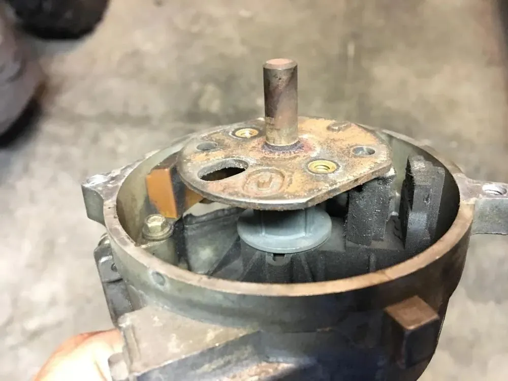

So you changed just the TFI module and didnt do a test on the Halls effect trigger?
What was the brand and the color of the TFI module you replaced the bad one with?
On my engine that had a similar issue it turned out that the Halls Effect Sensor was faulty but wouldnt throw a CEL.....
Depending on the mileage on the engine the thrustplate could be worn enough to start camwalk which takes its toll on the lower bushing in the distributor housing and starts issues with clearances up top in the halls effect trigger area..
This problem started when the actual plastic started shrinking and malforming from heat and age................
