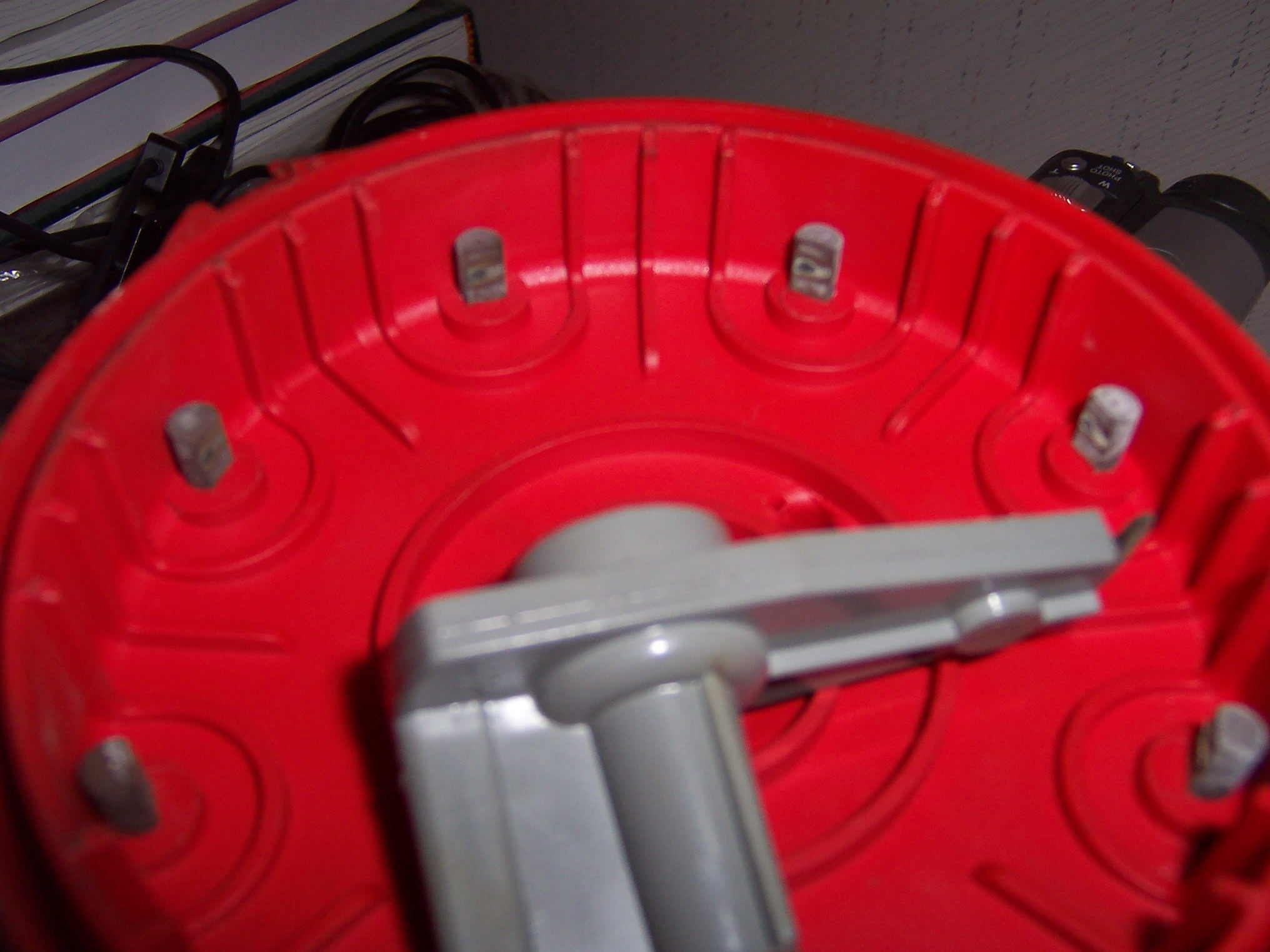

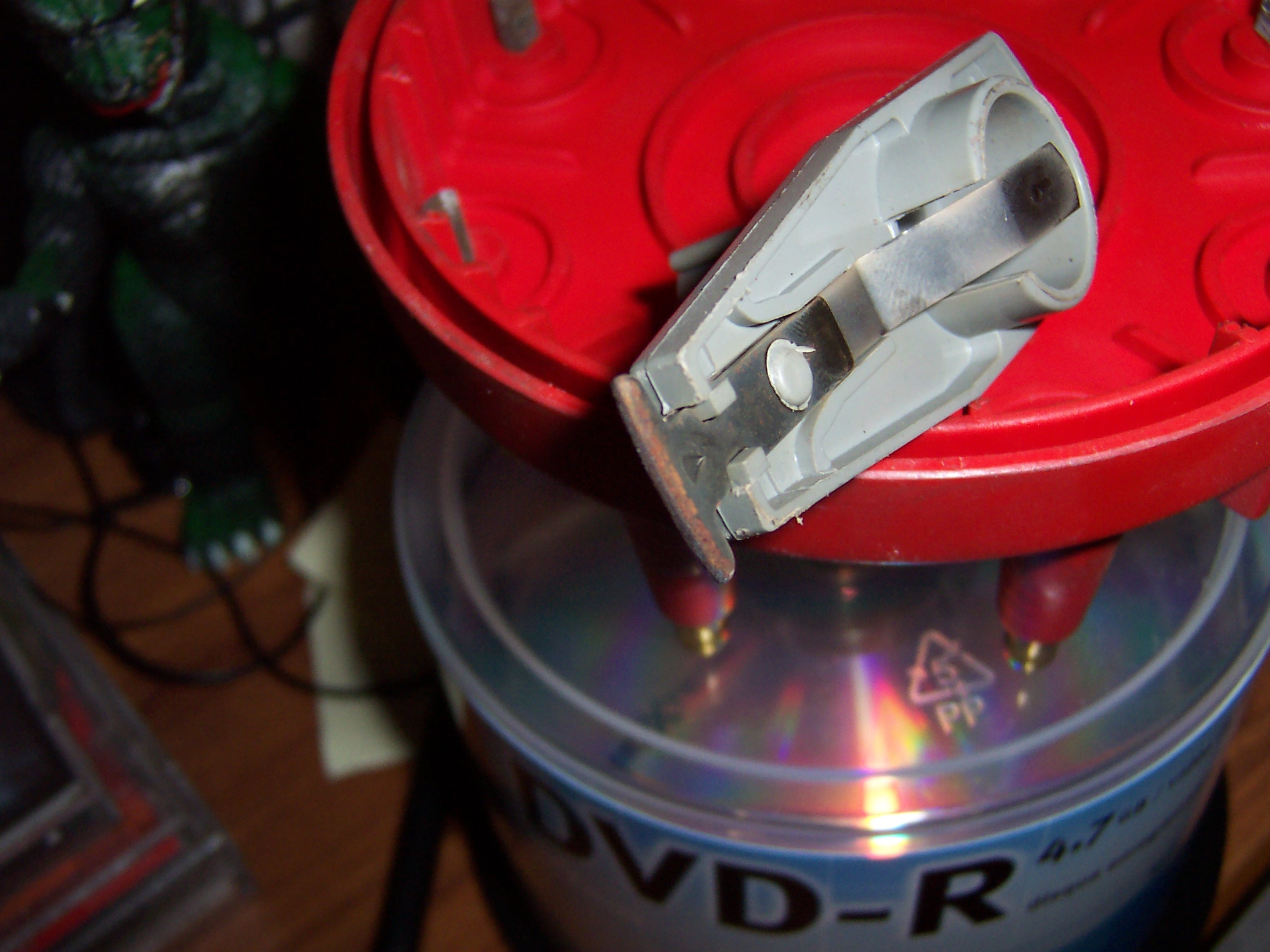

Tonight I seafoamed it and changed the cap/rotor. It seems to run better(smoother), but it didn't fix anything. Here's pics of the old cap and rotor, they're 2 years old with less than 2000 miles.
http://www.mustangaddiction.com/images/08-01-07-012.jpg
http://www.mustangaddiction.com/images/08-01-07-013.jpg
Two things I should mention. Tonight when I was running it, I noticed it was pretty bad at 5800 in 1st, then I didn't go full WOT in 2nd and it sputtered at 5700 or so then was smooth up to 5900.
The other thing is, when I changed my spark plugs a while back I noticed they were a little white meaning it's running lean. Right? I can buy an adjustable FPR and try upping the fuel pressure if you guys think that will help. Or I could buy a new dizzy if it could be a PIP problem....
