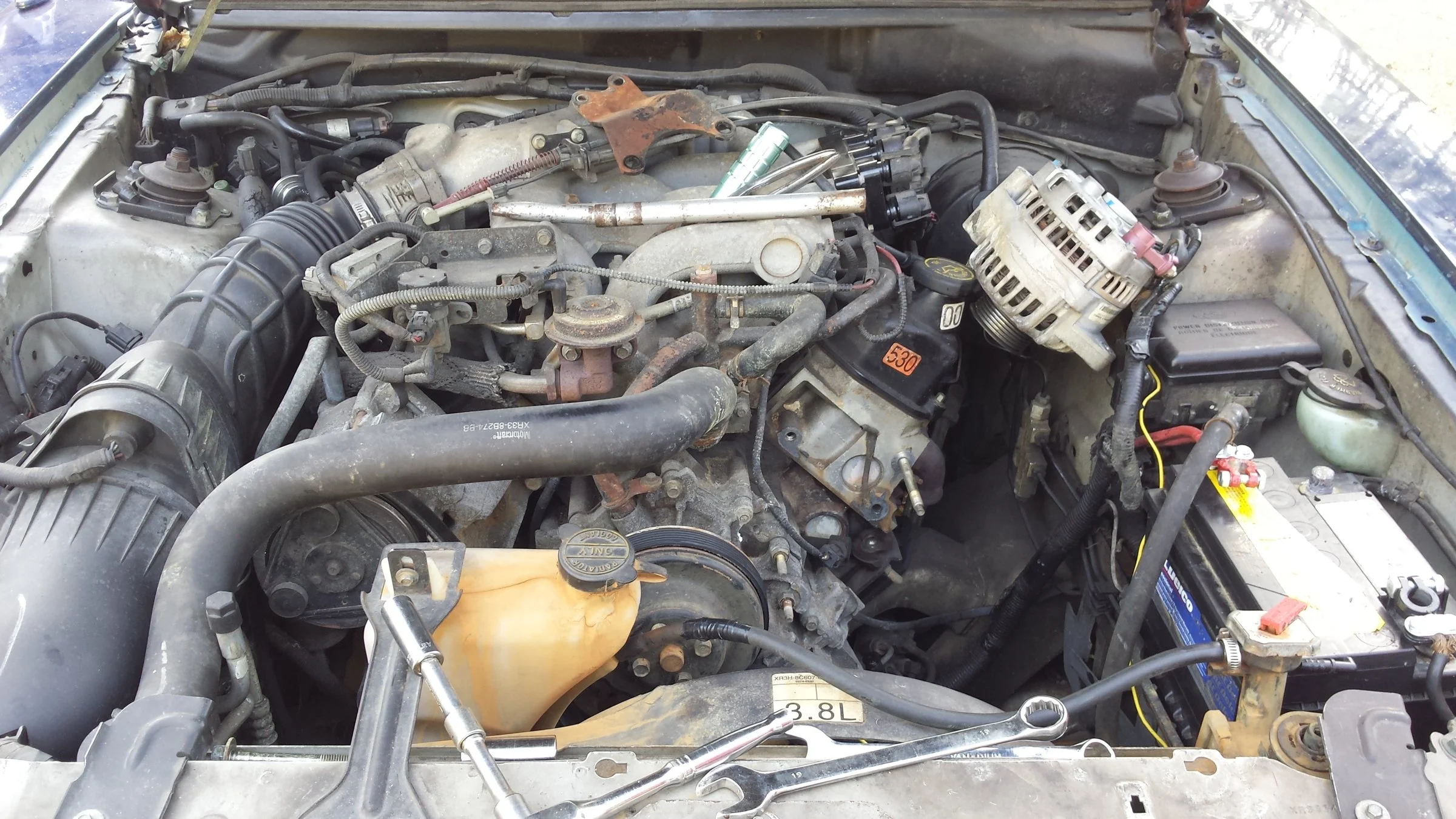

This was among the first of many (and still somewhat ongoing) repairs. Changed the power-steering pump and pulley after a cracked pulley led to a shredded serpentine belt.

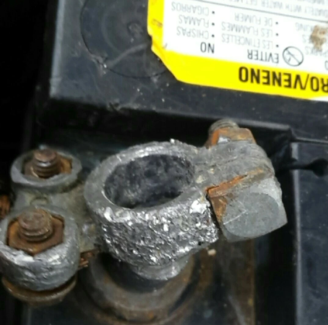

This next one is of the battery terminals. One of them had completely corroded in half and I have no idea how it was still "connected"
The first day I had Molly I changed the battery terminals, windshield wipers, and added fluid -only to realize my sprayers were not connected about 3 months down the road.

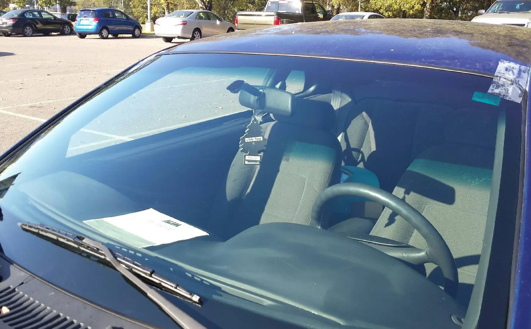

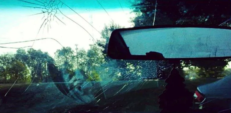

Also this is what my windshield looked like. I was pulled over 3 times in one night because of it. I told one officer "sir, when I get $250 to replace it I will, unless you want to?" Still have no idea how I didn't get a ticket.
Before...
After!

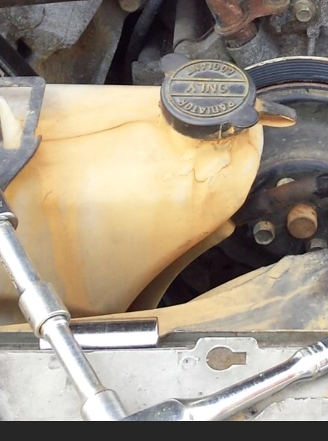

Great back story on Miss Molly. Always awesome to hear/read about people taking a project car and diving right in- down the road you will appreciate her so much more :)

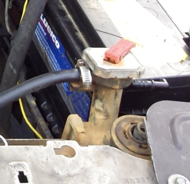

Looking at some of your pics-you may want to put a coolant flush on your to do list-looking a bit rusty (at least in the pics.)
I actually just changed my radiator and hoses out about 2-ish weeks ago and flushed everything out to be safe. I'm just back-tracking on all the work that I've done already. But I appreciate the tip

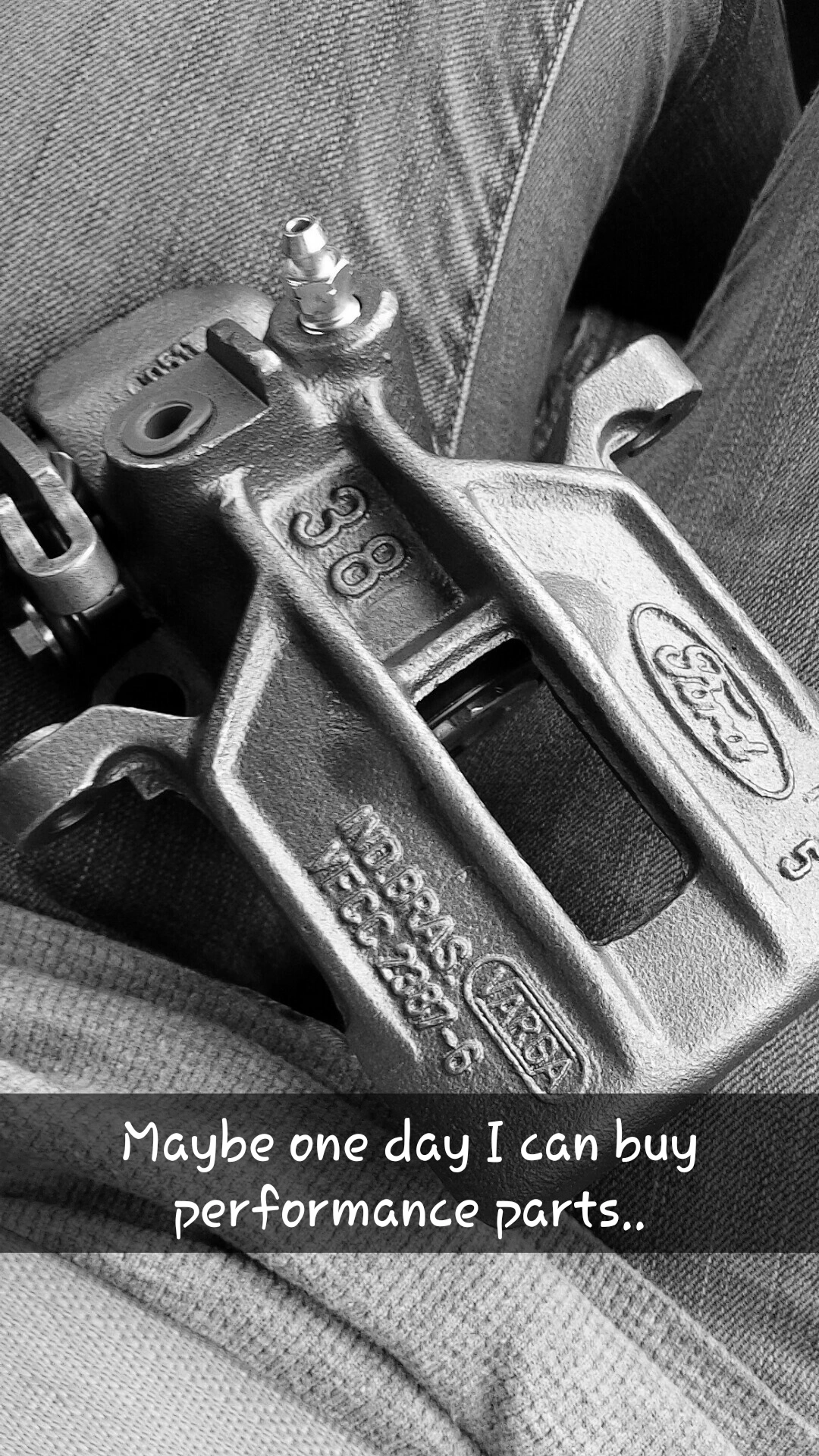

Okay, and so now if for the fix that was a pain in my ass and cost me probably way more than it should have (around $600). When I got the car, I noticed that the check engine light and the brake light were both on. I decide to look in the brake fluid reservoir only to discover it's dry as a bone. I thought *okay, I can just put fluid in there, problem solved* - famous last words. I filled it container then went to pump my brakes to get the fluid down there. Well....
I hear this dripping noise.
The caliper on the rear passenger side WASN'T EVEN ATTACHED TO THE ROTOR. It had been tied to the side with a SHOELACE.
So I finally get up the money to buy the new caliper and line, and put new brake pads on all the way around. I had gotten a family friend of ours to help, because putting brakes on is a two person job.
About two weeks or so after I had put on the new back brakes with the caliper and line I had noticed a LOT of brake dust - I am not one to eat up brakes. I decided to take it to my local mechanic shop and see what's going on, to see if something had gone wrong or if it was an error on my part.
My friend that works there, we will call him Bob. Bob says "Elizabeth, come into the shop with me for a second. I need you to look at something." So we get out there and the tires are off. He says, "Tell me what you see wrong here" and I say "well that rotor is shot completely." Bob says "Sweetie, you don't even have any brake pads"
The caliper I bought had malfunctioned. RIP my wallet...
But, the problem was finally fixed. this is just a picture of the malfunctioned caliper I had purchased.

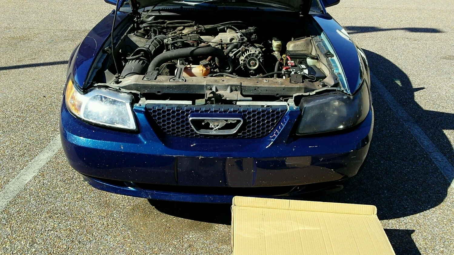

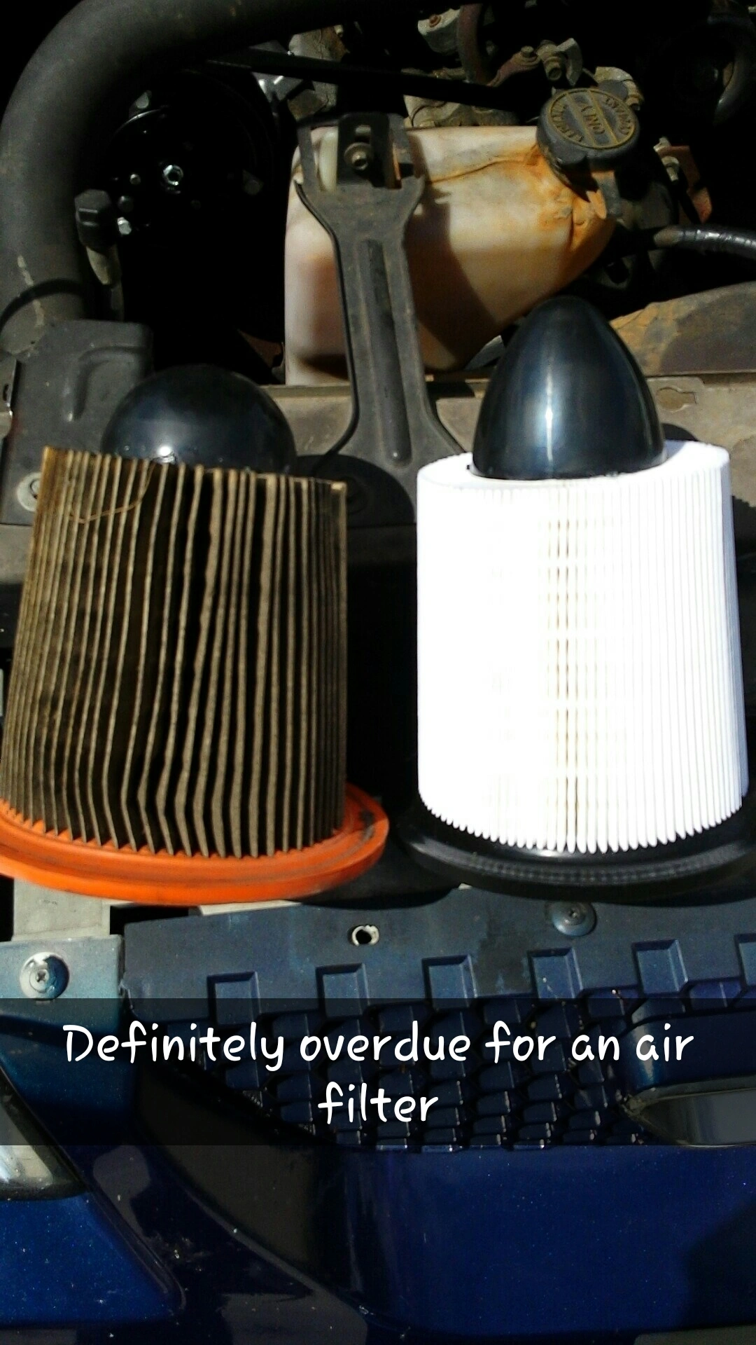

I had absolutely no idea what the previous owner had done with the car, as far as servicing it with oil changes, changing the spark plugs and wires, etc. So I just did everything from scratch. Be prepared, it isn't pretty what you're about to see...
That day, I also changed over the headlights. Molly had some that were smoked out, and I am not a fan of them. So I did some looking around and was able to score these beauties for stupid cheap. I have the HID kit, I just haven't installed it yet.

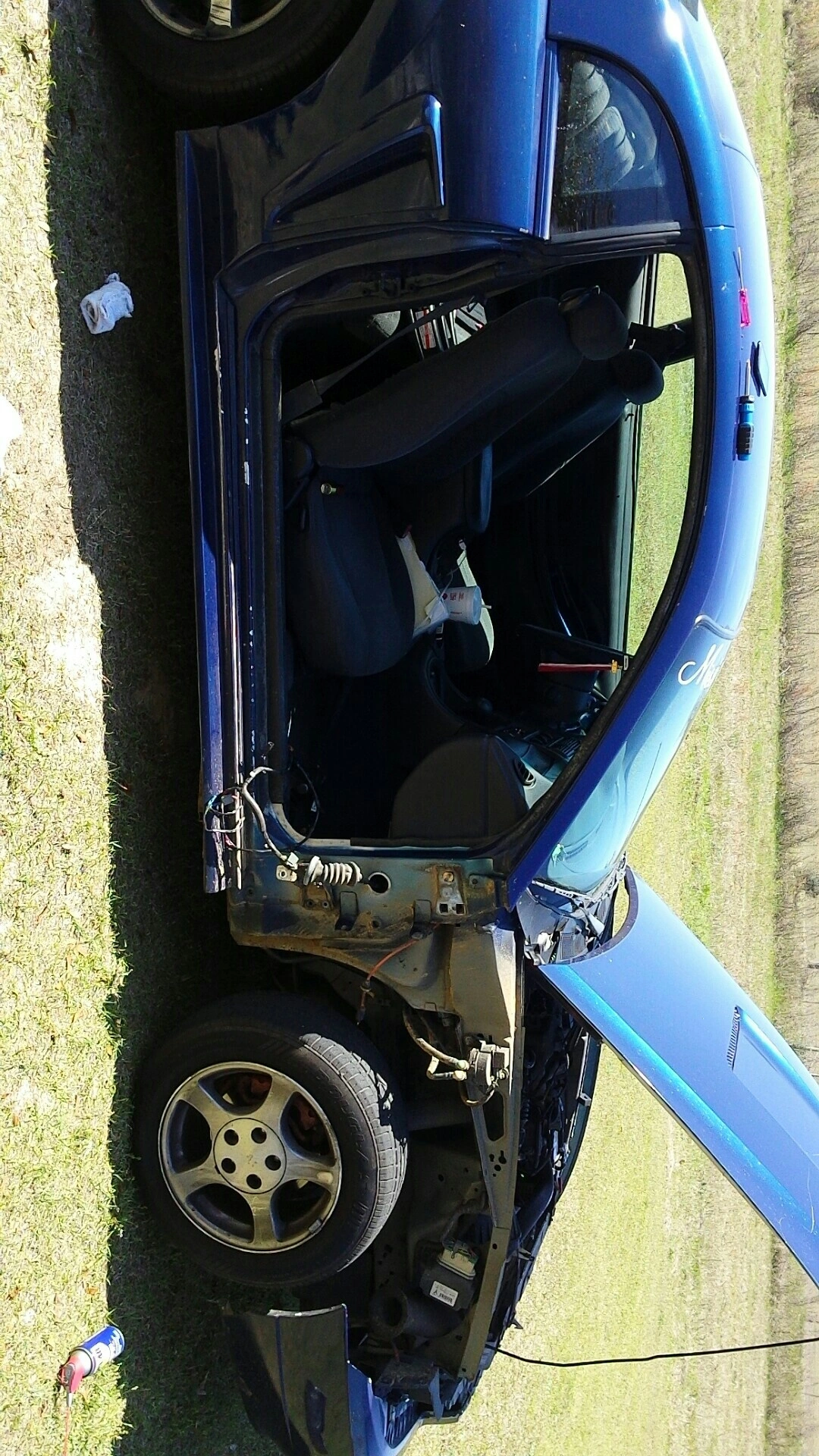

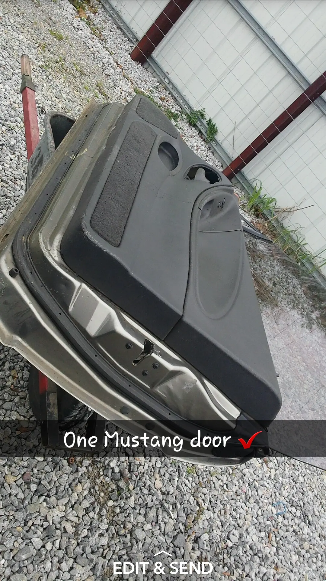

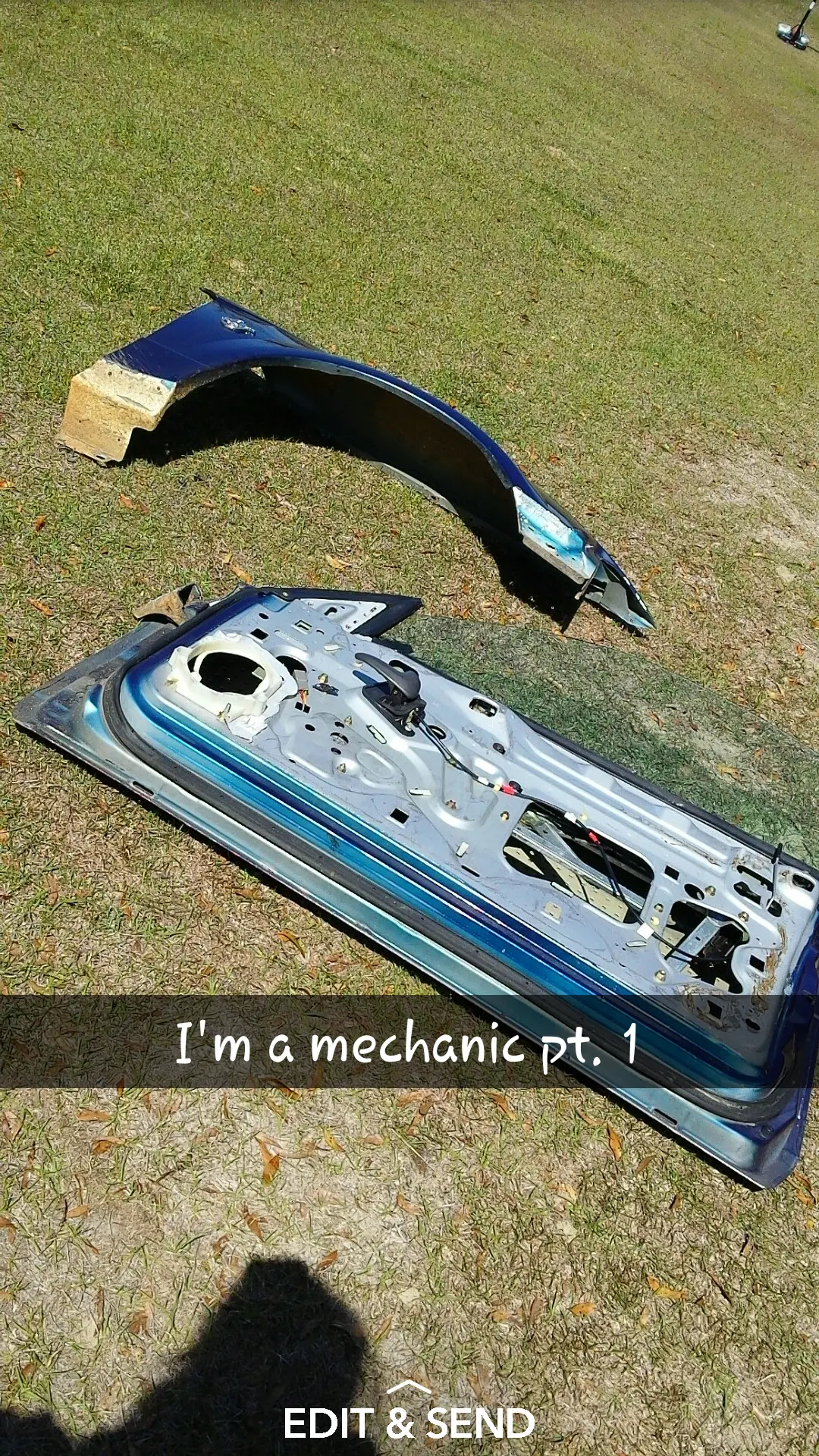

When I got Molly, I knew that the passenger window didn't work. I thought it could be a simple fix such as a disconnected wiring harness or fuse - oh, how wrong I was! I took off the door panel to find that the window was not properly aligned on the mounts because... THERE WAS ONLY HALF OF A MOUNT IN THERE. The window motor didn't even click on when the button was pressed. So instead of spending $200+ on getting a new window regulator, lift, and switches, I took a field trip to my local Pull-A-Part and got myself a $50 door.

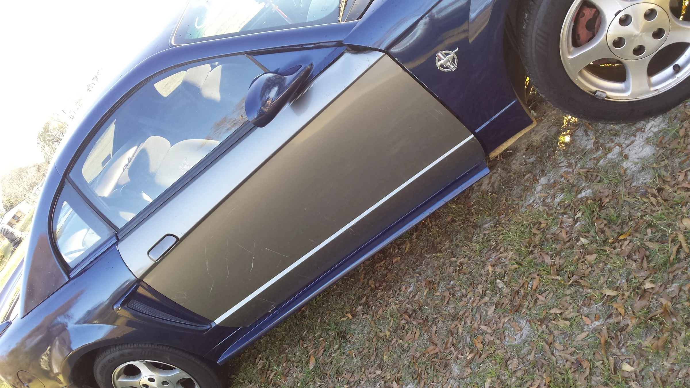

Door came off a 2000 Mustang:
On a side note, I quite like the charcoal grey exterior color and have considered swapping Molly over from blue to grey, but I don't think it quite fits her personality.
I knew the door would be heavy, but not heavier than me! When removing it from the donor car, I almost took off my right ring finger tip but it's all about the blood, sweat, and tears right?
I had to wait a few days to change it because the weather wasn't the best. But nonetheless, I got 'er dun.
This was the original door. I did not know how to remove the wiring harness from the donor door so I wound up cutting the wires. Instead, I just fed the original wiring harness backwards through the boot and connected it properly to the new door.
For all you DIY folks out there, you really have to be on your game for this job. If those door brackets aren't lined up EXACTLY perfect, the door will not close properly. I learned a few new curse words on that day... Also, Mustangs don't roll the way Jeeps do, with the doors off and all.
But all in all, here is the final product. My brother says it's mismatched but I say it just gives her character!
Also, the donor door was originally flawless. These scratches came about from me trying to load it into the wheel barrel.

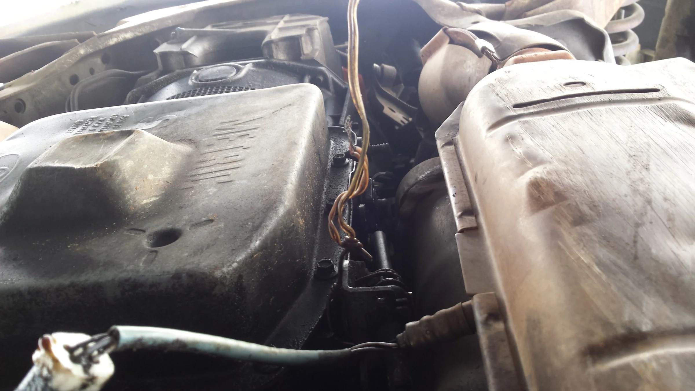

Great news! I was finally able to replace the shifter cable on Molly, but it required a small blood sacrifice. But of course with Molly, there's a story to her repairs... buckle up boys.
So I get under there and start disassembling the bolts from the broken cable and everything is gravy, until I get to the last one that has this larger bracket to mount it to the car. I kid you not when I say the previous owners before me used *speaker wire* instead of mounting the cable into the bracket. I even have photos:
(for whatever reason it keeps flipping the photo upside down, so I apologize)
When I saw that I just started laughing. I'm going home this week from college so I'll be able to get some photos of my old radiator to post on here. Thanks for hanging with me and Molly!
