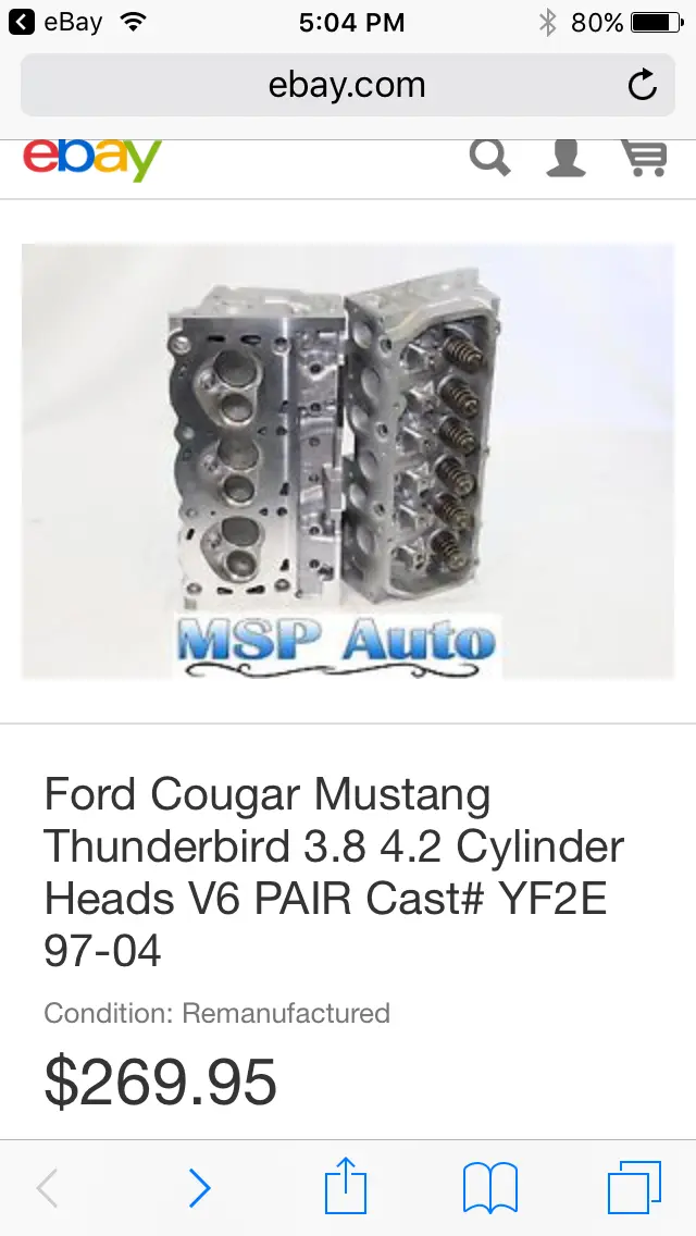

Not sure what it would cost to have your heads rebuilt/machined.
Has good reviews ,may be worth checking into :)

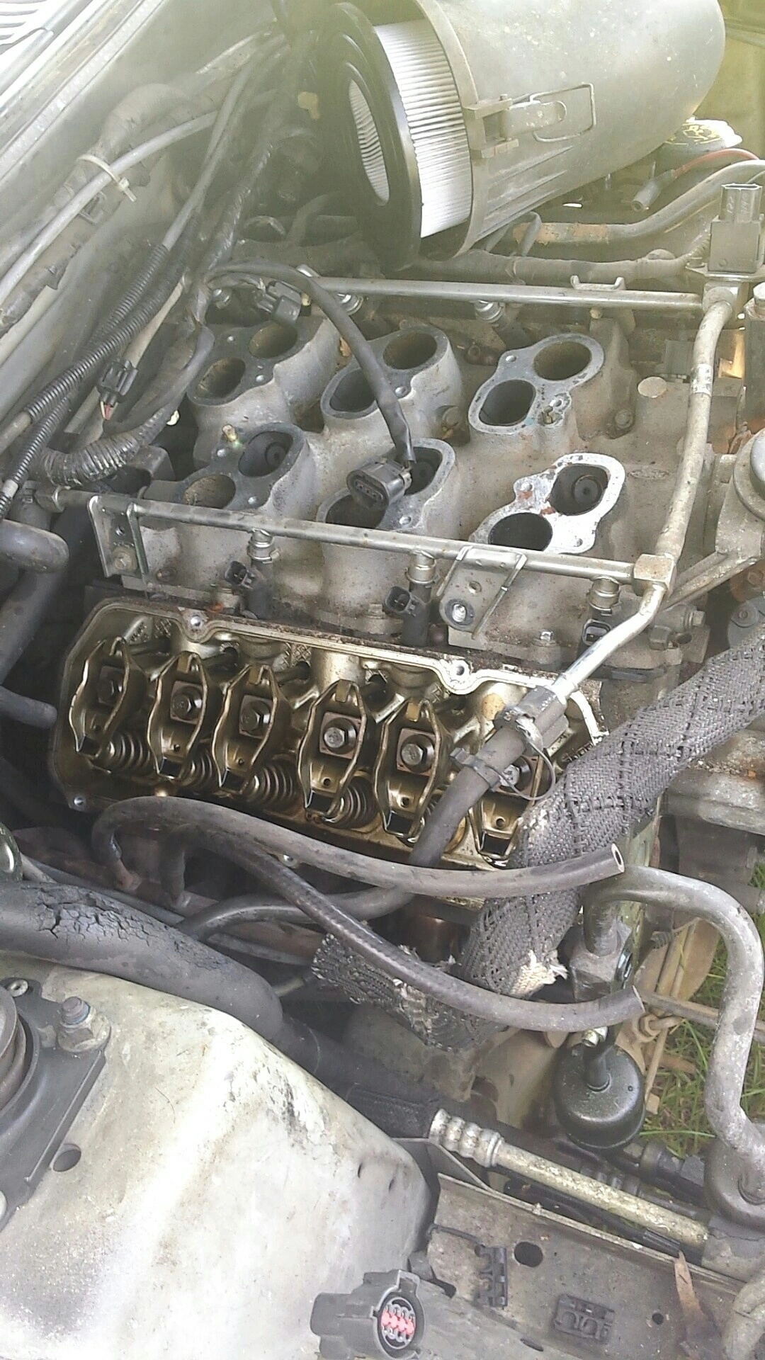

I pressure washed my intake today and now it's clean. I was not able to remove both heads because mother nature likes to play games when I go outside to work on my car. I only have a few more bolts left on the a/c side of having the head off. Hoping tomorrow will be the day I get both off.
As promised, here are pictures
This is after removing the intake manifold
And this is where I have the valve cover removed. I have also taken off the rocker arms and labeled them. Hoping they can be machined on Monday!
