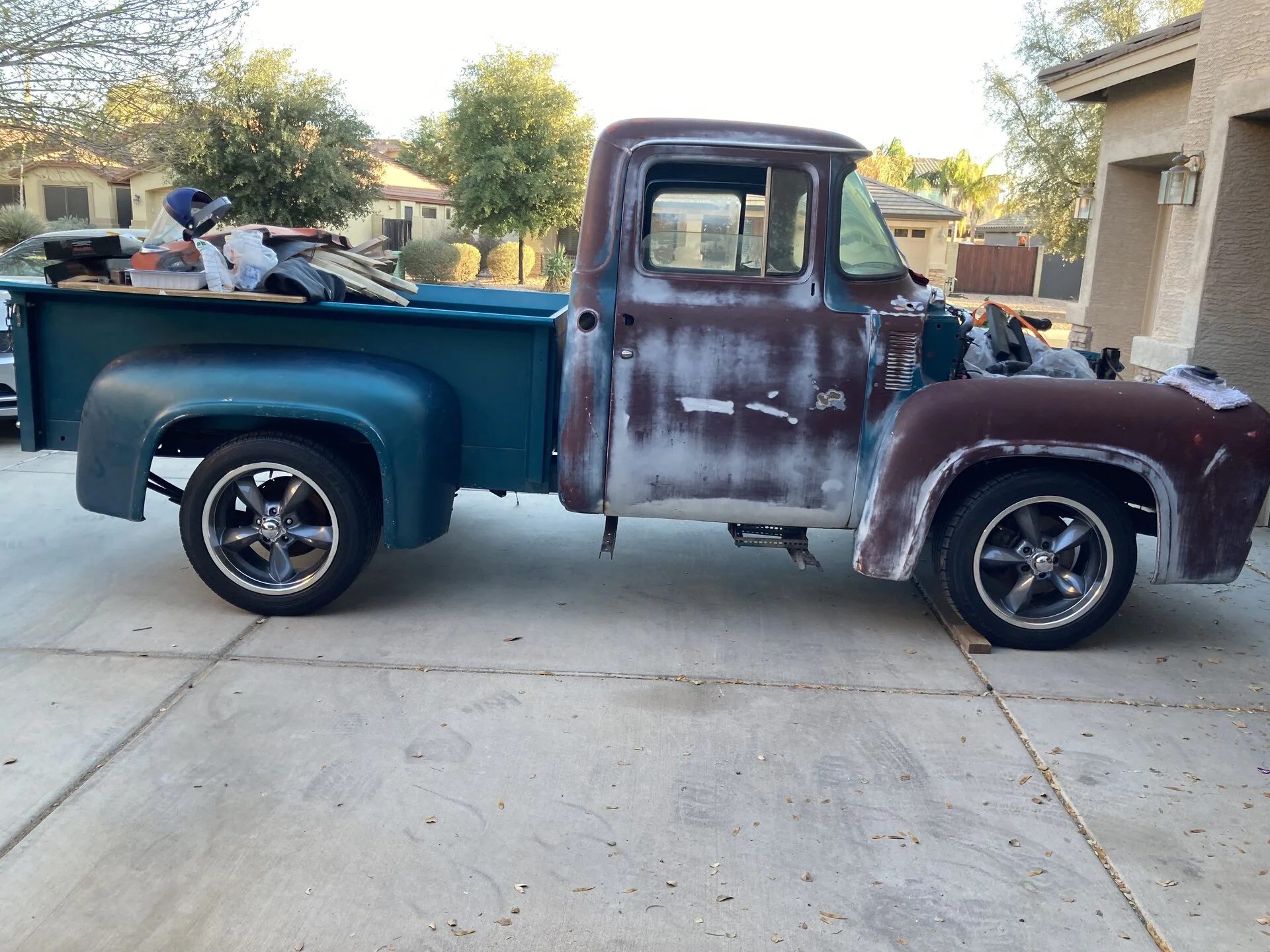

New tfi will go in this weekend. Tied up this weekend with life stuff so not much work will get done. I think i mentioned the 56 f100 in the past but i was informed there wouldnt be much interest so i left it alone. Its had a few changes like most projects like different power plants and suspension/cross memeber changes. Currently it has a ‘18 f150 coyote motor 10r80 sitting between the frame rails. I boxed the frame for a little more rigidity. Had a wiring harness made and the computer reprogrammed to remove vats.

Thats correct. Still has the crown vic k member but the 4.6 is long gone. I got an 12 coyote motor but sold that to fund another project. Then i found this 18 f150 motor and trans with 6k miles for $4500. Couldnt pass it up.

Coyote swapped pick up sounds pretty sweet, last I remember -it was still pretty much in the disassemble/planning stage right?

yeah. It was in a lot of pieces. But the can and bed are back on it.
