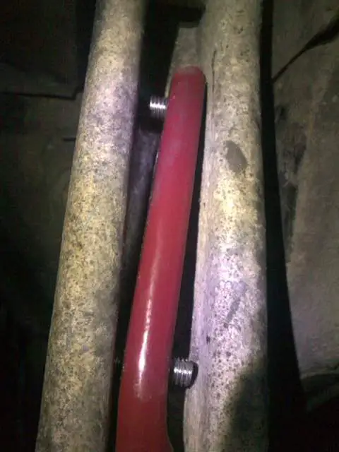

I got the rear springs and shocks done. Figured I'd be done with the rear sway bar in 15 minutes or so. Not so. What is Eibach thinking? The rear sway came with grease pack, 4 bolts and 4 nuts. You look at this picture and tell me whats wrong with it... Just how the heck am I supposed to put nuts on that? I am not even sure if this is the right parts. Its one of the eibach hardware packs that came with everything (3 years ago). I cant find anything else. I tried using the stock U clips that were attached to the stock bar, but they wont fit. The bar is a little thicker. Can someone help me out here? I am almost done and just want to get this crap out of the way.

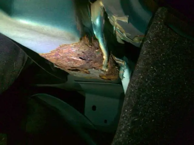

I have been getting water in my trunk. I thought it was either somehow getting in from the top leaking into the vinyl cover behind the back seat. Thought maybe it was dripping out. It wasn't , nor was the trunk weatherstrip bad. After removing the carpeted panels so I could get to the shocks, I discovered this mess. RUST... and a lot of it. All within a 2 - 3 square inch area just behind the pass side trunk piller. This must be where its getting in. I dont think the hinge mount is leaking... maybe from a drainage channel for the top. Its pretty bad. Rust chunks are breaking off . Anyone know how I can get this repaired? I'm getting a lot of water in my trunk now. It just started leaking this year.
This is the only bad rust spot on the car. There are a few surface rust spots from where the paint came offf and a couple specs underneath.. other than that.. this is it. Like to know where it came from.

Your sway bar should look more like this
I just used some grade 8 bolts from Lowes to put mine on, maybe take it out and see if you can bend the ends so you can get the nuts in there.

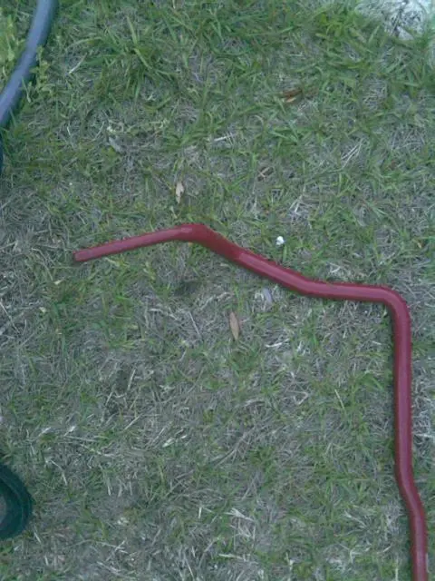

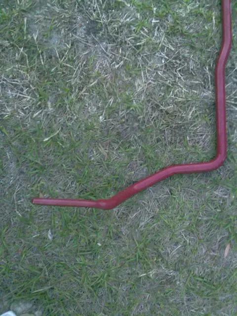

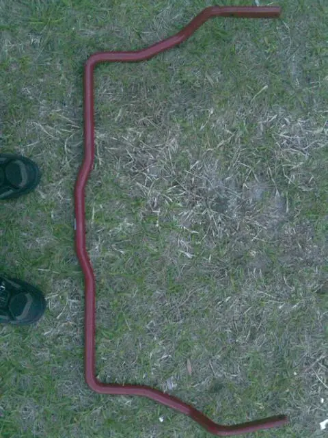

Man, I tried bending that. Impossible. It's solid steel on the ends. Both sides are like that. I wonder If they sent me the wrong rear swaybar. Too late to send it back cause I ordered it 3 years ago (long story, but never got around to the work as it sat ). Thinking of maybe selling this and getting a Steeda. I'll use the stock bar for now. There is no way I can use this with the ends like that.
I think Eibach screwed up and improperly labeled this bar for 79-04 .. when it probably only fits 94-04 properly... I'm going to check it on my 96.

Dear Lord, I think we have the same car. Eibach products are good if they fit.
I had the sway front sway problem as you. As for the rear I went up to Ace and got 4 sets of grade 8, bolts, nuts and lock washers. Works perfectly. As for the leak, yes it is the rust. I have it on my drivers side. Hmmm, I doubt any of the auto parts stores in Lehigh have the bolts. I can't think of any hardward stores. The hardware store across walmart should have the grade stuff??
Yeah, the bar is bent on the pass side. It's like it was cast that way, and not like it was damaged. It's straight on the drivers side. I set the 2 bars on top of each other, lined them up to where the bolt holes would meet. Is this bar supposed to be crooked like that? Stock bar I could bend, this one, Nnnno. That thing is solid. I could try and take it someplace to have it straightened, but I dont think it would bend properly at the right point.
And btw, no nuts in the world would work, if I couldn't get them in there in the first place. It's too cramped on the pass side at the very end that a nut wouldn't even clear the gap in the LCA. Yikes.. I swear I got the eibach curse.. its one problem after another with their parts.

Its supposed to be bent more on the pass side? How did you get it bolted up? Yeah, if you could post a couple pics, I would like to see how you bolted it.

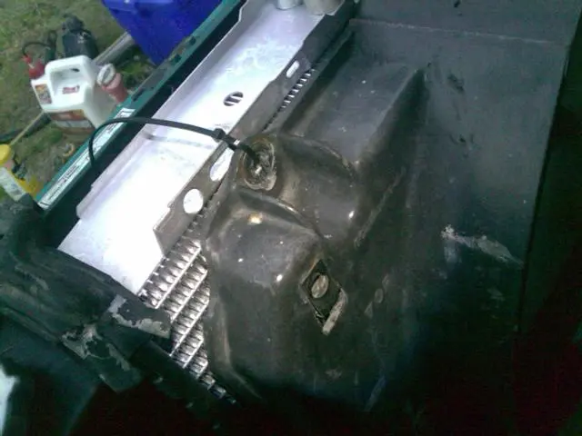

Heater core bypass

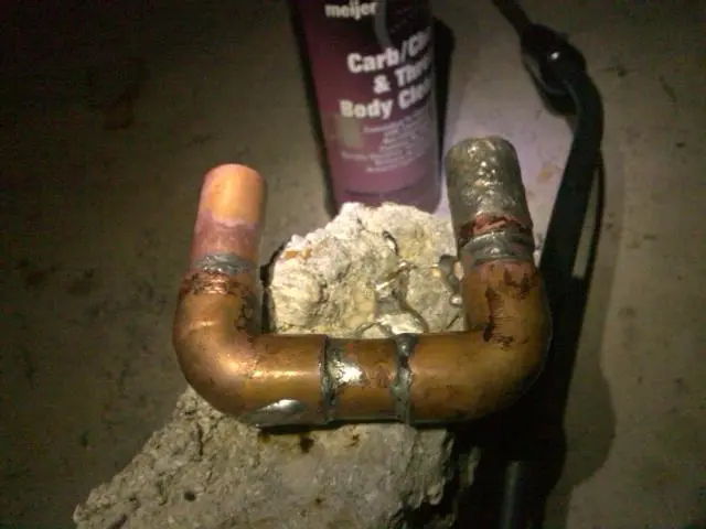

Heres a U-pipe I fabricated from soldering copper pipe fittings. As you can see, I dont solder copper real cleanly.. i'm workin on that though. On the one end is a 5/8 coupling. That is the end that is coated in solder. I'm using that for the larger hose end. Even though it's bigger than the half inch pipe, it still fits in pretty loosely..but better than the pipe. I coated it hopes it would add a little more thickness. I'm going to put blue rtv and clamp it down real tight. Should hold up no problem.
I couldn't find a fitting that would fit that hose tightly. It's like between 3/4 and 5/8. This works tho..

Post up those pics Notch916 if you can. I really need to see your rear bar install.
