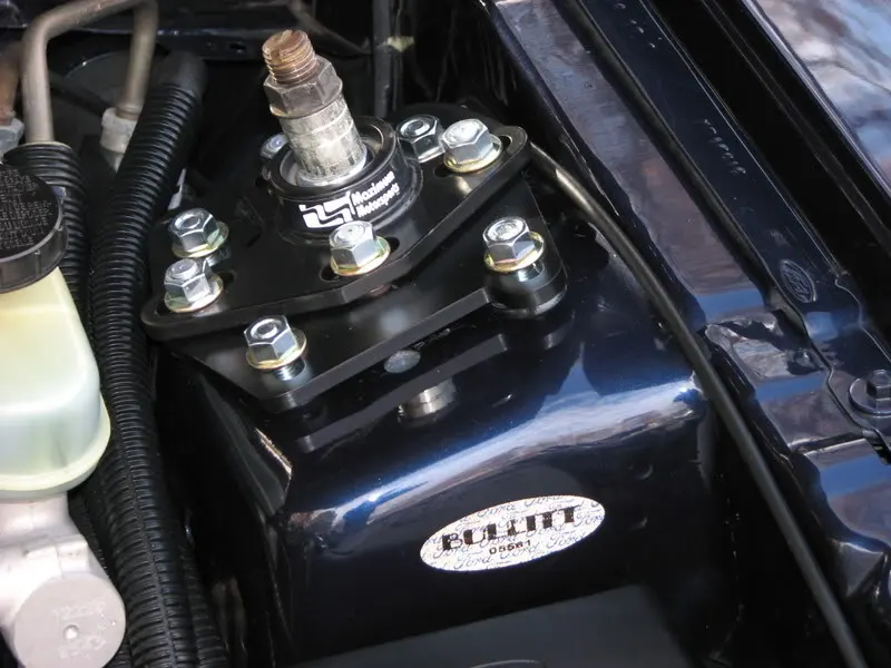

I just bought a set of maximum motorsport caster camber plates along with some new struts. On the MM website it says to install one spacer underneath the spherical bearing on lowered cars (eibach sportlines). Which i did, but it looks like the strut sticks way to far out above the camber plates (see picture), is this normal? or am i doing something wrong? any help is apprectiated.

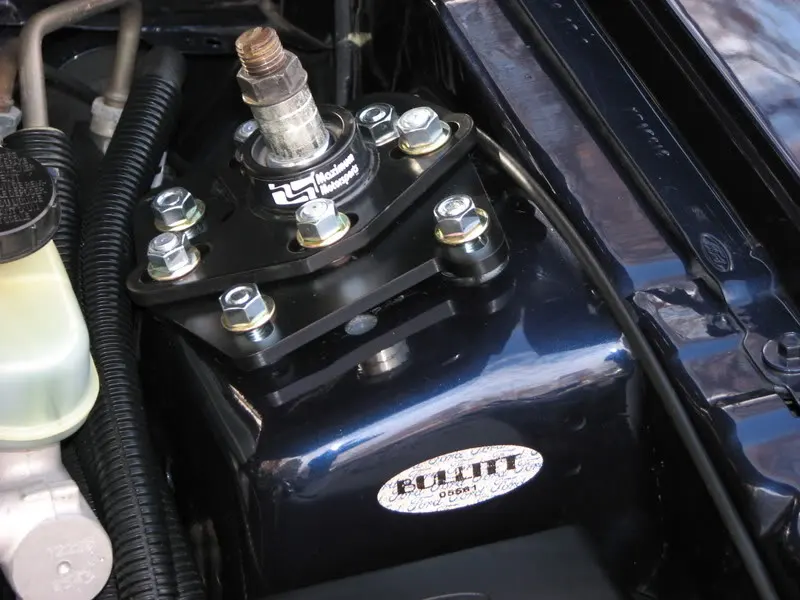

Dont be fooled, this is not a 3 plate setup, its just the super sweet bullitt engine compartment clearcoat. wink wink 2001 also

Mine are like that as well. It's normal for them to be like that, but you need to check your hood clearance. As long as they clear the hood, you are good to go. If they DON'T clear the hood, then you need to add the appropriate amount of spacers under the spherical bearing to fix the problem.
