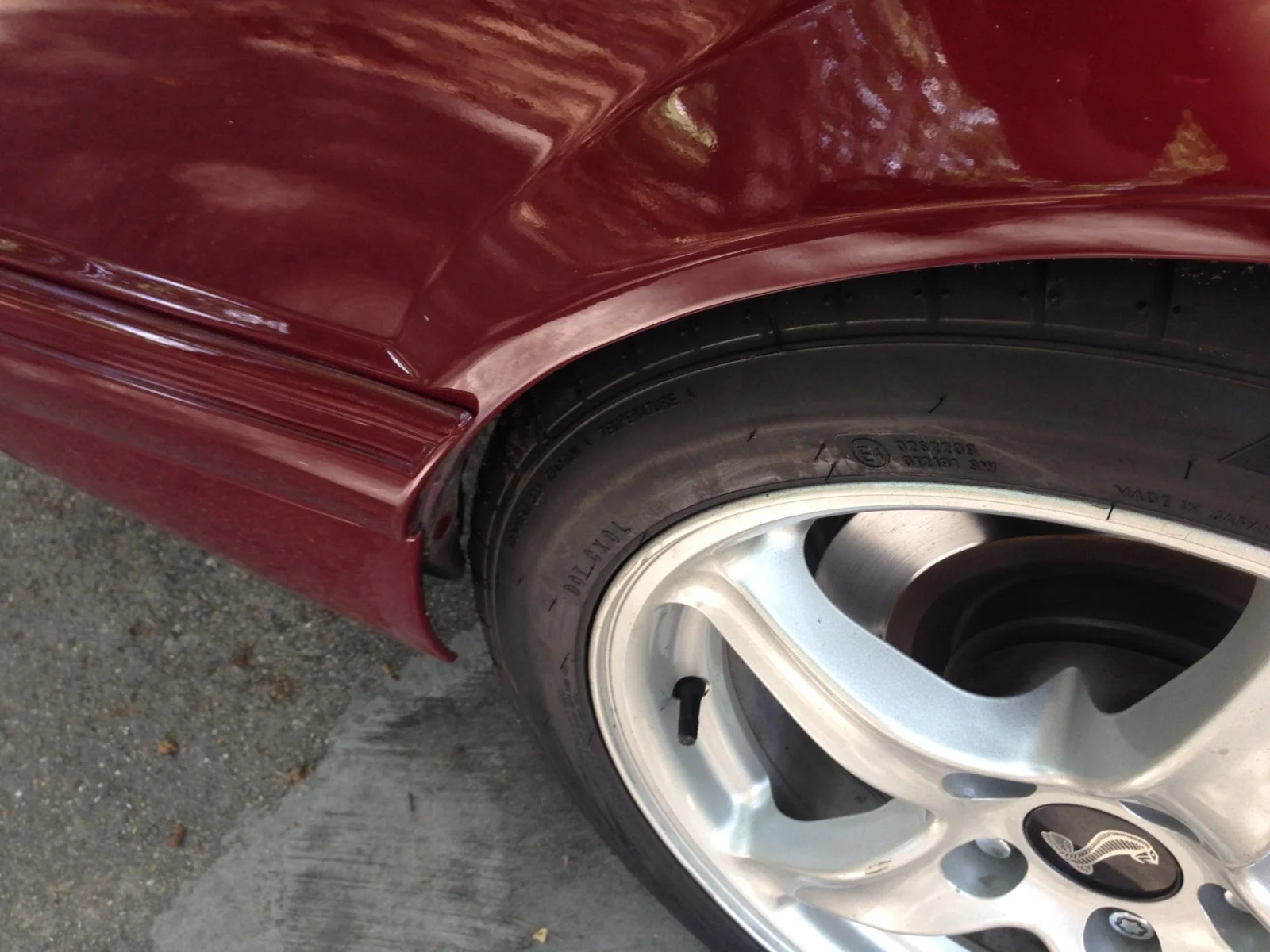

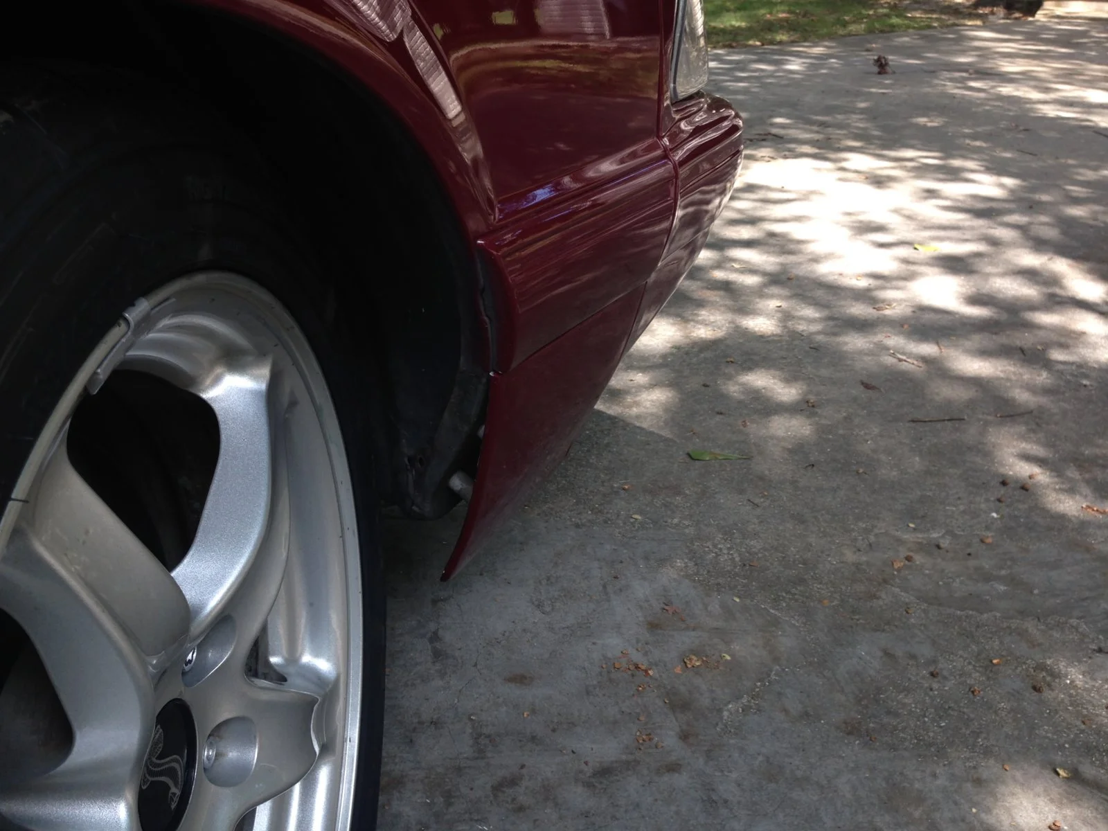

I have a MM modular swap k member (don’t know if this matters) and used the reverse offset control arms for a few years. I hated it. The reverse offset control arms completed eliminated the Ackermann effect. The steering never felt right. At parking lot speeds when turning sharp, the front end would push. You could hear the tires sliding. I even set the tow to zero hoping to get some ackermann back, but it still wasn’t right.
I’m now using the standard offset arms. I did have to trim the lower fender spats, but I have the 87-90 fenders. I also went to narrower front tire.
MM sent me a word doc explaining the necessary modifications. I’ll try to find it if you’re interested.
If I were doing it all over again, I'd do their reverse offset arms that keep the wheels positioned like stock. I'm just not sure the forward offset gives a performance gain that's worth the PITA it causes with fender clearance etc.
