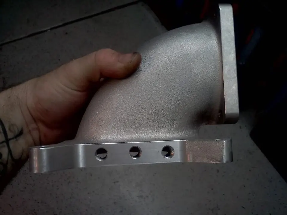

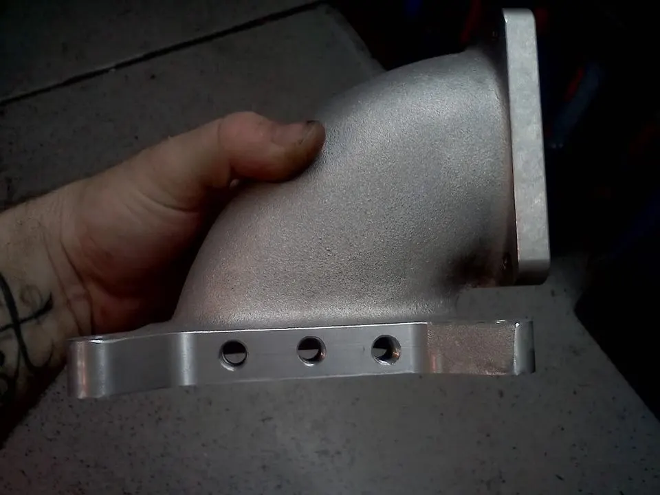

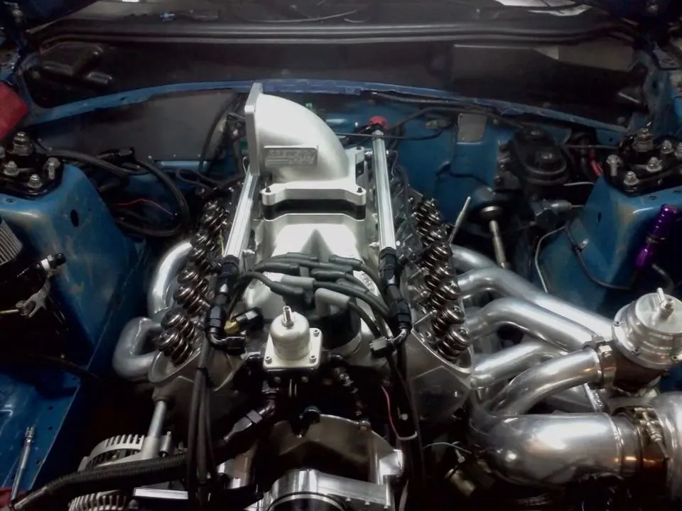

Milled Upper Elbow .5" and drilled/tapped rear for vaccum refrence.

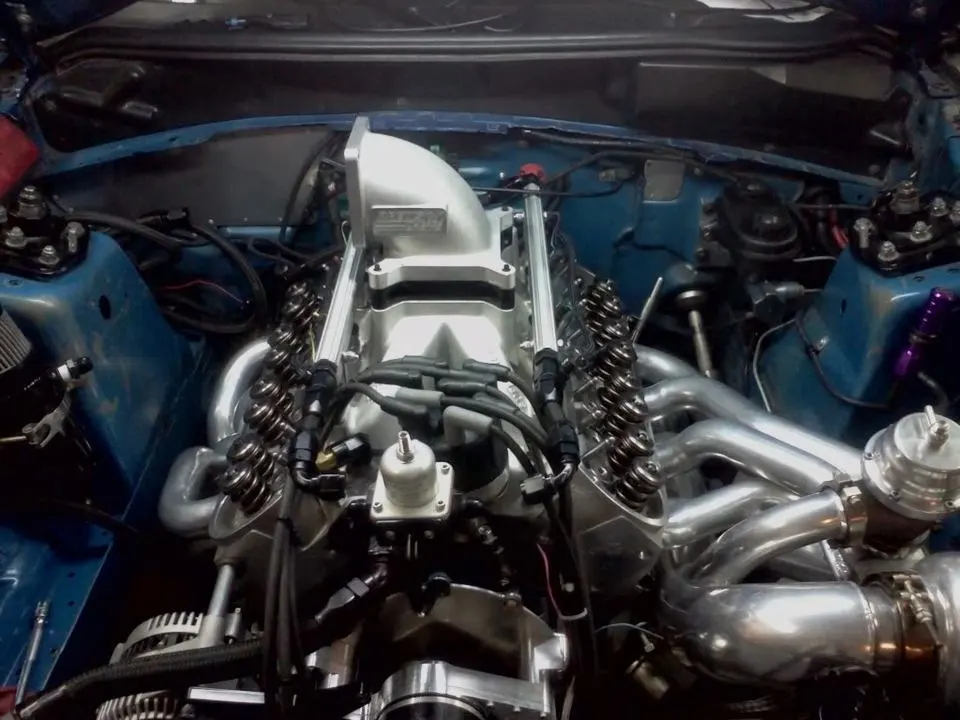

Should have the rockers back on and lash set today. Then I can put the VC's on for good and button up the top side. Still have a few odds and ends but getting there.

I think I may paint the milled portion of the upper also where the words PRECISON are so it highlights it. Detail work...gotta love it.
