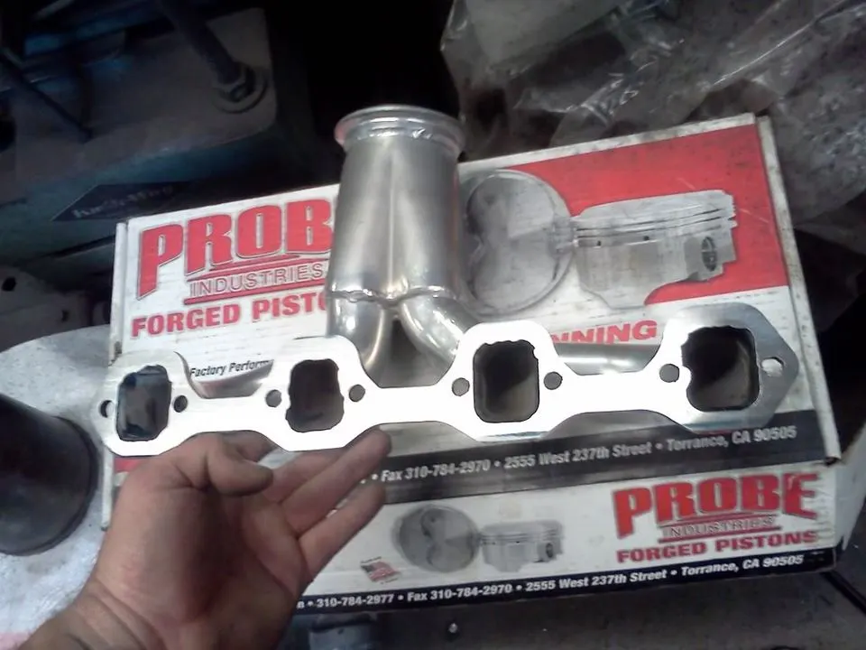

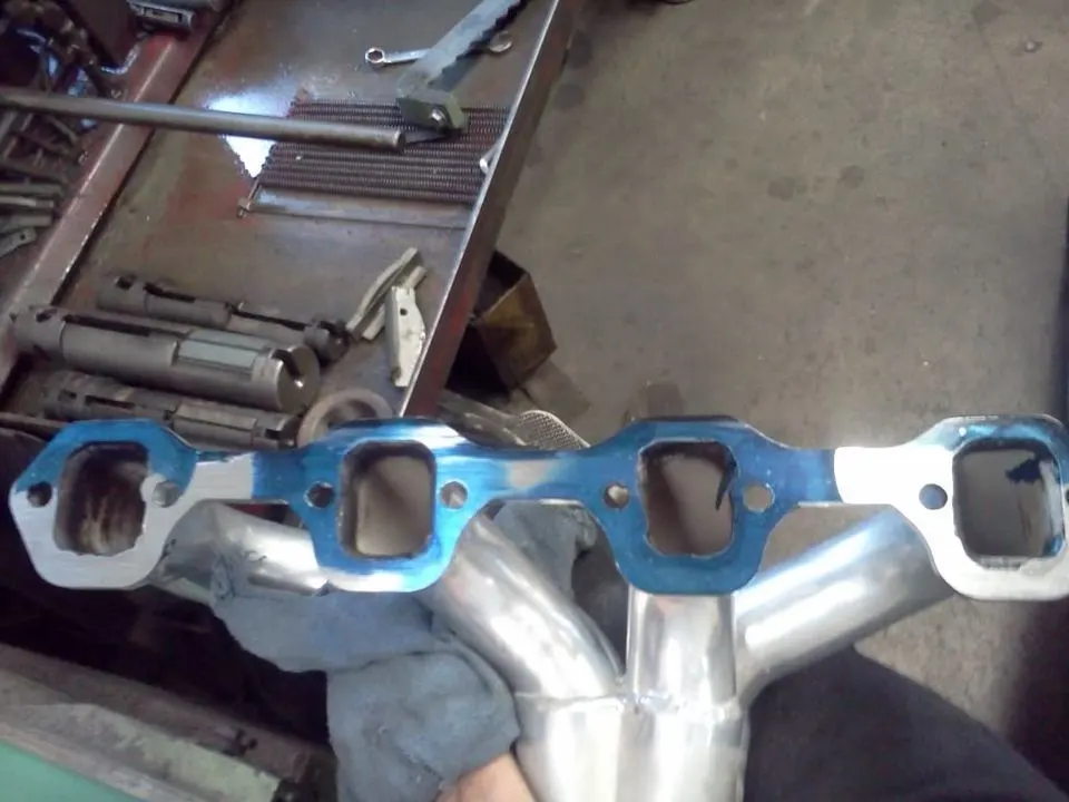

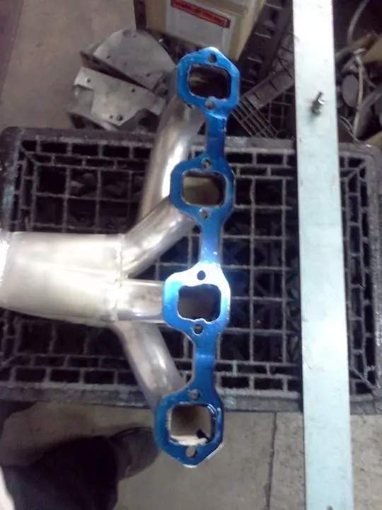

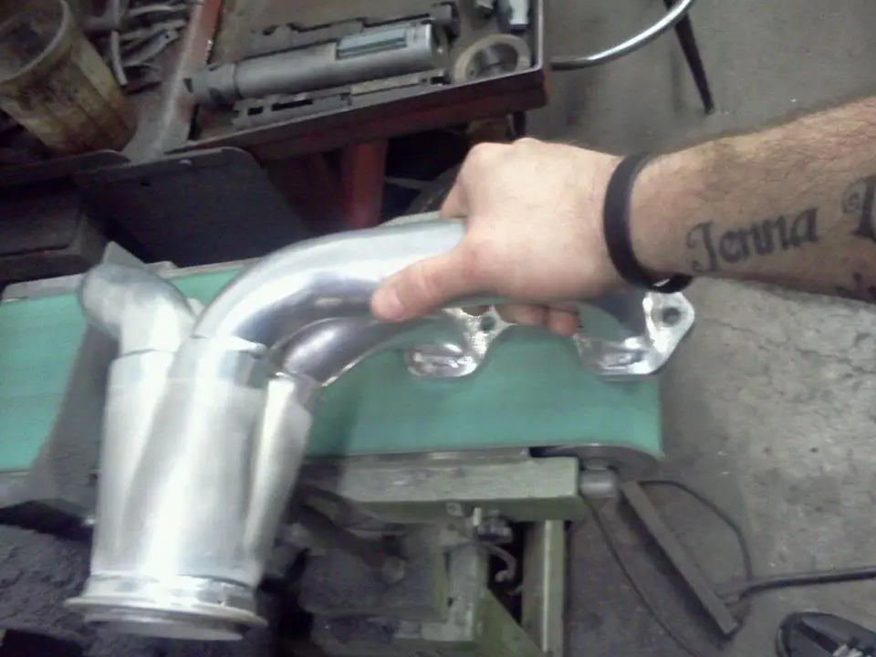

Trueing header back up tonight
Rick yes, they are about 7yrs old so I guess it was time. On the 146mph pass it had a nasty exh leak and had black stuff on the cyl head from where it leaked so bad so I finally said thats it, fix it right.
Thanks Kurt I have been working hard to hit that 9.11 for Jenna!
Sweet...Ive seen that on normal headers as well. Thats a mild steel header right?
A guy I was talking to about my turbo headers told me if I go stainless be prepared to have to mill the flanges often and really recommended Mild Steel. I know there are many theories and you get 50 different opinions between mild steel vs stainless...I just like that stainless will last and look beautiful, a 32v mod motor in a fox doesnt make them easy to get to you know..lol

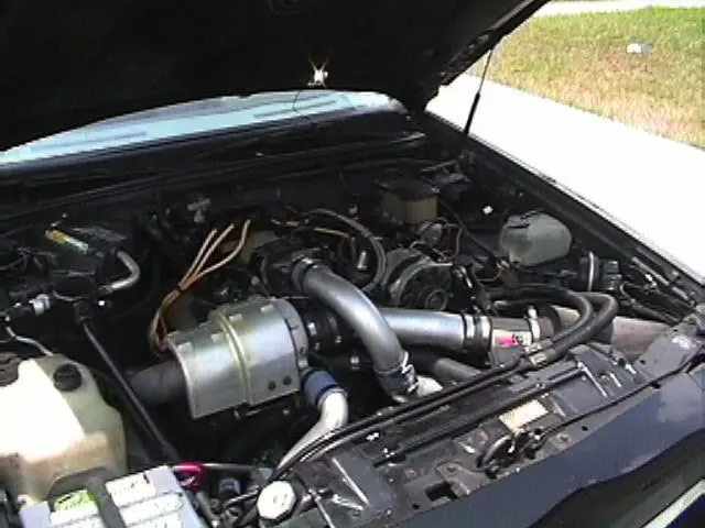

I had an issue with the mild steel Turbo header on my 86 Grand National. Had it rewelded twice, cracked again the week I was selling the car. Got a stick of JB Weld High Heat Temp Header Epoxy, fixed the leak better than the reweld. 550+ of Toque on a little V-6. Too much torque on that header I guess.

Rick yes mine are mild steel. Considering the age and use most are surprised this is the first time I have had to do this.
