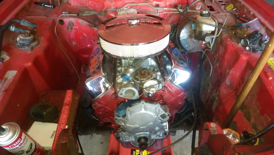

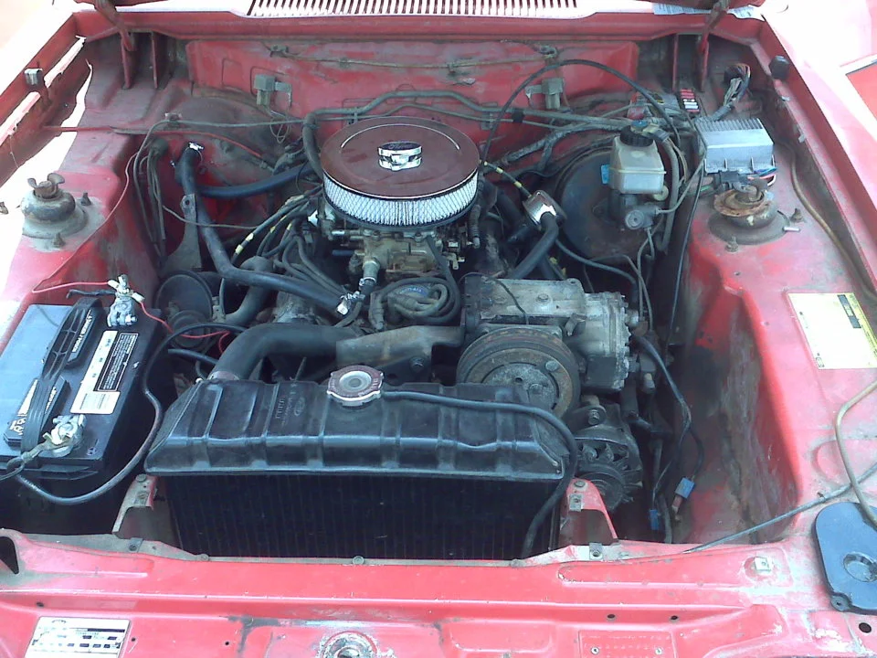

I've done an engine swap or two. I've put fuel injection into non-factory EFI cars (including my '75 Mustang II).
Right now I'm in the middle of a custom 5.0/T5 swap into a 1977 Ford Capri Mk2 from Germany that originally had the same 2.8L V6 that was an option in the Mustang II, as well as a European 4-spd gearbox.
I'm talking from this:
To this:
As you can see, it's a work in progress, but it's in there. Still need to fine-tune the positioning, as it's off-center just a tad, but it could be running by the end of this week if I can get it's owner (my dad) motivated enough to do so, and driving by the end of the month (will have to send the driveshaft off to be shortened).
