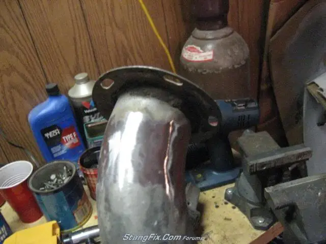

Has anyone ever replaced the fuel filler with a more modern version that the gas pump can lock on? Not that I don't enjoy hunching my 6'4" frame over and finding that special angle so that it doesn't leak on the rear bumper. Thanks.

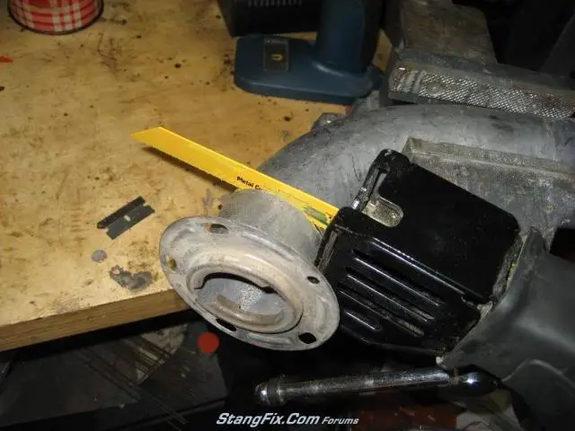

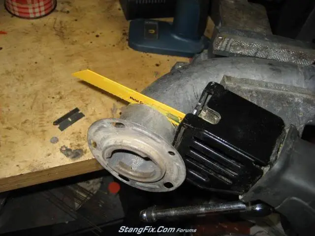

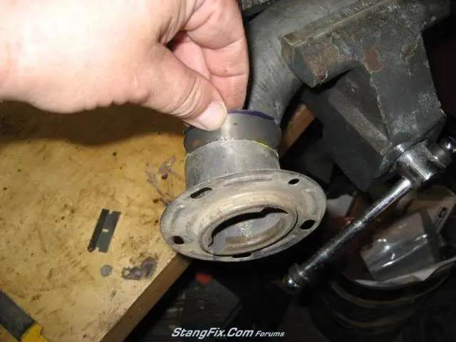

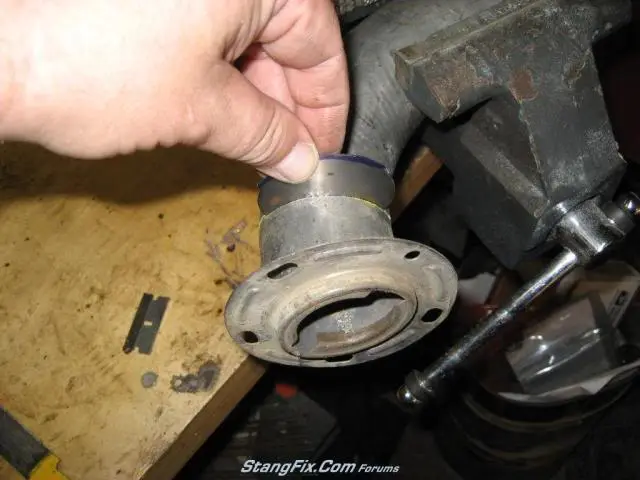

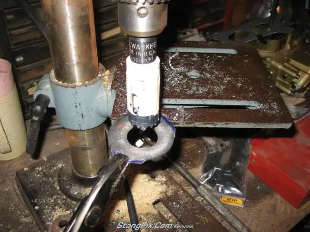

Not that I've seen yet but I have seen 2 other ways of remedying the splash back and pump as fast as you want issues.

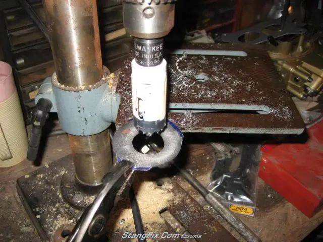

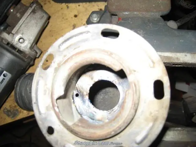

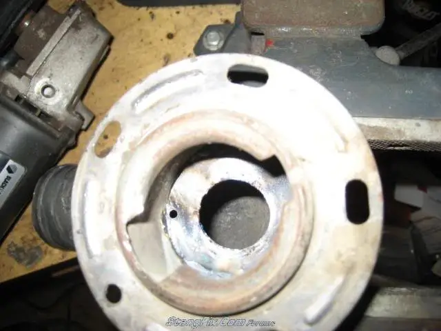

One was to cut a slit in the turndown and weld in a disc with a hole in the center the same size as the unleaded nozzles (smaller than the old leaded ones). This prevented splash back but don't remember if it allowed full speed fill.

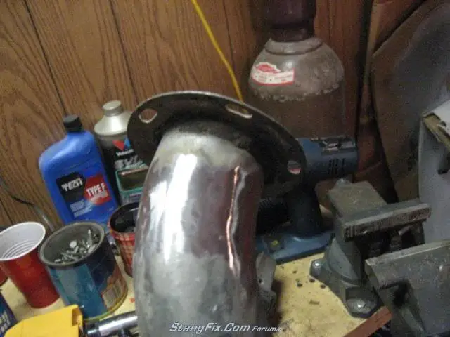

The other was to run a separate pressure relief line, one person welded a nipple to the tank near the filler hole and ran a vent hose up the side so the pressure could escape while the gas went in. I think the other version that
I'm thinking of trying is to cut a piece of clear hose just long enough to reach into the tank to work as a temp vent while I fill. Onced filled I can remove the hose and toss in the trunk.
You have to remember that with the smaller nozzles of the unleaded pump the speed and pressure have probably doubled so our unvented tanks can't let the air out of the tank as fast as the gas is coming in.
You could try the 2nd notch on the pump handle or even the lowest one. It will take a little longer but you won't have to keep stopping to burp it or have gas spit out.
I can link to these fixes on other forums if you need, I'll have to find them.

Here's the fuel filler mod with the disc welded in to stop splash back and fit the nozzle:
Vent line added to tank:
67 & 68 Mustang vented filler neck write up (no more spills) - Vintage Mustang Forums
