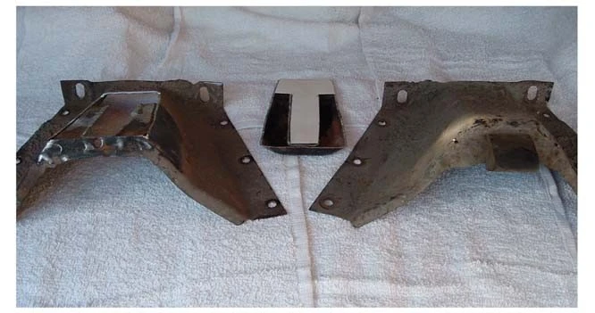

I seem to remember, and I thought it was either Dazecars or Opentracker, someone describing modifying the spring covers to shorten them up in order to move the bumpstops up on cars with the shelby/arning drop or negative wedge, but I can't find reference to it anywhere now. Does this ring a bell to anyone?
It was me. The reason for the mod is to make room for wheels with more backspacing and a lot of camber. The bottom photo shows how my tire was hitting the shock tower cover till I made them smaller. I welded a plate over the cut out part to make it strong again. The bump stop didn't get moved, I just made it shorter.

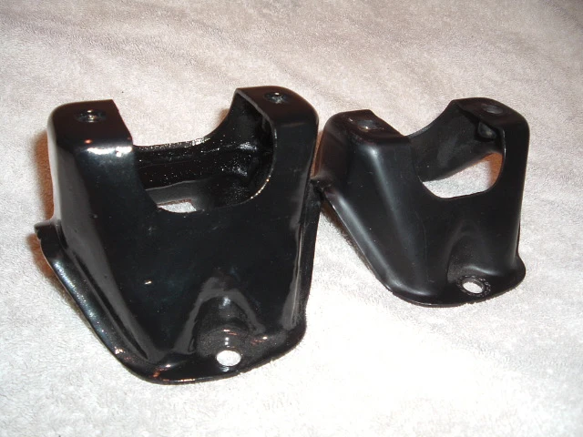

I also made a taller shock tower cap for the Koni's.
At least I'm not crazy, I thought it was something like that. I'm not going to run any crazy cambers, so I probably don't need that much clearance, but I've got a healthy size rust hole just above the bump stop, and I thought this might be a good mod to do. Taking out what you did would definitely tak care of my rust spot.
