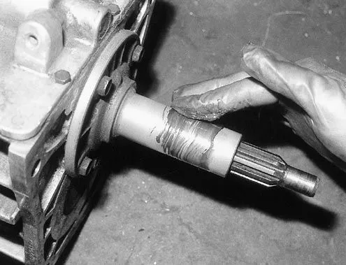

Sounds like what I mentioned earlier: The sleeve the release bearing rides on sounds dry or galled. From a T-5 (TR3650 similar):
This part has to be smooth and greased at assembly or it will gall.
