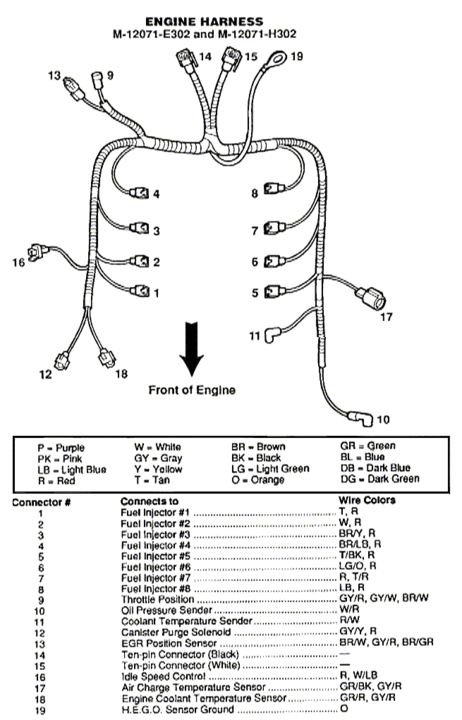

1) I'm seeing a lot of wires atop the engine. I have disconnected the wiring harness at the two sockets by the upper intake manifold, as well as all the ground straps. Which other wires do I need to remove? There's such a jumble of wires at the top, back of the engine that I don't know what goes where and what I need to remove before pulling the engine.

And you can thank tmoss for the diagrams
