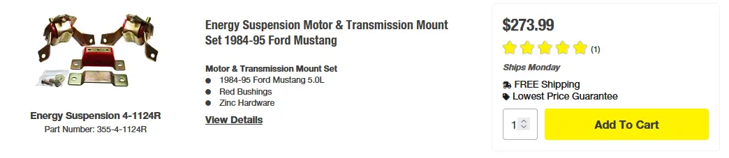

Has anyone checked the price on the poly mounts lately? Like everything else, they have gone up in price by quite a bit. The kit with all three from Energy got really pricey. I'll have to dig up an old catalog to see what they were going for a couple of years ago. I'm glad I bought mine when I did, I don't know if I would both for nearly $300 now!

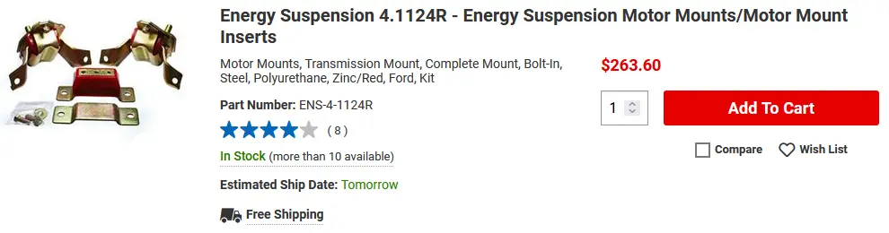

Mustang5L5: Good call checking Amazon. I always forget that they carry a lot of these parts now. It looks like their prices are more reasonable than the usual places - they must not have received the memo to raise them yet! (I still want to dig up my old receipt, I vaguely remember this kit being $160 back in the day.)​
