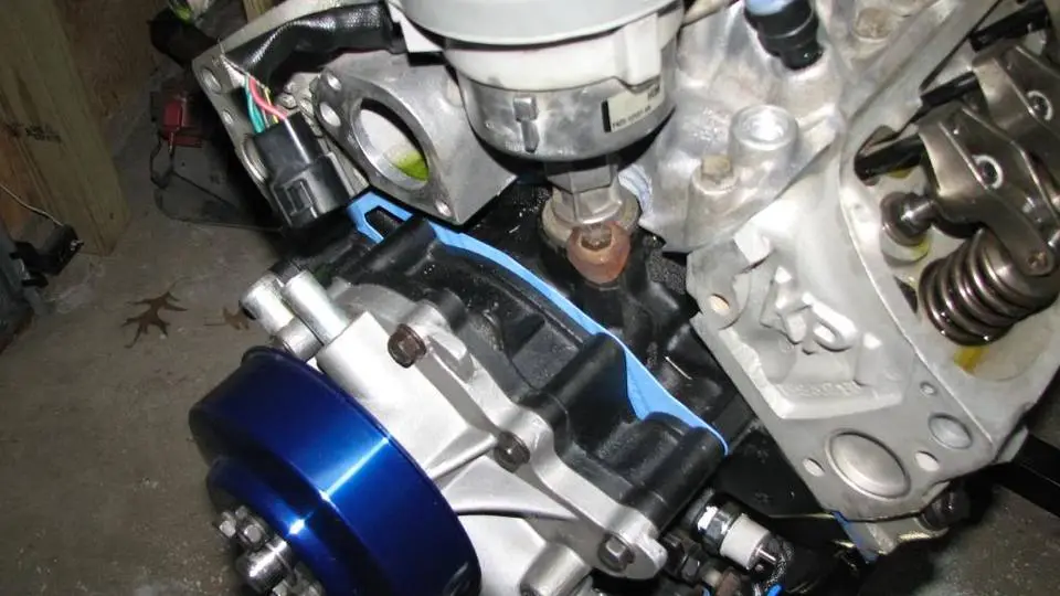

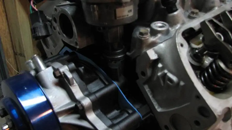

if you prime like i told you too and not hear the noice u know its not the pump.... like cbarr said id do that next... hit the oil pump driveshaft easy and continue to hit it harder unitl it sits the disty on correctly
its ok to do stuff the redneck way sometimes
That noise sounds like something binding up (obviously, huh? :D ). Since you noted that it only happens with the distributor is installed, I'd say that isolates it as being the culprit. I know the ARP hardened oil pump shafts can be a little on the long side and require removing a little material off the bottom of the distributor shaft, so possibly the Melling shafts share this problem, as well? The only thing I could really suggest is maybe shoot a PM or email to Rick 91GT and see if he's got any experience with the Melling shafts being too long. He builds engines for a living and may be able to offer some insight on the distributor not seating fully due to the oil pump driveshaft.
I am going to pull the pan tomorrow, I have three shafts to compare. The one that was on this motor to begin with on the regular melling pump (now a HV), and a spare one randomly in the box.
I do not understand what you guys mean about the clip on the shaft. the clip is on the shaft such that when we had the motor upside down, you can drop the shaft into the distributor hole and it stops it from falling through. then you line the shaft up in the oil pump. from the top, we cannot see the clip.

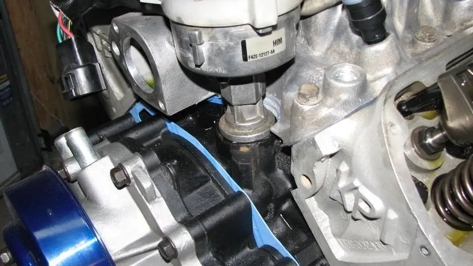

I am hoping this shaft is slightly longer, and that is causing the bind up sound between the distributor and camshaft. if the distributor is raised even 1/8" like it is, I'm hoping that the teeth are far enough off it's causing the noise. seems like a long shot and a lot higher up than the noise, though.

that could very possibly be where your noise is...sound travels a lot through that metal block.

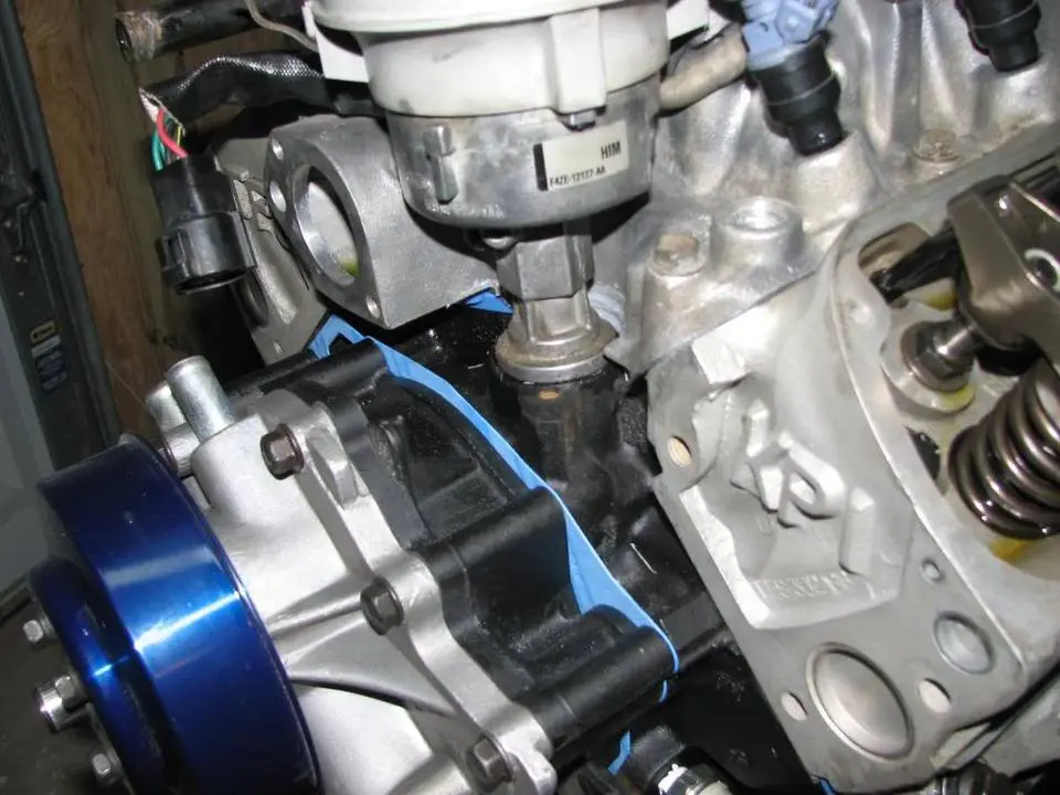

with that little clip..on my friends we got it to the point where it wouldn't fall through...but after we put the dizzy on top of it...it still sat too high. So he just tapped it down (kinda hard) and it pushed that clip down just enough to get out the way of the dizzy shaft.
this was an arp shaft with an msd dizzy...so it may be a bit diff for him than it is for you.

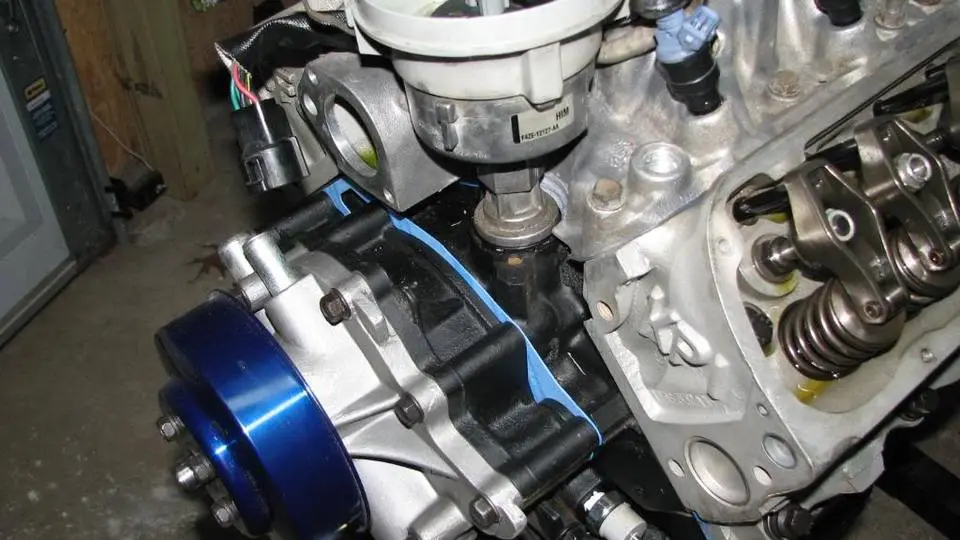

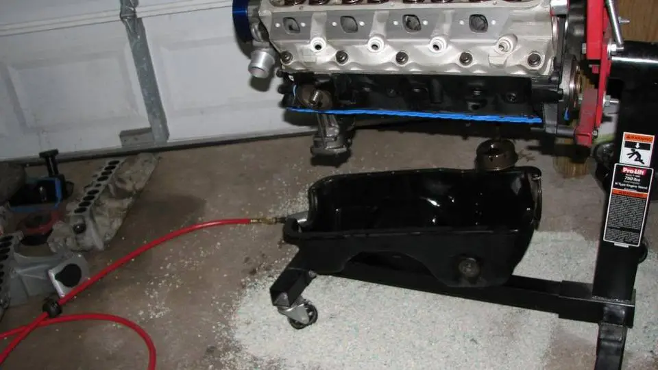

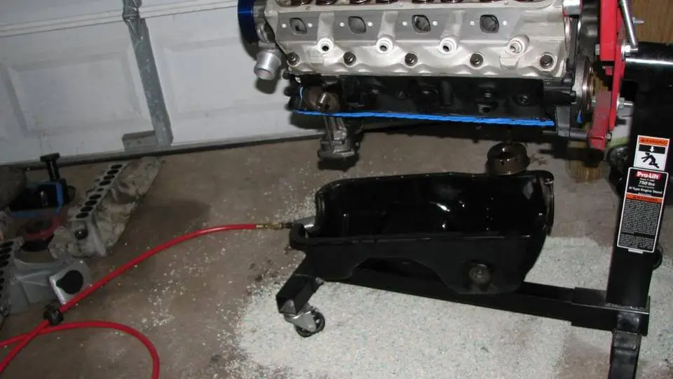

I could not go to the auto parts store as early as I got up to get a filter and the fl820s I had sitting around do not thread on, so I said lets skip trying to prime the pump and isolate the pump and just drop the pan and see this shaft.
since we have not had the noise since the very first distributor installation, I think that was because of the gap under the distributor and then trying to torque it down with the hold down maybe a binding noise between disty and cam gears. the noise has not happened once with all the changes I've made, but I've also not tried to force the disty in or tighten the hold down anything but with fingers...
so I decided to skip investigating the noise since I can't get it to happen anymore and investigate the shaft issue with the disty sitting so high...

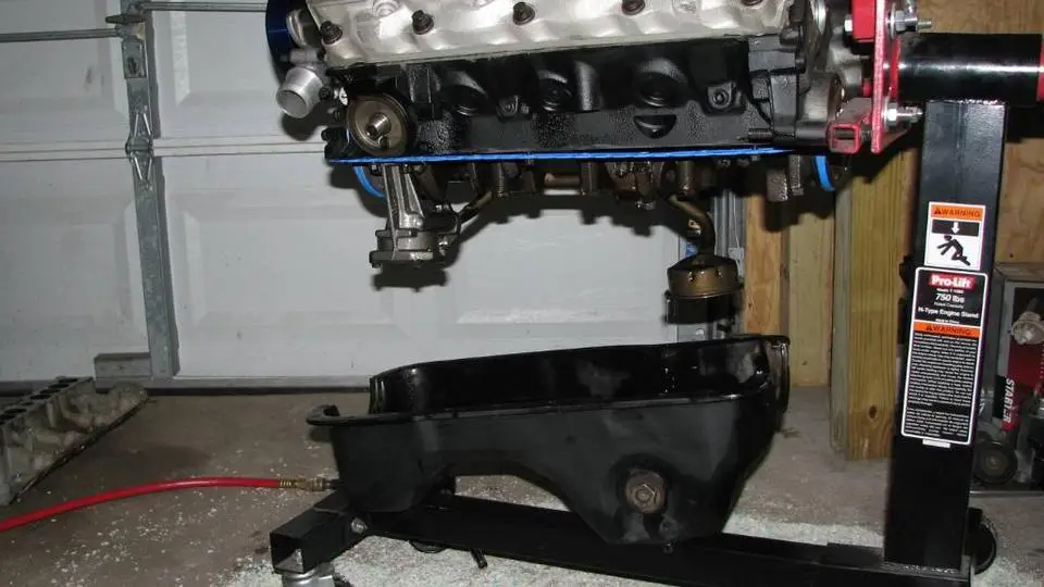

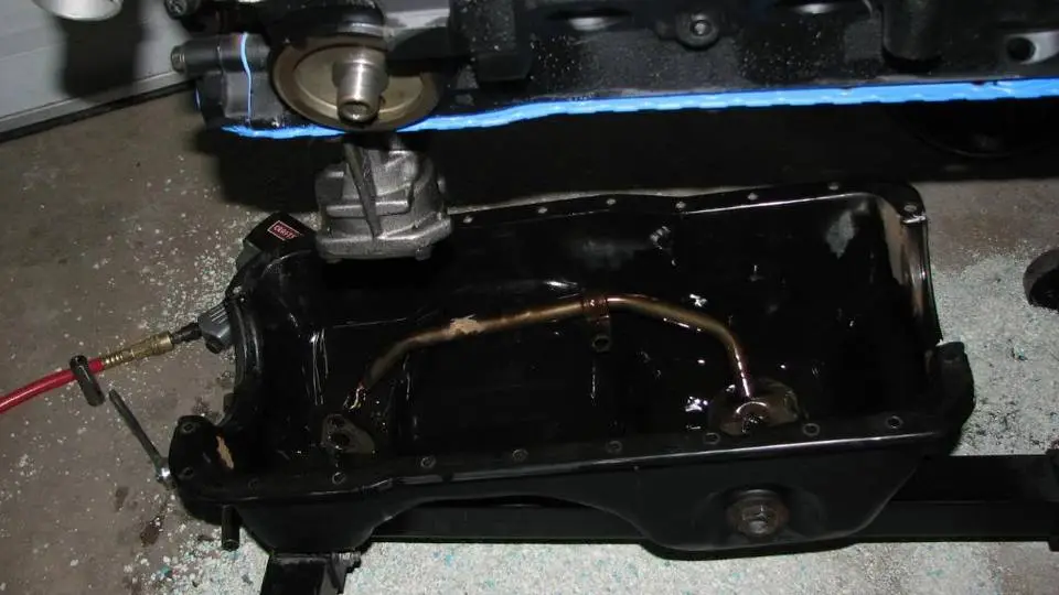

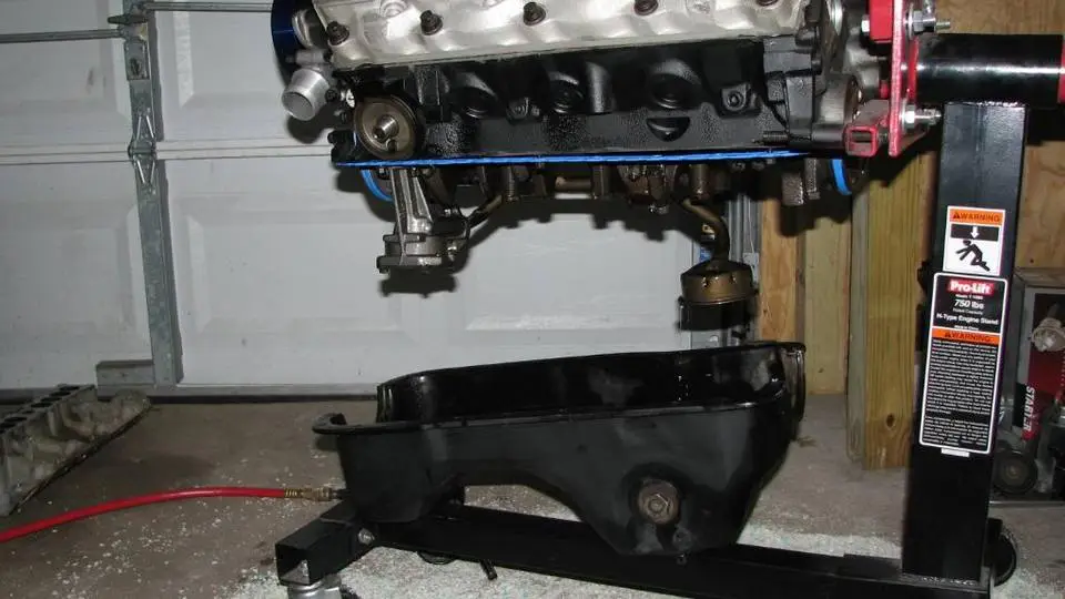

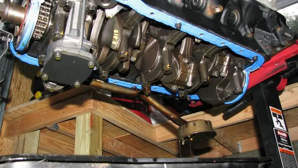

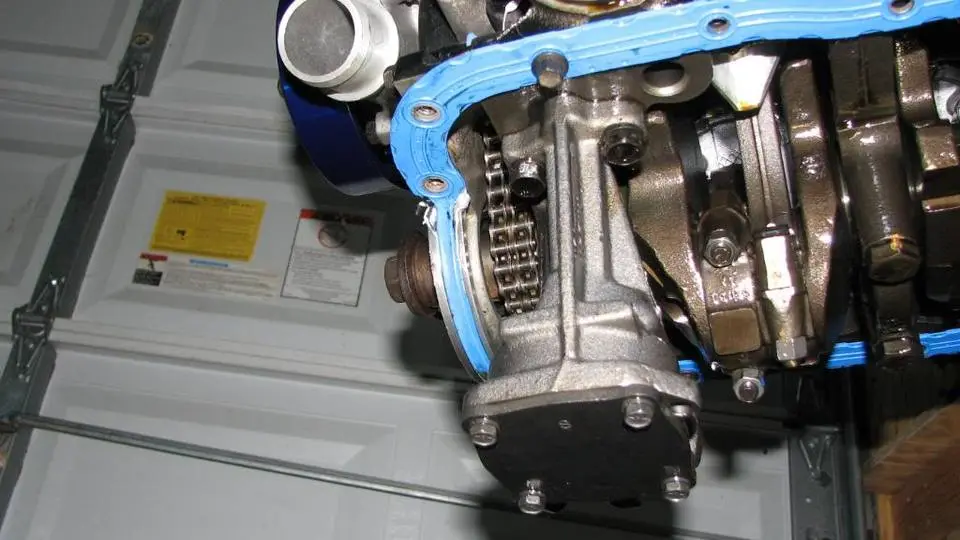

let me know if anyone sees anything they don't like...off comes the pan

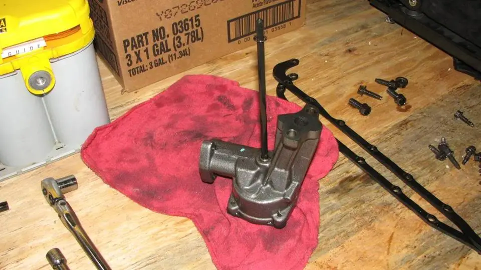

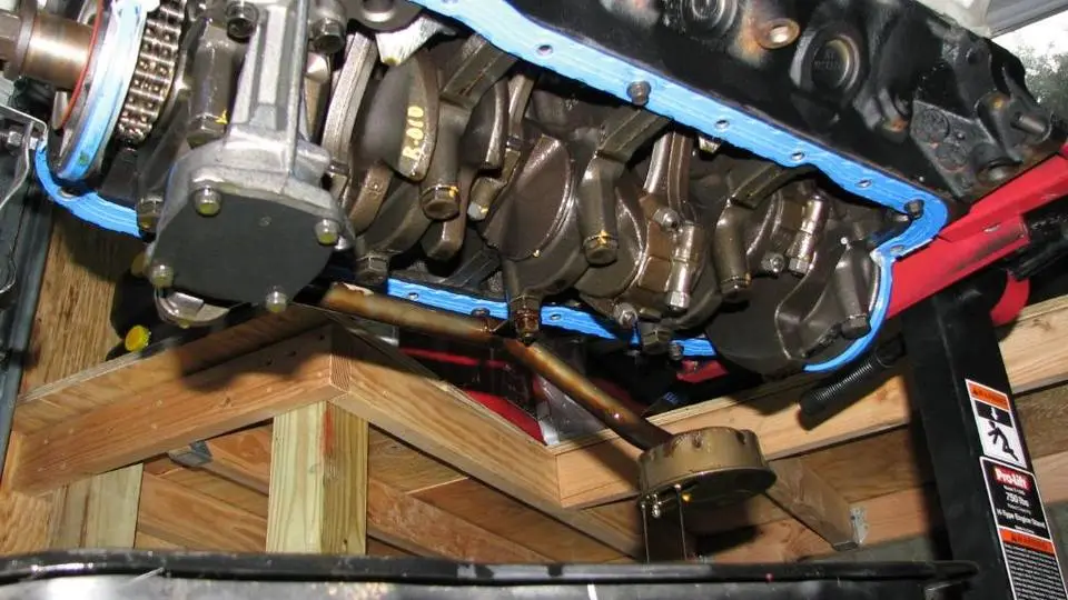

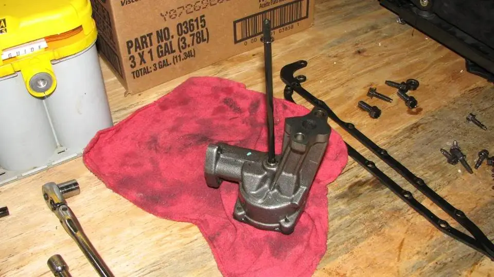

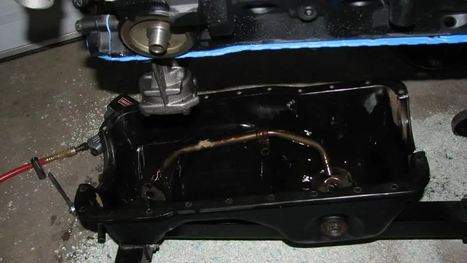

pickup tube

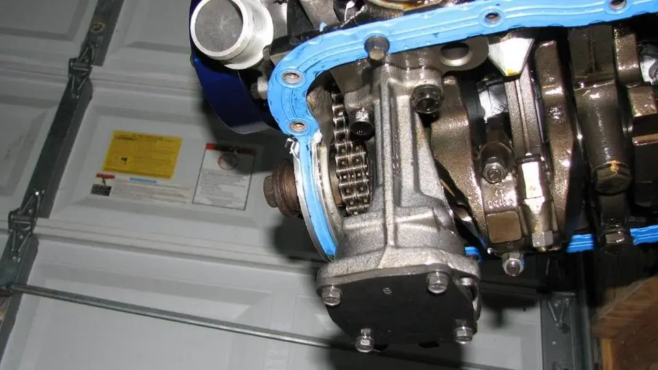

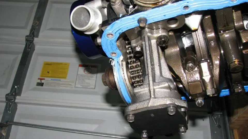

pump and shaft are out

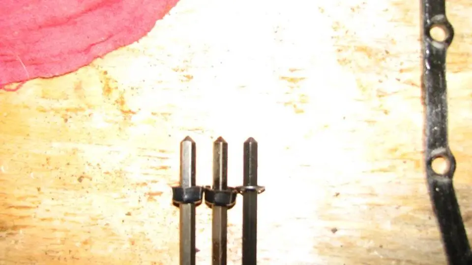

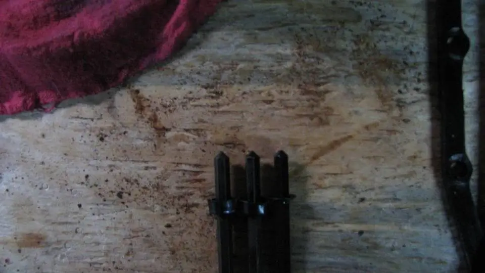

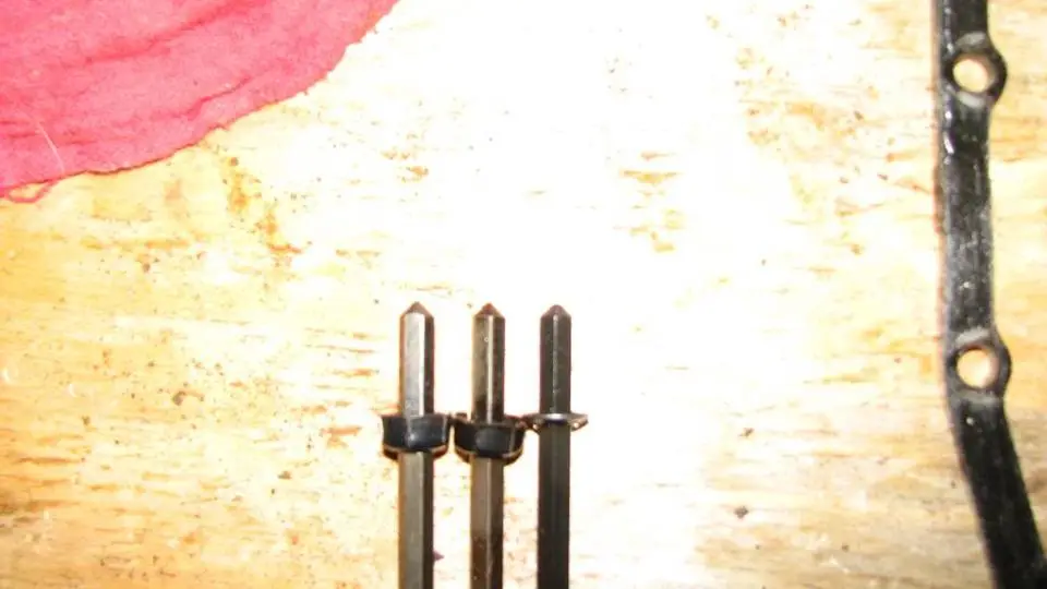

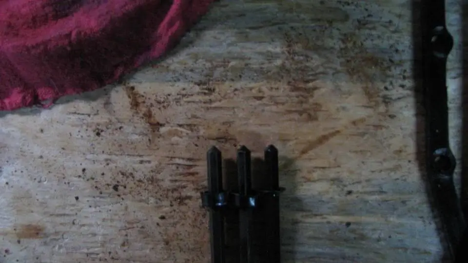

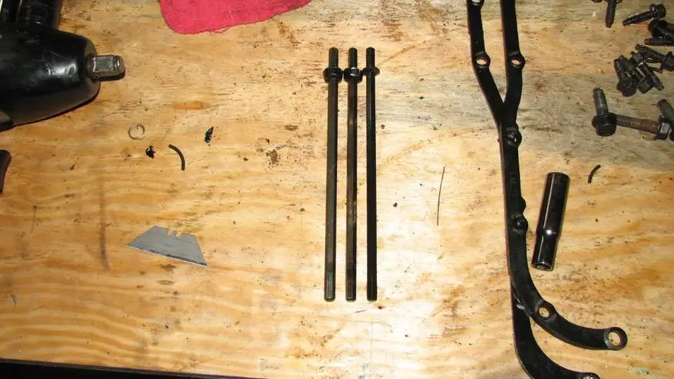

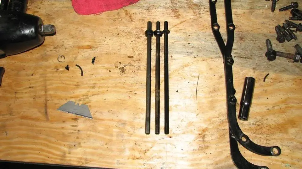

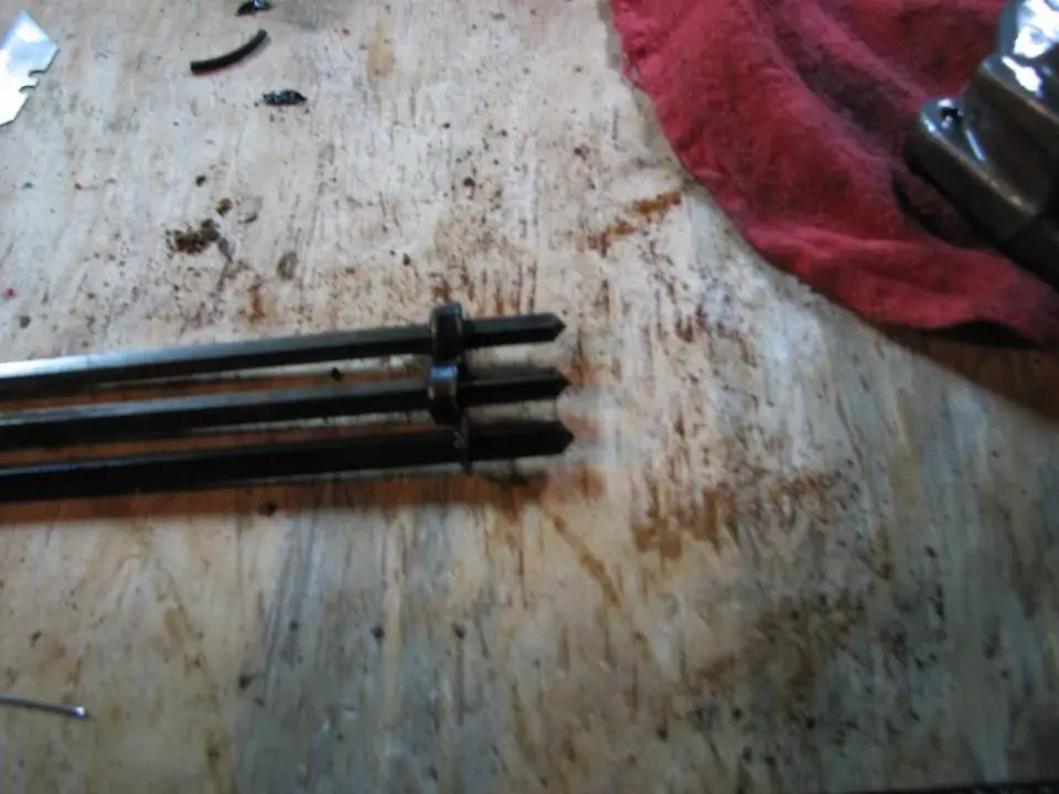

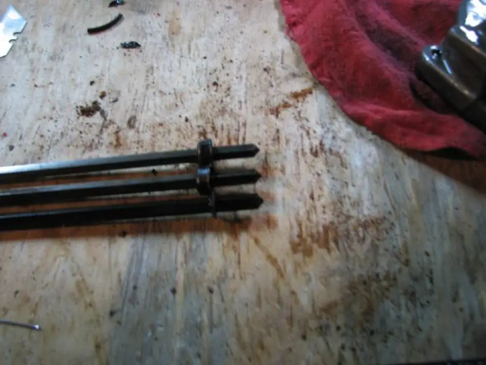

comparison of oil pump shafts we have
the far left is a spare one we had
the middle is the one that was on this shortblock when we started this buildup with the regular melling (non high volume) pump
the one on the right is the one that came in the melling high volume pump. I did not move the clips on any.
I squared the bottoms with a straight edge and spaced them out evenly. if anything, the HV one is less than 1/16" longer.

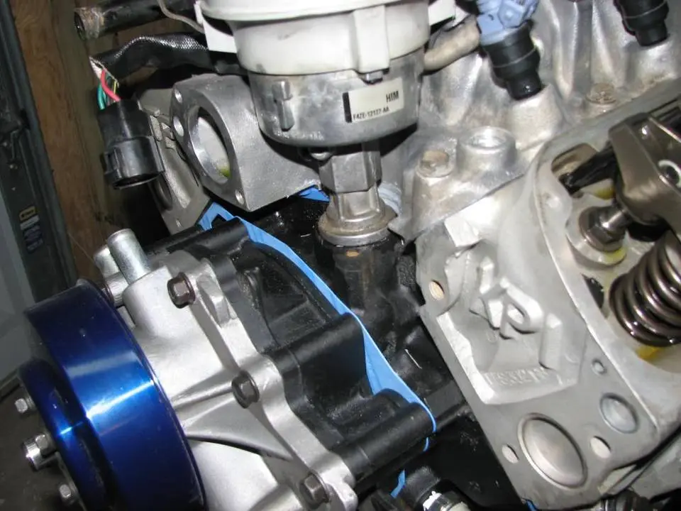

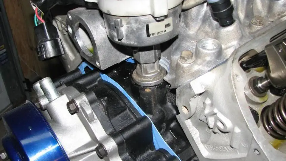

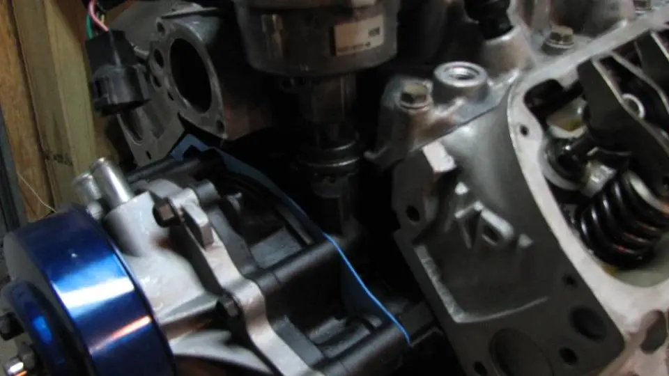

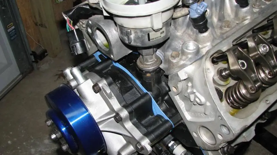

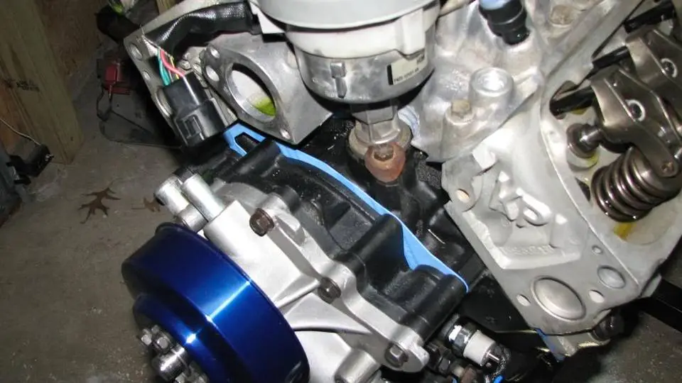

and when I install the distributor when the oil pump and shaft are not in
it still is hard to put in, I think it's because the new lower is so much bigger, but once in the bore it slides in decently easy. I did not clock it, just put it in however it was sitting. when I rotate the motor now, no noise dead quiet. yay

success! Thank god for Bulk Uploader on Photobucket!

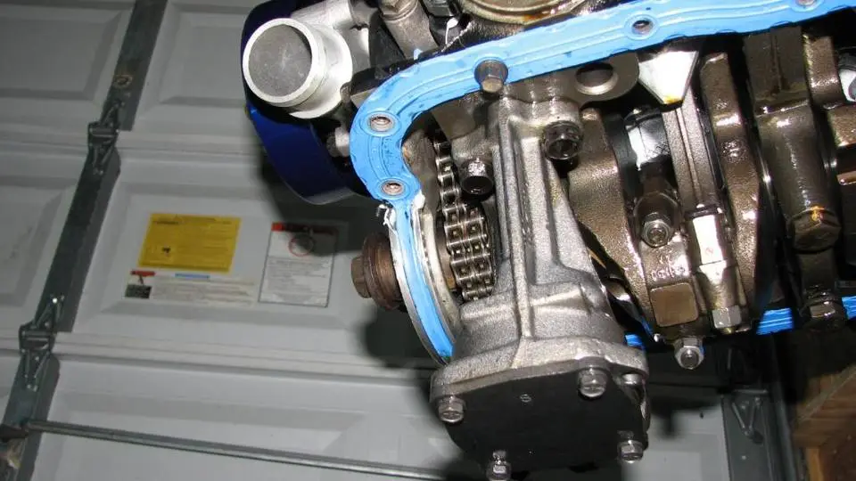

I reinstalled the oil pump drive shaft and oil pump from the bottom with the distributor already in. Fearing it would be pushed back up, I did not install the distributor hold down.
As soon as I started to torque the bolts on the oil pump, the distributor started walking back up. Grr.....
So I pulled it all back out and did the same with the shaft that was on the shortblock before with the other Melling oil pump, and...
no noise, no binding, etc.
Thanks for all the help everyone.
