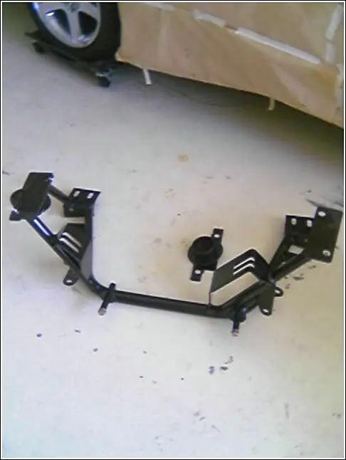

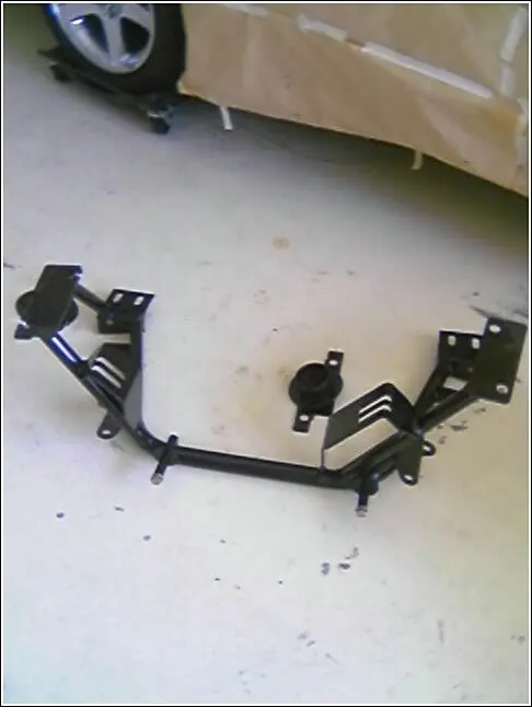

The QA1 piece is ok. I had it and felt it might be a bit too thin. I've seen the TeamZ up close and that's a fantastic unit. I'd go either TeamZ or MM myself if I had to do it again.

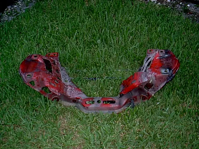

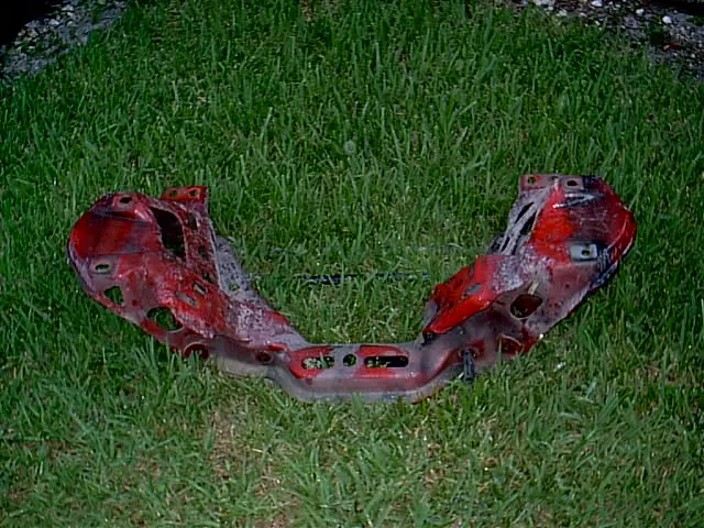

Here is my stock K.

I'll weigh mine today if I have to, its sitting in the garage. Its usually common to include the A arms when weighing the K member b/c pretty much all aftermarket ones wont accept the stock A arms, some do....but most dont.
