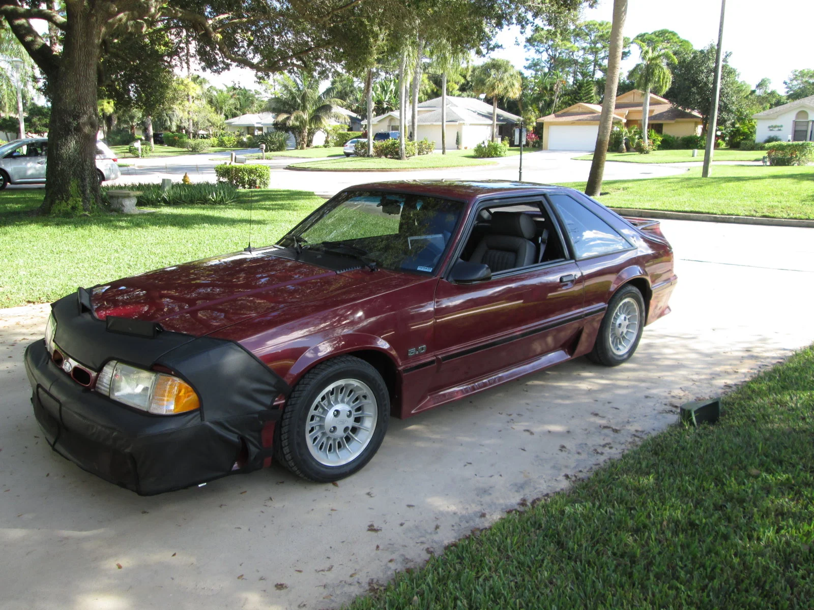

Ok StangNet... It's been a while since I've been very active on this forum, however, I feel that this is the most reasonable place to pose this question. I purchased a gem of a Mustang last winter and at the same time I found some great deals on some parts. First, this car is a 1988 Mustang GT with 43k original miles, all matching numbers and in pristine condition.
Mine looks a lot like yours, 58k miles, original owner, original paint & wheels (now spares).

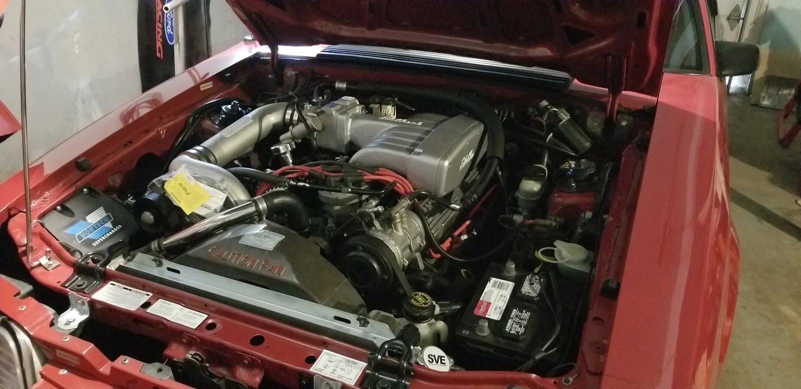

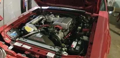

Looks very nice! Well I went ahead and pulled the trigger. I am almost done with the build, just need a new catback as this one turned out to be ProFlo and the pipes to the mufflers are bent in all crazy angles and wont mate up to the shorty Hpipe. I could cut them off and put new pipes to the mufflers but when I popped them off the factory Hpipe they had so much rust inside they had welded themselves together. Better off getting a new setup. I also pulled the trigger on the blower, so everything is done, MAF conversion, ran the extra wires for the VSS and FPM circuits. Another few weeks and it will be ready to fire up. Got a startup tune for the Gen 4 PMS, just need a MAP sensor for the system and should be ready to go. This has been quite a build, so much custom work. They say bolt ons, not quite.
Thanks for the posts friends, forgot how much work this all was, had some great times and a lot of bad words in this build.
