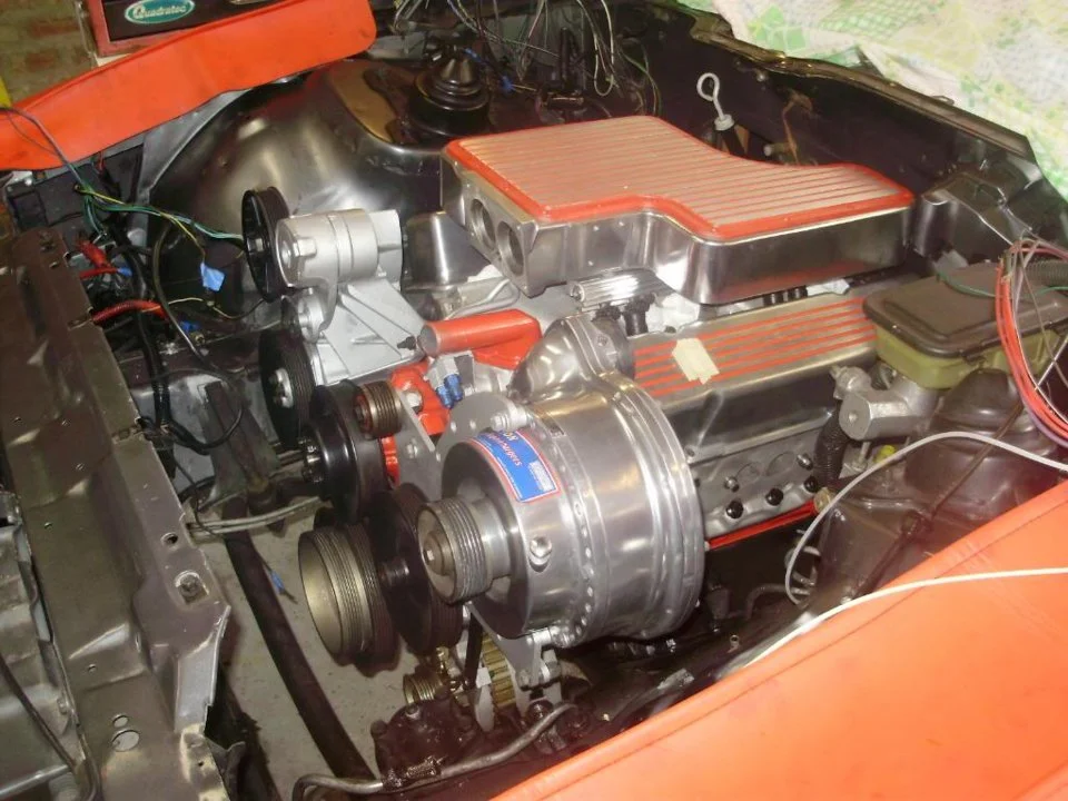

For era then go old school paxton...SN series...there self contained no need to drill and tap your oil pan....I posted a picture i had on my computer i put one on my wifes 91 z28 she wanted one from the era also...this just gives you an idea....
