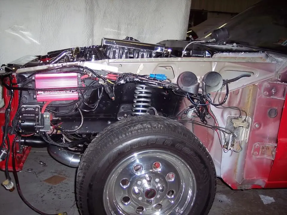

Here's how I did mine over the winter...
used to be here...on the right

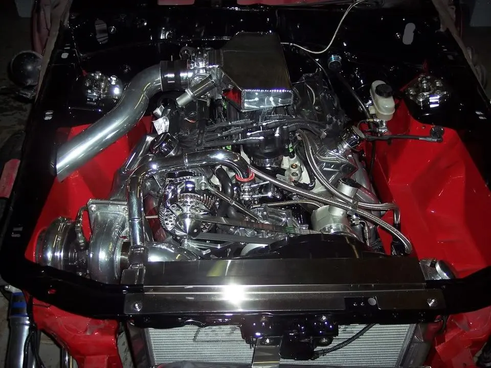

then moved..

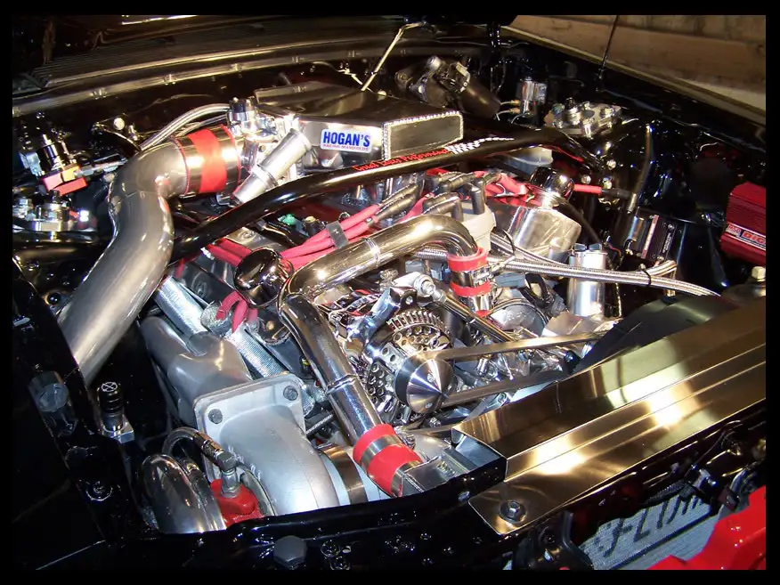

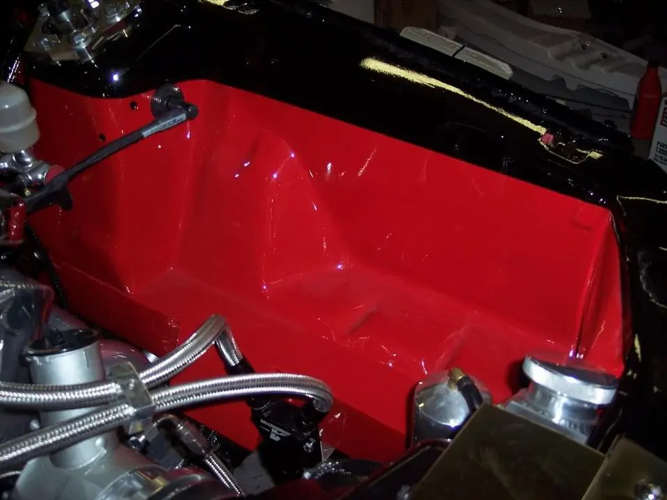

Now all you see is where it plugs in..
