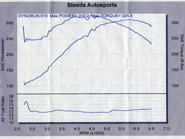

Alright, cool. A dyno sheet will help me to put things together in my mind. I'm looking to do a similar setup to you and I want the most power n/a I can get, but I don't want a setup that doesn't peak in power till past 6500rpms, cause I don't feel like upgrading the lower part of my motor to rev it that high. I think the most I'm gonna rev this thing to is 6500rpms.
You'll see on the dyno...the hp peaks at about 5700 and gradually starts to drop off at 6...the torque starts to peak at about 4k and starts to drop off about 5k. Still lost a little bit down low on torque but I have more down low than I had before...once it hits 3k it takes off!

That sounds perfect. :cheers:
Here's the Dyno Sheet from the install.

I shift about 6...my power curve starts to drop off just after that so I'm really not making any more power. The car definitely has no problem hitting 6k at all
Yea, thats where I shift mine...sometimes Ill pull out 3rd to 6200...then when I hit 4th, the torque darn near pulls me off the road lol. 4th is about the best pulling gear now. BTW I took mine to 6400 the other day in 4th (125MPH) and you sould feel it loosing some power then....not alot but it was there. By the look of the dyno, 6K is the best. Oh and like the above poster asked, what injectors? i assume they are the stock 19s right?

If he's running the stock 19's, then in that lies the problem as to why he's not making more power and is running lean.
I'm still running the 19's...Steeda said the 19's were flowing more than enough and there was no reason at all to upgrade to 24's. I asked if we needed to upgrade and they said they would let me know when they got it on the dyno.
Thats interesting. Most of the guys I know making over 300rwhp are running either 24lb/hr or 30lb/hr injectors. Its good to see you're doing it with only the stock 19's.
