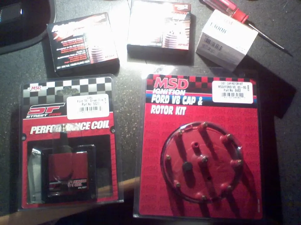

Ok Cobra has been in storage for awhile and i got new MSD Ignition Cap and Rotor Kit Part Number 8482 also got Coil Part No 5527 got these from Advance Autos they said they where right but they tend to be wrong some times:shrug: . I have searched everywhere even on MSD Ignition Still nothing for right part. Can some one tell me if i got the right stuff it goes for Dyno tune in 2 weeks and a few other goodies. plz help i pray i put this in the right area if not plz move. Thanks again guys.
Brien
P.S. also got Autolite XP Iridium Plugs do i need to Gap them or what.
Yes, that cap and rotor kit looks correct. It is exactly what I installed on my old car before I sold it.
The MSD coil in the pic is definately the correct coil, can't go wrong there!
And yes, you'll need to check the gap on new plugs ALWAYS! The stock gap setting is 0.052".
If those are laser tip style plugs, then they aren't designed to be gapped. Gap doesn't make a whole lot of difference. As long as you aren't blowing out the spark, then it doesn't matter a whole lot. Best guess for start is about .045".
