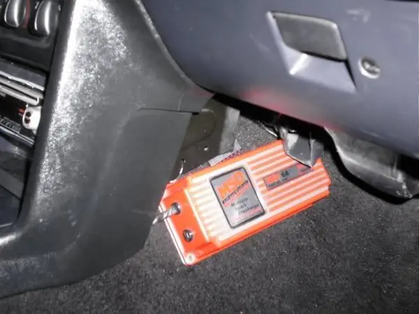

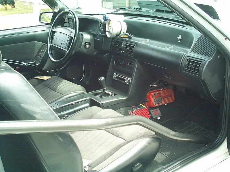

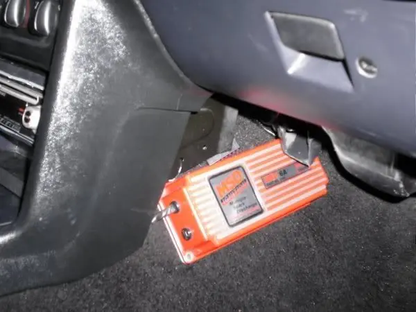

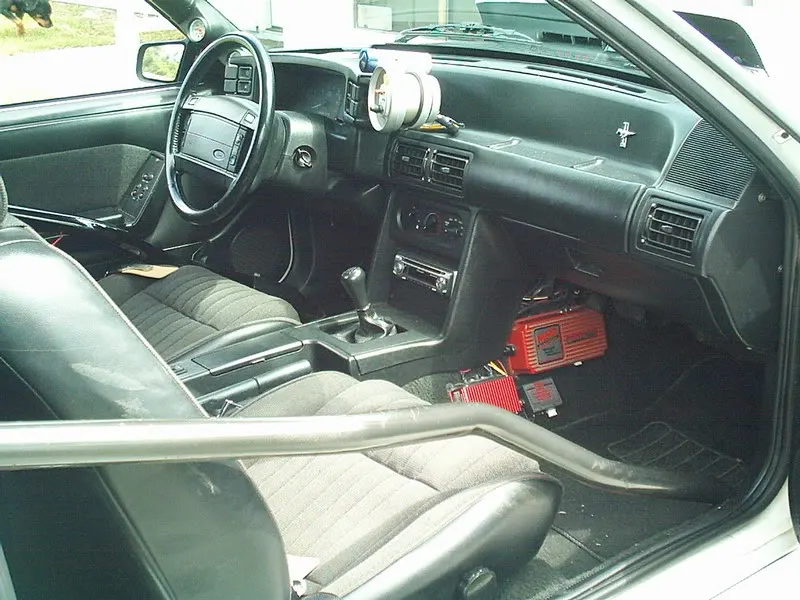

i put mine in glove box with key on electric fan to cool it, had it on pass side of tranny tunnel, but got hot enough to burn my daughters leg, not bad but red. just dont do that lol.
