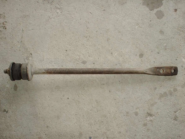

You really have to invission a strut rod and how it relates to the bushing. Or, even how the end links of a sway bar use the bushing. Like the OP said, looks like a muffin, two ends are sandwiched beteen the mounting hole. Its actually an interesting design for a traction bar.
Something like this:
http://http://www.2carpros.com/first_things/images/strut_rod_bushing.jpg

I think he's talking about the shelby underride traction bars with the eye bushings on both ends. Except one end, instead of an eyelet bushing, has a strut rod type sandwiched bushing.
Crude paint pic

latamud, that's exactly what I'm talking about. I might just put in some solid spacers or a stack of washers. It might make for a a little more noise but not as noisy as it is now with the end banging against the mount.

You could try cutting down what's left of your bushings into rubber washers to go between the steel washers and brackets. It might be less abusive on your suspension. If all you do is put washers in there then you are making it a solid mount traction bar. Imagine a strut rod, but where the bushings go you add steel washers. Now imaging what motion the strut rod goes through as the suspension travels. The bushing has some give to allow the rod to move with the suspension. Without some give the rod will snap or the front frame mount will tear away from the core support.
Imagine how much your rear end moves up and down, side to side and even front to back. You will need some flexibility in that front mounting of your traction bar. Just imagine what will happen to the traction bar when you jack up the car at the frame and let the rear sag down. That's a lot of weight putting pressure on the front mount if you only put big washers in there.
